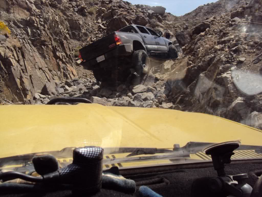

    58k on the ticker and four sets of broken rear ring and pinion gears..last set was the pinion gear that broke about a month ago, and many other various broken parts to include a cracked frame and a transmission cross member with several major cracks. although i cant complain just because i go where no IFS taco should go in the first place, it's still a bummer when one go's. i'm hard on my junk:D plus i tow with it on occasion:p
    but never an issue with the rear locker itself. that thing is nearly indestructible, as long as you engage it under 5mph!..i have a 3rd torn a part so i'll take some pics of the actual locker sometime tonight..
    here are some pics and a video to show the kinds of abuse that the rear locker can with stand without breaking.
    The Hammers..one of the many trails as used by the KOH race:
    At Calico..i never made it up..my long wheel base prevented me from doing so, buy at least i tried..more fun then driving on hard packed sand all day
    http://www.youtube.com/watch?v=iS1YhEgFSKk&list=UUMuWNhP75QxUWGf14kU7_tA&index=13&feature=plcp
