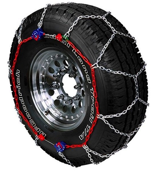

    I put chains on the front with stock 265/70/16 Rugged Fails. They were the easy on/off type. The chain was about half the size of a normal chain, a compromise between cables and truck chains. Got me out of a snow covered ditch.
