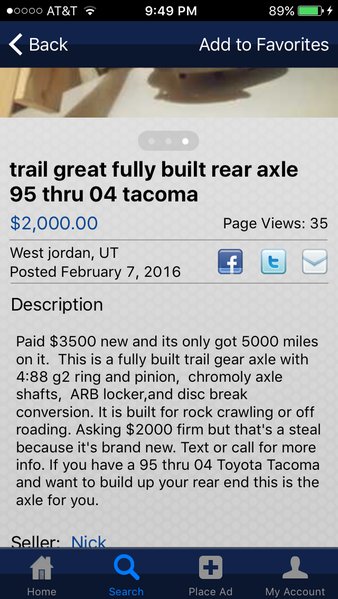

    That thing is badass but too far for me haha. I just want a locker is all.
