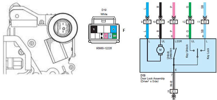

    The door locking component in the latch assembly does not affect the door latching component. You can manually keep the door by the handle and then close the door. The locking mechanism simply disengage the ability to open the door.

    That I know. It's the "fooling" the ECU to lock (mechanical part) before closing the door part. Maybe the holding the handle part was/is missing for the OP first post.
