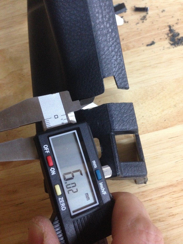

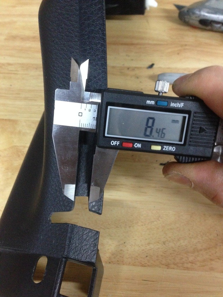

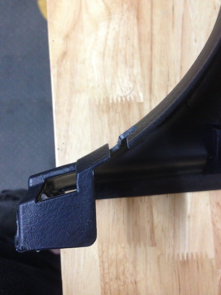

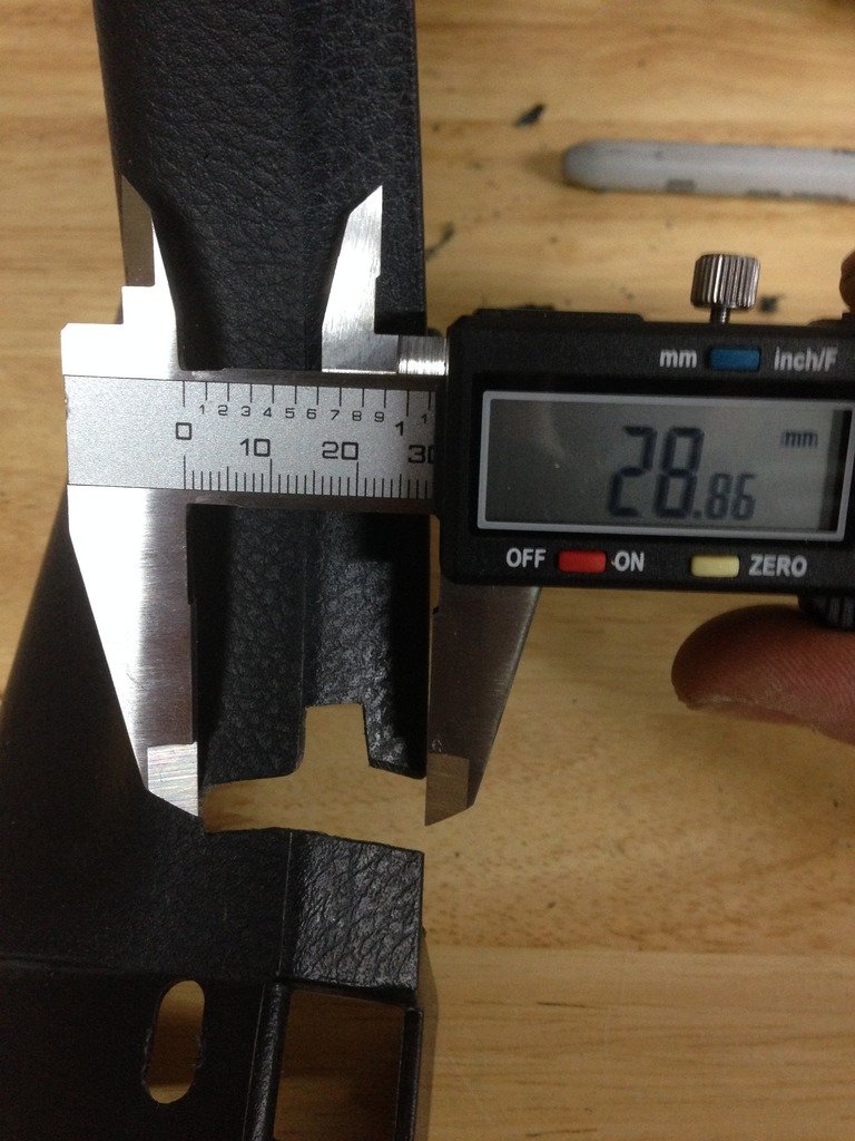

    Hey Guys, I know alot of you can't believe your $40,000+ Tacoma didn't come with a locking fuel door!
    With a few wrecker parts I was able to make a reliable solution to avoid needing a key for a locking gas cap.
    Disclaimer: this does require cutting your interior b-pillar trim and is not reversable without buying a new one.
    Parts You'll Need:
    2008-2011 Yaris Hatchback Release Handle
    https://www.oempartworld.com/oem-parts/toyota-release-handle-7730652060
    2008-2011 Yaris Hatchback Release Cable
    https://www.oempartworld.com/oem-parts/toyota-release-cable-7703547050
    1990-93 Celica Fuel Door Lock Retainer, Striker, or Latch Retainer
    1988-91 Camry Fuel Door Hinge Spring
    Dremel or Hacksaw
    Exacto Knife or Utility Knife
    Epoxy
    Silicone
    Rivet and Riveter
    Touch up paint
    A Screw

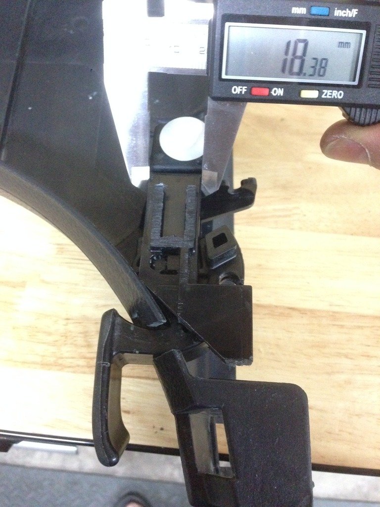

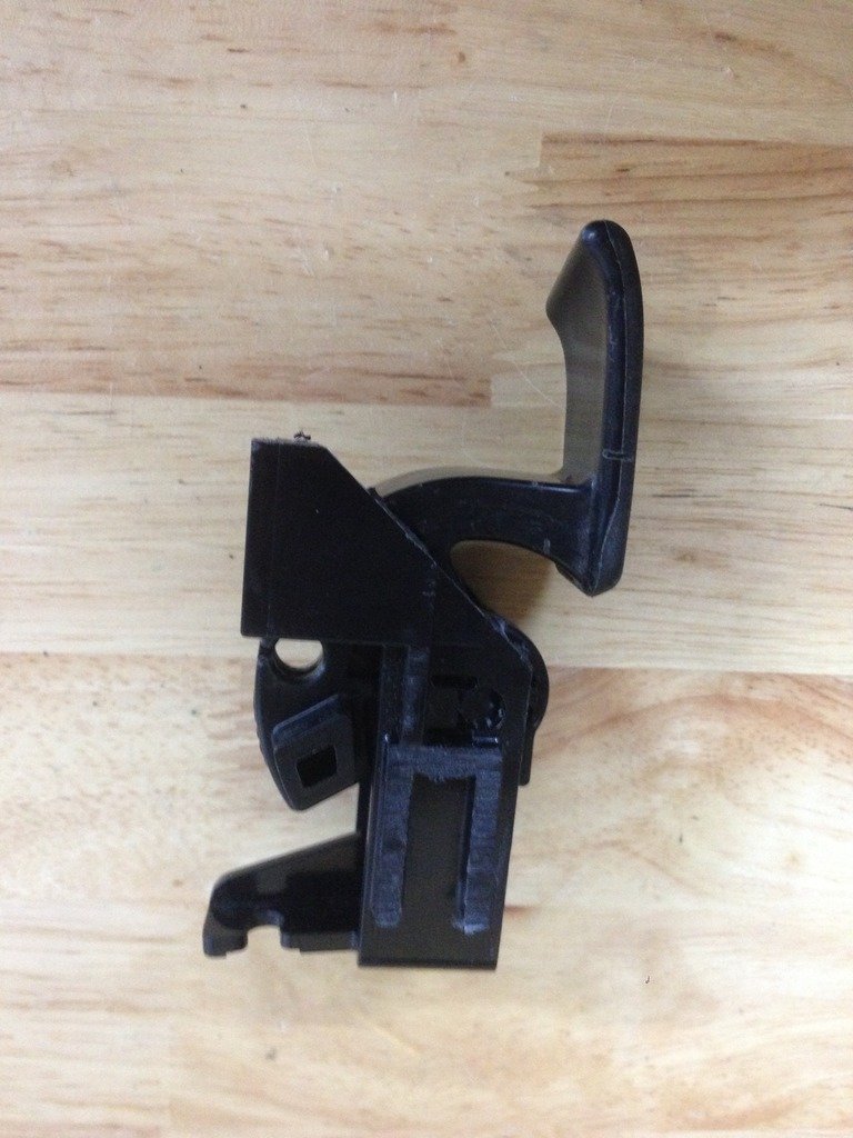

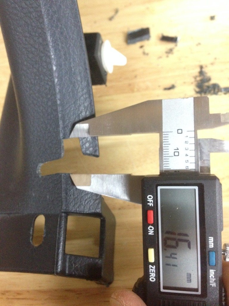

    Remove the plastic around the fuel cap. 4 screws and you will need to remove your cap to pull it out of there. It seals around your filler tube but pulls right out. Start by cutting out the existing hole for the fuel door clip to accept the new release cable. I had to grade the plastic a bit because it was too thick to turn the release cable to lock it in place with the tabs. I used an exacto knife to notch each side of this hole.
    Should fit in tight when you turn it to lock it in place.

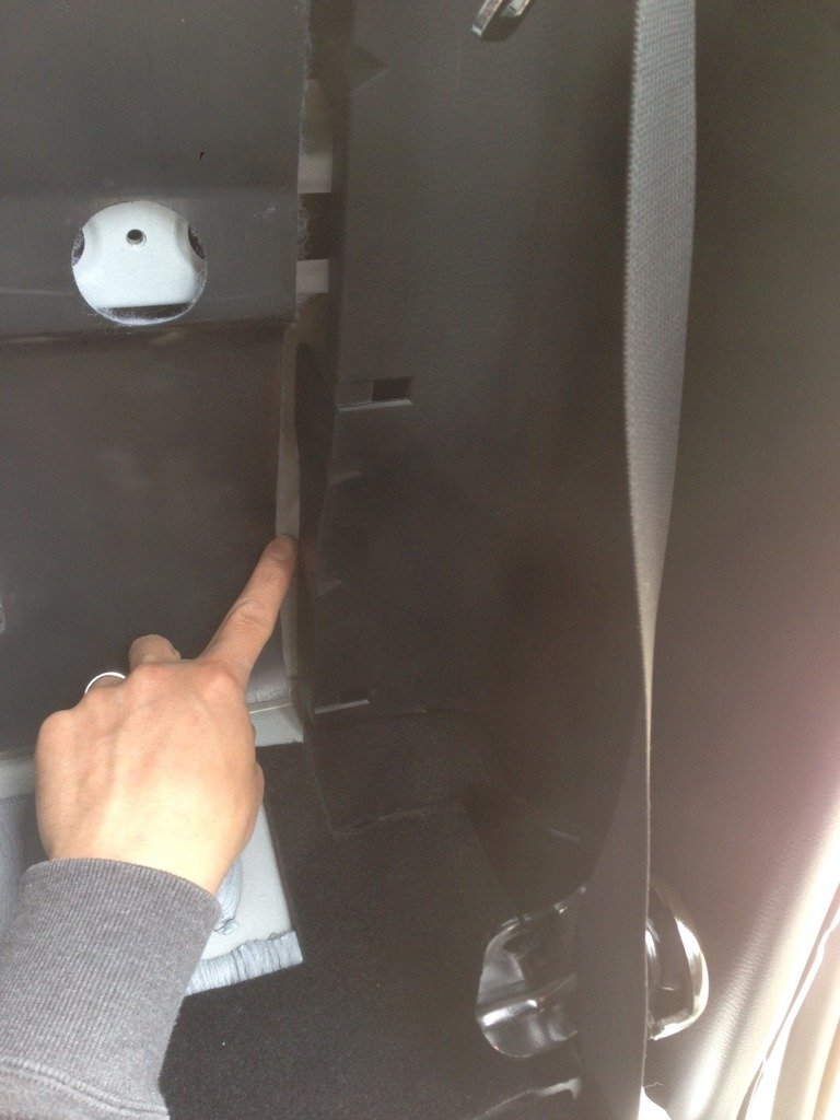

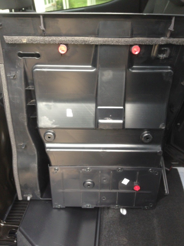

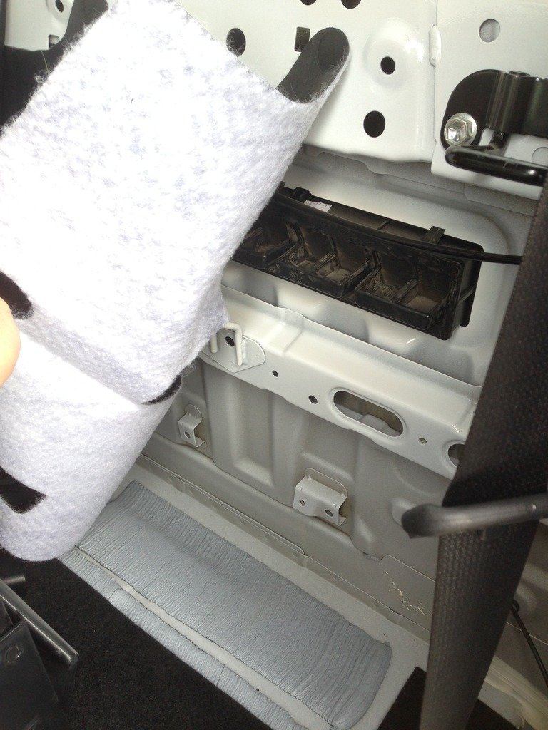

    You will need to remove the interior panels from the b-pillar to the back of the cab. The rear seat will need to come out to do so. This is where I ran the cable through to the cab. That location clears the plastics perfectly and I just siliconed the grommet to keep it sealed with the cable going through. Silicone is one of the last steps when you have your cable in the right position.

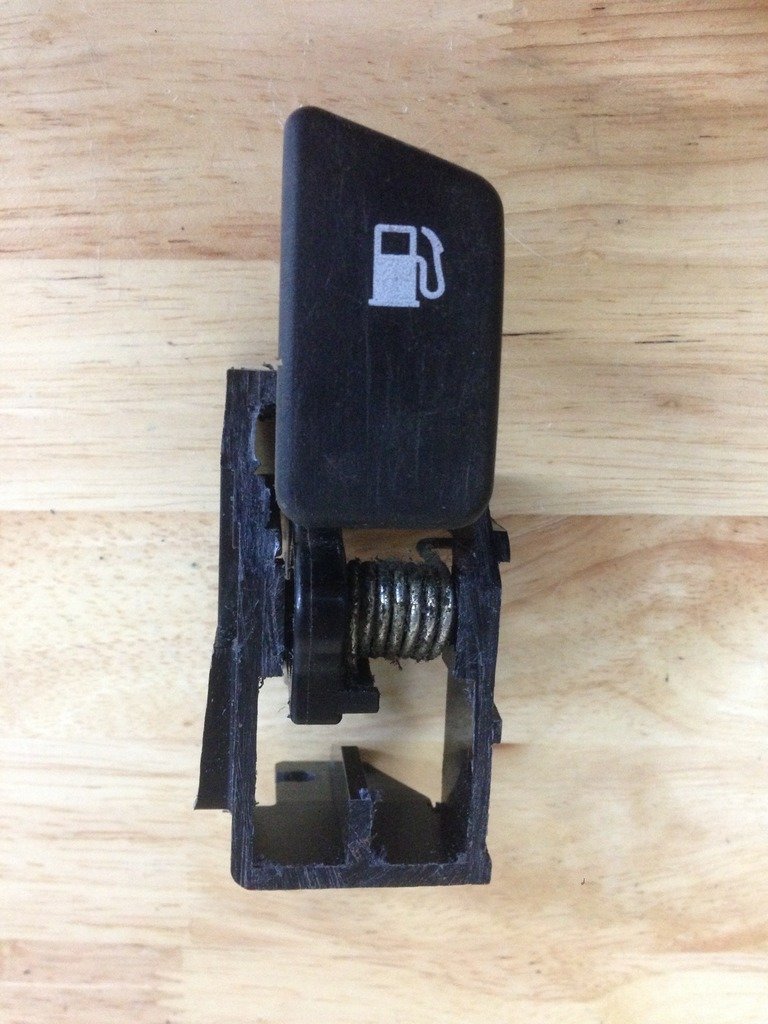

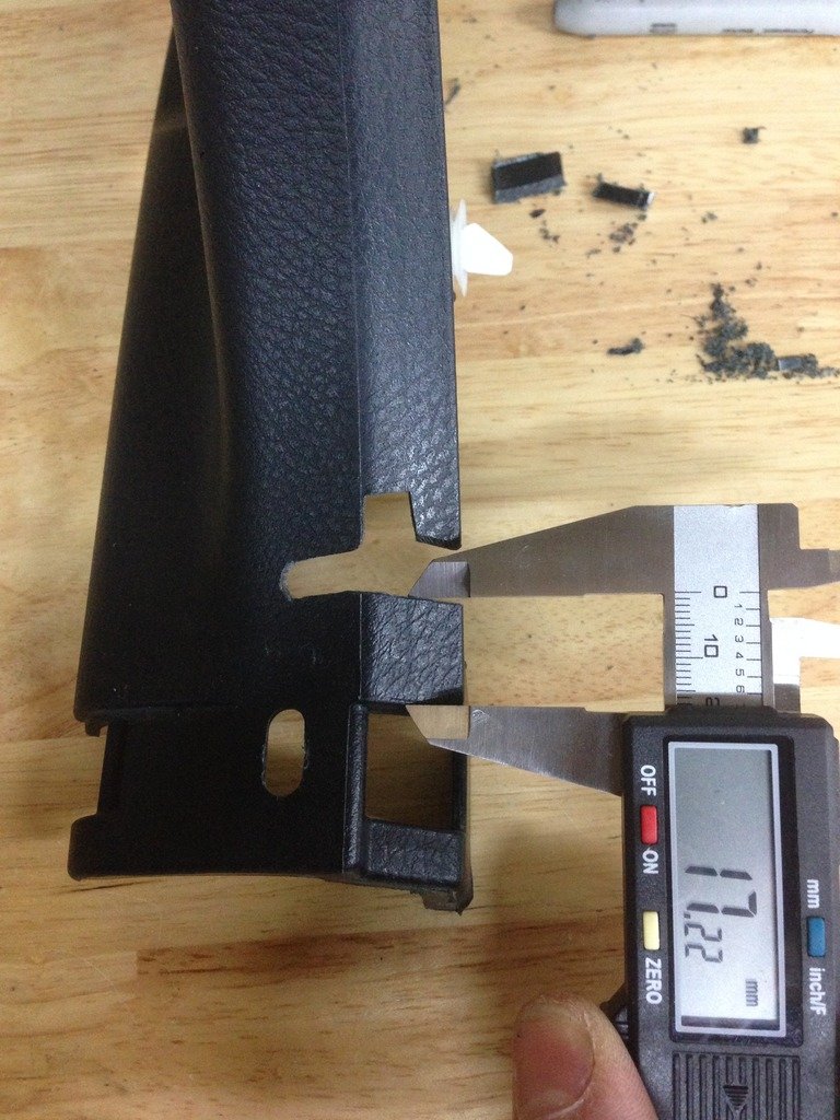

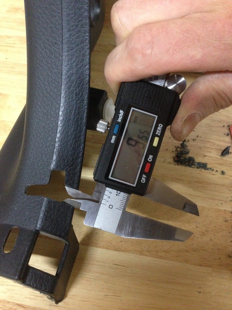

    The trimming took the longest but I was also figuring it out from scratch. I used a hacksaw blade for accuracy and lack of a better option. I used a small round file to clean up the plastic to give it a good finish although this is all covered in the end.

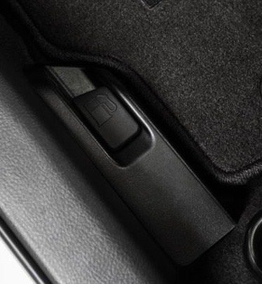

    2015-toyota-yaris-gas-cap-release_9979_0_d91a7d38e018c34f1c1c51684fddc3fd257d5115.jpg
    Not my photo but this i what it looked like before I hacked it up.
    It's a good idea to mask off the handle so you dont end up cutting it like I did.

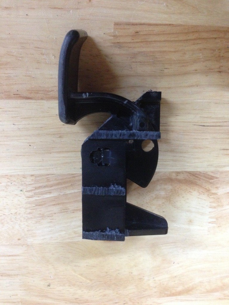

    You will want to get the release handle as close to the driver seat as you can. It will hit the door when its closed if it's not far enough over.
    Once your release hangle is where you want it, epoxy it in place. Make sure you are going to be clear of your side airbag sensor with a test fit of the panel before you epoxy it in place.
    The cable has to be looped once in the pillar by the seat belt mechanism to pick up the slack because its slightly long for this application. Some of you might be inclined to shorten the cable with your mad skills but I'm too far from a wrecker to risk breaking my only cable.
    The lock retainer on the fuel door has to be modified so that the alignment pin goes in the original 10mm bolt hole on the fuel door and I drilled a new hole and riveted the catch in place.
    I doesn’t take much to make the spring clip work but I did end up cutting the end off and securing it with a screw and rubber spacer so it wouldn’t fall out on rough roads.
    There's alot of photos I didn't take while doing this so if there's any clarification needed just ask. I might be able to take some more pictures for you.

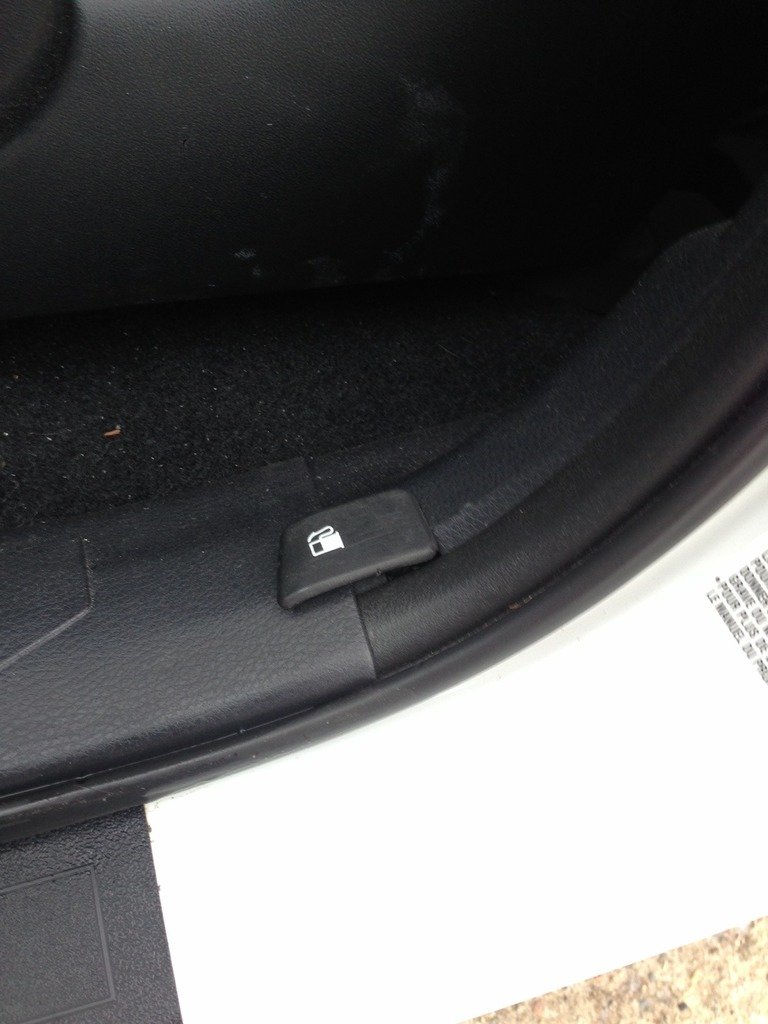

    FYI to those that consider this mod. The 2018 Camry, my daughter has one, also has a full electric version of this and it uses a small Toyota momentary button. I do agree it would work well with @mesojdm panels.

    Good to know which vehicles have the required parts. Thanks for the info.
    This is the '18 Camry Lock Mechanism
    https://www.oempartworld.com/oem-pa...vPWNhbXJ5Jnk9MjAxOCZ0PXNlJmU9Mi01bC1sNC1nYXM=
    The momentary button doesn't match our trucks but the new CH-R has one.
    https://www.oempartworld.com/oem-parts/toyota-fuel-door-switch-84841f4010
    I prefer to find these parts at a wrecker but these links at least give you a part number.
