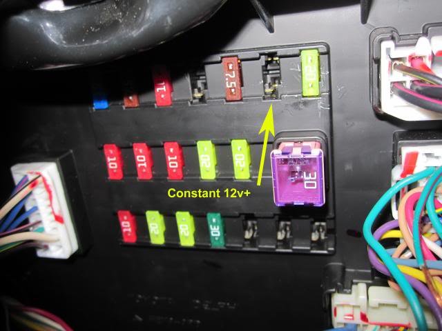

    If that fuse powers the 12V cig outlets - and the 12V cig outlets are only on when IGN is on, how come its a constant 12V (I went out and tested with my meter and sure enough it is constant 12V)...

    I could be wrong but if it's tied to the ignition then I believe the ignition switch would control the power. Much like a light switch it always has power but prevents power from reaching the light unless it's on.

    So the fuse is before the relay?

    I'm not sure if that's a question or not. It sounds like you figured it out. I don't even know what that fuse is for. I just probed until I found a hot fuse without the key and stuck the fuse tap in it. I wanted constant so if I got out to fill up and forgot to pop the door i could just reach in and do it without putting the key back in the ignition.
    Yes. Fuse tap to your button. Then button to the relay/actuator.
