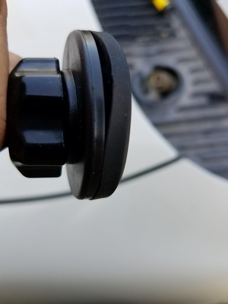

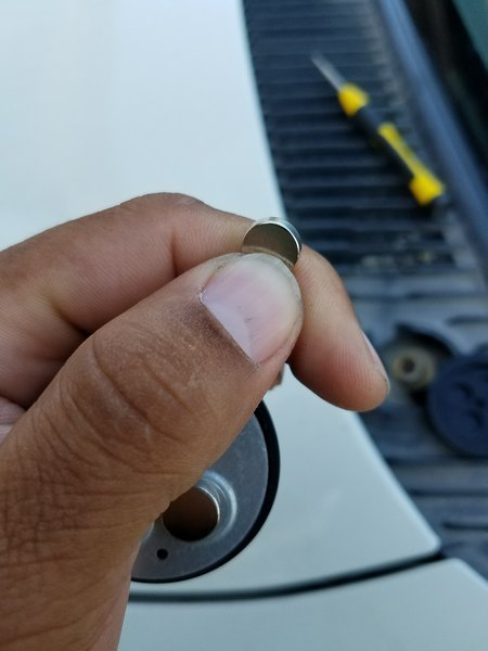

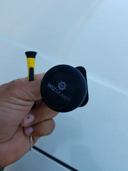

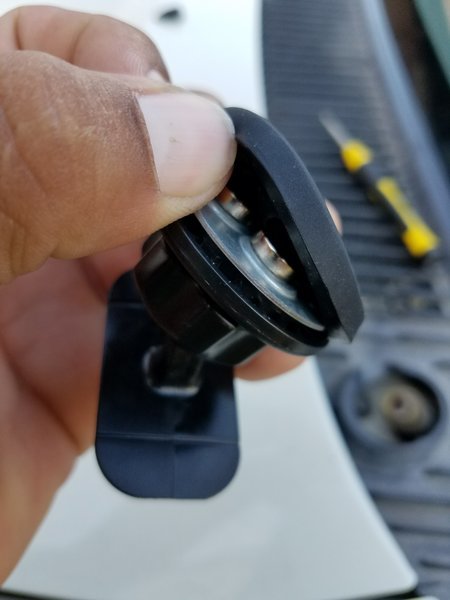

    I used magnets to hold the door closed.
    If you have a broken lock, this is clean and works great.
    Buy small magnets or magnet stripes and line the edge inside the gas cap area and it shuts pretty well.
    I got mine from two Magnetic Cell phone mounts that broke.
    Here are some pictures Hope it helps.
    I removed the broken plastic piece just incase I want to go back to it actually locking.
    Took the magnets out of the mounts.
    20170409_081928.jpg 20170409_082008.jpg 20170409_082034.jpg 20170409_082040.jpg 20170409_082049.jpg
    and finally lined the edge of the truck bed area where the edge of the gas door sits.
    Done.
    It closes like a dream, and just insert your ignition or what ever key to just pull it open. ( used a small screwdriver for the video, forgot my key in the house)
    Hope this helps some one.
    P.S. magnet cell holder only cost me $5.
