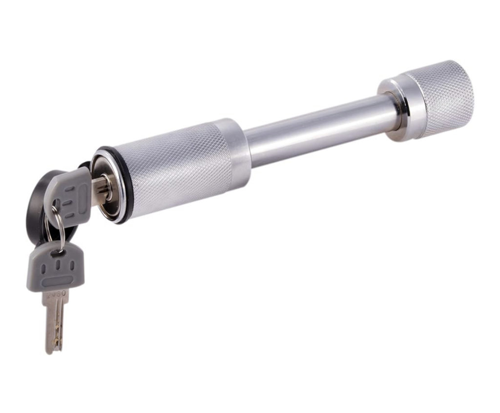

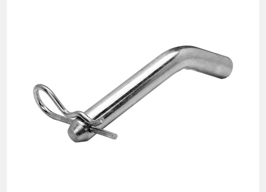

    I have a hitch that only has one hole for a pin.. so I have to choose between a standard cotter pin”d hitch pin or a lockable hitch pin.. my question is it is safe to tow with only the lockable hitch pin on ? Or need both hitch pins - the lockable for security and the standard cotter pin for towing weight safety to the reciever

    The lock pin should be fine. It should also have a warning sticker about it’s limits. One thing about the lock pins - I like the ones where you push the end in to lock, as opposed to having to use the key to lock it.

    A 5/8" pin is a 5/8" pin. What difference does it make whether it's a cotter pin or a lock on the end. The cotter pin/lock have minimal pressure on them. It's the shank of the pin that's taking the forces while towing. The lock is only there to keep someone from pulling the pin while you're parked somewhere.

    Yes the locking pins are safe for towing. They are meant for towing. They are the same as the one that have the cotton pin but have a lock instead. In all the boats and travel trailers I’ve had I’ve never seen a hitch with 2 holes, one for cotter and one locking.
    I wouldn’t tow especially my boat without a locking pins. Lots of boat trailers get stolen when left in the launch ramp parking lot. The locking pins while not absolute are a big deterrent to trailer theft. Use the locking pins.
    Also have 2 keys, one on your key chain and one secreted in your truck.
    And while we are on the subject be sure to chain and lock your spare trailer tire. I’ve known numerous people who had their unlocked spare stolen. (Including me many many years ago)
    Finally when I leave my boat trailer parked for overnight or more while I’m off fishing, camping or what ever, I chain/lock one of the trailer tires as a further theft deterrent. Also have extra keys.
    Be safe, lock it up.
