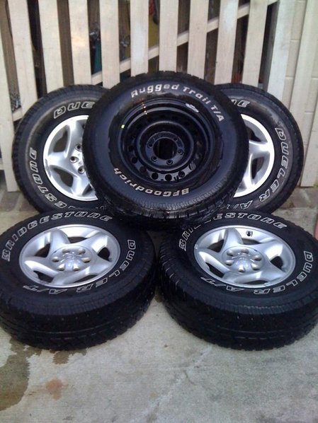

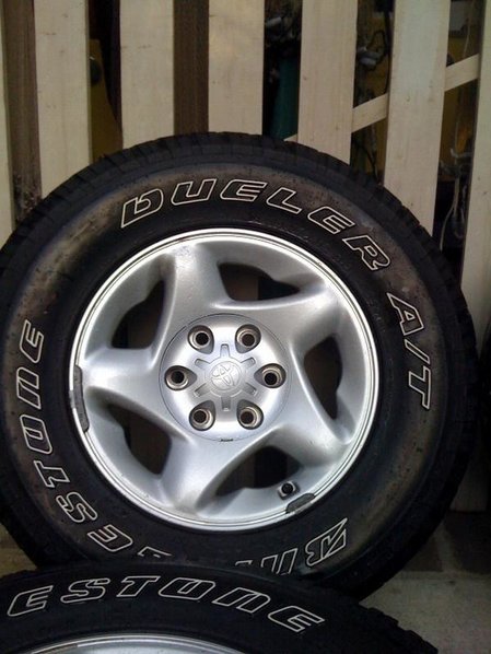

    I have someone looking to buy my old wheels and tires and asked if they would fit their 1995 4X4 Pickup with Locking Hubs. Do you guys know if they will?
    Thanks!

    The wheels will fit as all the toyota 4x4 trucks from way back to now have the same centerbore (106mm IIRC) and six lug bolt pattern. I put the steel wheels off my 2007 on my 1995 as I wanted to go with a 16" instead of the 15" wheels that were originally on it. The only thing that won't work is the centercaps on the front as they have to be open to turn the locking hubs. They may be able to cut out the middle of the centercaps to allow access to the manual hubs or just leave them off.
