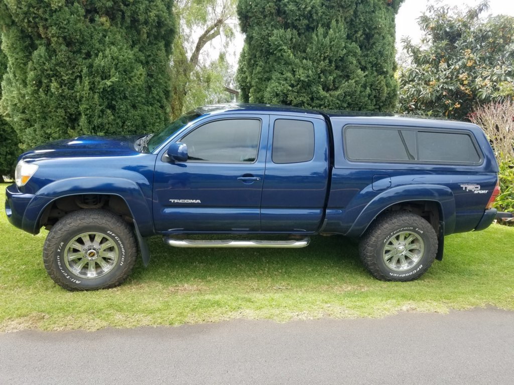

    20190308_123636.jpg So a few weeks ago I installed a conversion kit from automatic to manual locking hubs on my 2007 Toyota Tacoma sport. I will admit I was skeptical at first . I read about others that did it. claiming they improve their gas mileage 1 to 2 miles per gallon someone even saying 3 to 4. I just wanted locking hubs for the capabilities it offers. Improved gas mileage would be a plus. Now that I'm done I've checked the numbers twice I was getting 16 to 17 miles per gallon with my truck and I'm now getting 20 to 21. That's a 3 to 4 miles per gallon Improvement . Anyone who wants better capabilities and better economy. Should definitely look into this conversion. I'm very happy with it. Parts done by remember @05Taco4x4 thread ToyotaHubs

    All valid points I hear from people here. It really depends on what your needs are I live in Hawaii where the weather is warm all the time don't need it for snow. If I'm going out off-roading I just lock the hubs before I go. I have a two and a half inch lift with front differential that was always engaged and it got rid of my vibrations I had. And the benefit of having 2low is really nice when pulling a boat out on the ramp. That way you can still turn in the concrete parking lot without trouble. And plans of future modifications of the lockers. Sometimes has too much traction but you still want the low gears. And really steep hills. Many applications it can be used for. Just depends on your needs
