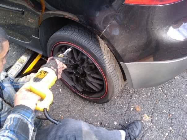

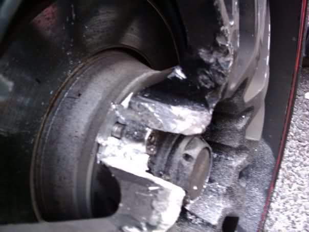

    dont be like this VW tuner guy and cut a portion of the wheel off with a sawzall
    the whole story in it's full epicness here.. it's a great read that will have you LOL'ing till your sides hurt... http://honda-tech.com/showthread.php?t=2684546
