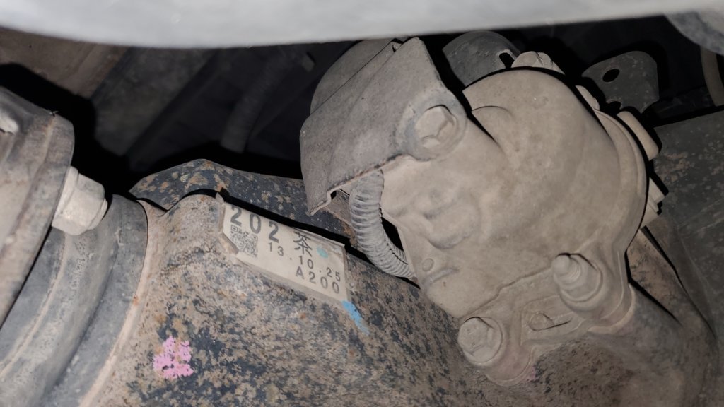

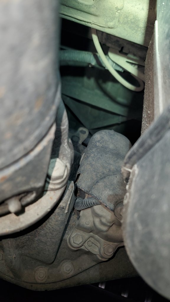

    This is my first post so please excuse my ignorance but I just bought a 2015 TRD Off Road with the locking rear diff. The truck was well used and has 217,000 miles but (no surprise) it runs strong and is in overall pretty good condition. One owner CA car so no rust and as I was examining the underside I noticed the rear diff has an almost new sticker like the diff was fairly recently replaced. It should have a rear locker but I'm not sure how to tell by just looking.
    The part number looks like A0 202 0129150824 SKY. I've spent the last hour looking up the part but no luck. My question is, How do I tell if it is indeed a locker as I don't have any off road areas to test it nearby? Are there visual clues? Does the part number (?) help identify?
    THANK YOU
    Any help greatly appreciated.
  2. Jul 26, 2025 at 5:00 PM
    haydendoesmith
    haydendoesmith Well-Known Member
    Oct 9, 2019
    #307574
    113
    15 DCSB TRD Sport 4X4 Auto
    Post a photo of your differential taken from the driveshaft side.
  3. Jul 26, 2025 at 5:00 PM
    FloTaco
    FloTaco Well-Known Member
    Oct 31, 2013
    #115610
    598
    Bay Area, CA
    2021 SR DC 4X4
    There should be a wire harness coming from a silver or black actuator on the rear diff and a push button to the left of your steering wheel. The button is title “RR DIFF LOCK”
  4. Jul 26, 2025 at 5:01 PM
    Dm93
    Dm93 Test Don't Guess
    Mar 3, 2015
    #150066
    13,877
    Texas
    2014 DC OR 6spd 4x4
    Predator tube steps, Ranch Hand grill guard, Magnaflow CatBack exhaust, Toyota tool box & bed mat, 2LO Module by @Up2NoGood, Rearview Compass/Temp Mirror, Tune by @JustDSM.
    It should have an actuator on it that looks like this.

  7. Jul 26, 2025 at 5:05 PM
    LarHawes
    LarHawes [OP] Well-Known Member
    Jul 26, 2025
    #474798
    46
    Larry
    Vista CA
    2015 TRD OFFROAD ACCESS CAB
    Awesome I will check ASAP...
  8. Jul 26, 2025 at 5:15 PM
    LarHawes
    Jul 26, 2025
    #474798
    46
    Larry
    Vista CA
    Looks just like the pics you posted - THANK YOU, THANK YOU, THANK YOU so much for quick and informative help!!! Hopefully I can contribute some day.
