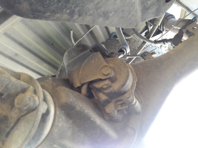

    Easy way to check is look at the rear diff and see if the actuator is hanging off it.
    If it's aftermarket then there will be tubing or wires going into the diff depending on if it's pneumatic or electric.
    If you can't tell then turn it on and take a sharp turn and if the inside tire starts chirping... then you got one!

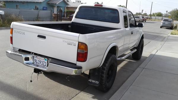

    I havnt been able to go anywhere to check if the diff works on it yet. I do notice the light for it on my dash light up though when i first start the engine. Heres a pic of the truck. 00I0I_4CMAD6yq1lG_600x450.jpg

    Look like your truck is repainted. Possible they removed the trd sticker.

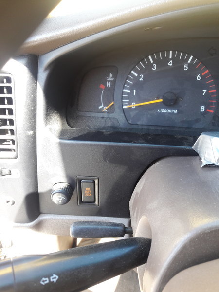

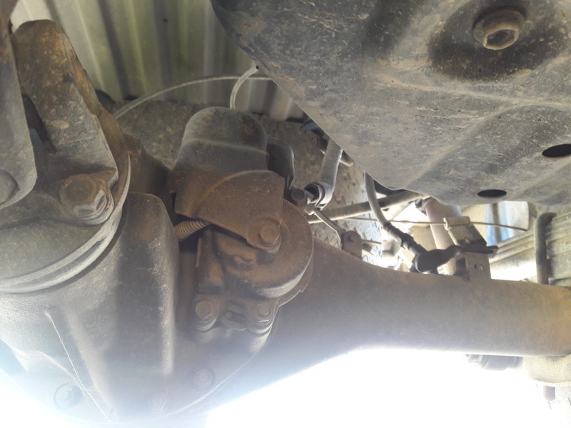

    Heres some pics and im looking up the vin right now. The last pic is of the rr diff lock button.
