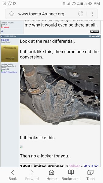

    7
    I managed to find this article. The vehicle in question is a 4runner but that looks like the same diff locker as in my truck so im guessing someone put it in themself. Hopfully i can test it out soon and let you guys know. I appreciate all the help
