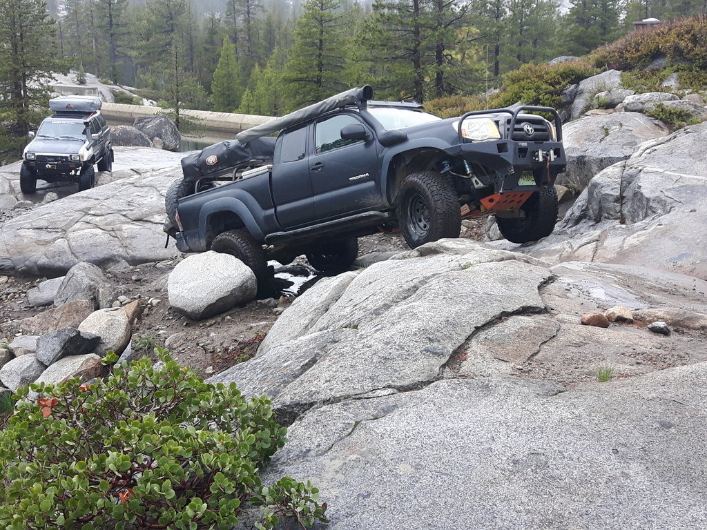

    If you want to do the big name trails, you'll need a front locker. In my experience people who break front CVs are either binding them up or they are bouncing and or going from low traction to suddenly full traction. You want the cvs to be the weak link or you start breaking diffs. That being said I carry spare oem CVS with me at all times. But if you compare the second gen/3rd gen Tacoma ifs with that of a 1st gen you'll notice the components are much larger and robust. I just spent 2.5 days flicking the front locker on and off in all kinds of situations and would not have been able to complete the trail without it. Well actually that's a lie I'd just have to winch a hell of a lot and would probably have tons of body damage.

    Meh, my brother did the Rubicon back in the 90's (before they bulldozed some of the hard sections) with his open diff 86 4Runner running 32 BFG M/Ts. Driver skill gets you in (and out) of a lot of places. He got yanked up in a few places, but dudes in Jeeps with $20k in mods and 37's couldn't believe he was going where he was.
    I agree you want the CVs to be the weak point, as they are (relatively) easy to replace in the field.

    Lol That's what all the buggy guys were saying to me coming up Cadillac. Still the most technical trail I've ever been on. But ya I'd rather launch a cv in than have to run back to town get a new diff and replace that on the trail. CVS, clutches, brakes they're all wear items imo
