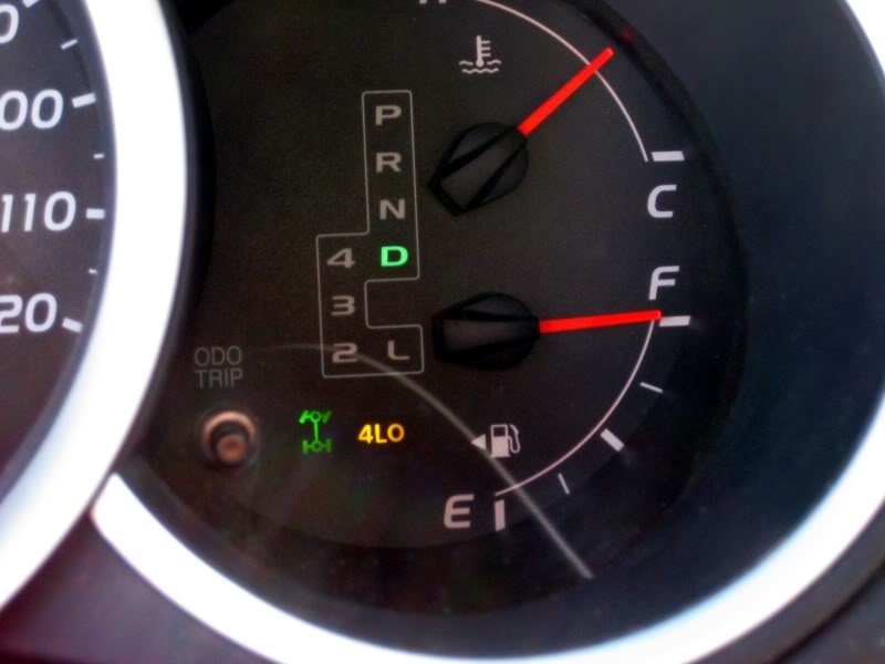

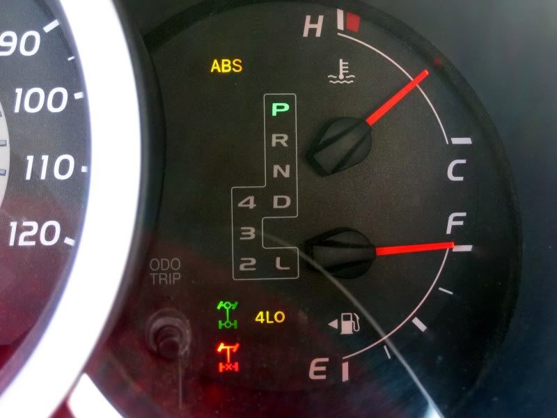

    David K
    David K Well-Known Member
    Jun 27, 2009
    #18969
    12,407
    Pala Mesa, California
    2010 4WD Off Road DC
    Differential Breather Mod Light Bar: 4 Cree LED lamps Bilstein 5100s Ride Rite Air Bags
    That doesn't even sound logical...?
    If you truck is missing this, it belongs on the door...
    First, you must be in L4... and to go from H4 to L4 you must be in NEUTRAL (not PARK).
    Then, IF you need the rear locked (if L4 didn't get you up the hill)... press the locker switch... it will blink until it is engaged, then stays solid.

  10. Aug 15, 2011 at 8:11 PM
    Crom
    Crom Super-Deluxe Member
    Jun 22, 2009
    #18782
    9,641
    Nick
    San Diego, CA
    2009 4x4 DCSB Camp Supreme
    Millions
    Excellent, clear pics David!
