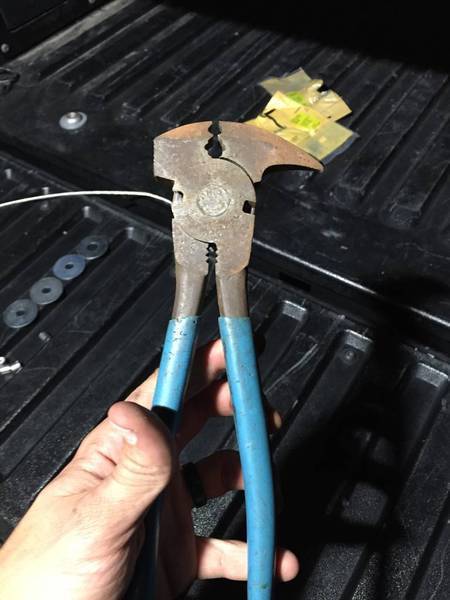

    The one Negative about the soft shells is that they aren't lockable. However I have figured out a way to make it much more secure than it comes stock. I Have not yet done anything to lock the side windows but I have a couple of ideas so ill figure that out soon. I figure most people would go for the back first anyways.
    Things you will need:
    A Bestop Super top, This will NOT work with a softopper.
    Pop and lock system

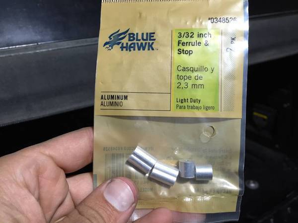

    2ft minimum of 3/32 cable. Its cheap stuff so get more than you need to be safe.
    2 packs of ferrule stops
    And Something that can cut cable and crush the aluminum ferrule stops. Im not sure the name of this tool but its made for the job and works excellent.

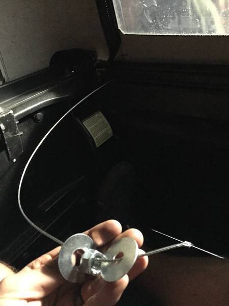

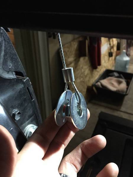

    And something to attach to the cables that Will not slip through the crack between the top of the tailgate and the aluminum bar attached to the back flap of the top. I used a nut between two washers and this works great. But you can use anything.
    A buddy for help is very useful
    Procedure:

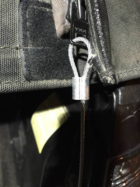

    Loop the cable through the zipper and apply a ferrule stop like so:
    This is where your buddy will come in handy
    Then with the cable hanging down get inside the bed and have your buddy close the tailgate. Now put on another ferrule stop following the washers and nut (or other stuff) and loop around them as close as you can to the tailgate. Heres the order that i did it in:

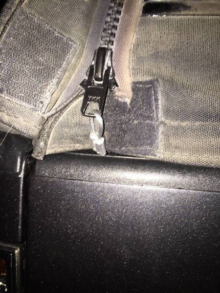

    Heres about how long you should try to make the cable. The longer the cable the more the zipper will be able to be opened, but if its too short the tailgate might not be able to close.
    If done correctly it should work just by closing the tailgate. It is a little noisy when it is closed but its no louder than the pop and lock system. I figure the small inconvenience is worth the deterrent. I was also thinking of taping up the nut and washer to make it quieter but it doesn't really bother me that much.
    Heres what it looks like with the tailgate closed:

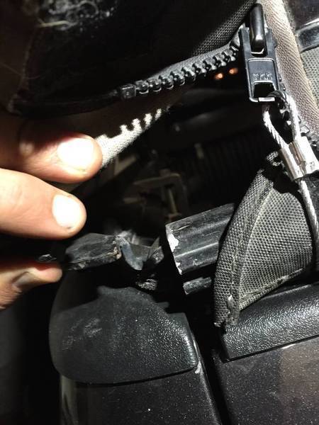

    Heres as much as I could get mine open, I was able to get my hand in but I only would have been able to grab things that could fit through that hole and that were close to the tailgate.
    Keep in mind this won't keep thieves who have a knife out of your tailgate this is only a theft deterrent to make it that much harder for them to get to your stuff. Or to make you feel that much better about leaving you stuff in your Bestop. Ill add to this post when I make a system to keep the side windows from being unzipped.
    Hope This helps keep your stuff safe!
