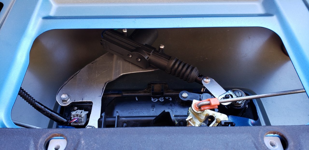

    If you are capable, you can by generic lock solenoids off Amazon for dirt cheap and make a bracket to mount it.20200229_152758.jpg
    Then run some wire and connect it to the truck. I connected mine to the left rear door.

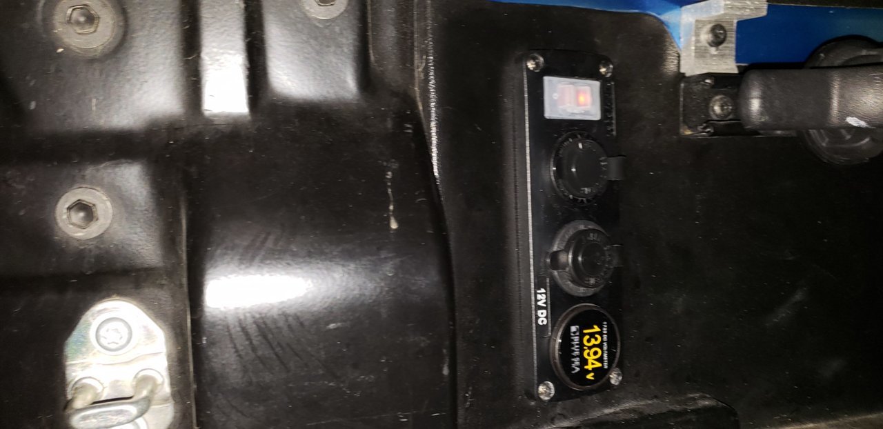

    Also, either way you do it, when running the wire, I suggest building a bundle of various wires for future upgrades and run it at the same time. I ran 7, 12g and 2, 10g wires and tied them off. This came in handy when I ran a Blue power panel in the box.
