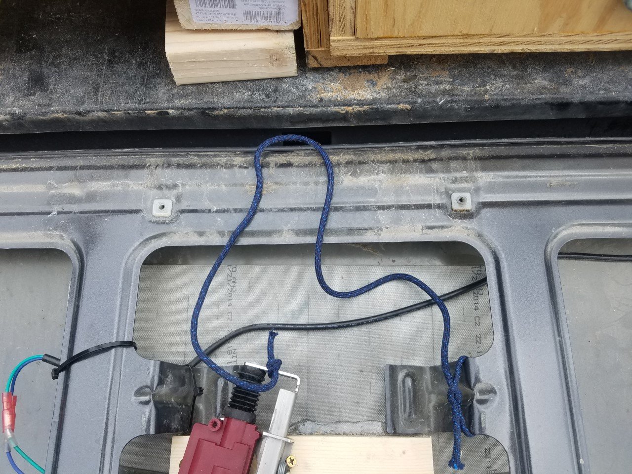

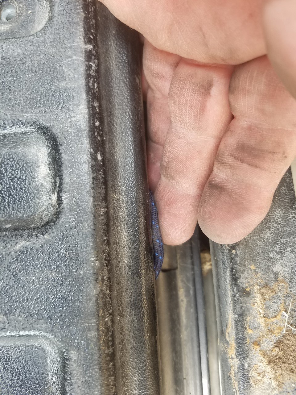

  15. Aug 9, 2020 at 11:10 AM
    #55
    jproffer
    jproffer Well-Known Member
    Jul 9, 2018
    #258790
    628
    Jim
    Perryville, MO
    '15 MGM Sport DCLB, V6
    The paracord mod....also you can see the board (1x2) that I used to support the P&L. Little epoxy, couple screws...way better than it was. Ding dong, the twang is gone.
    As you can see, the paracord barely sticks out the bottom of the tailgate, and behind the lip if looking at the tailgate from the outside. But it could be hooked with something and pulled to unlock if ever necessary.
    You can barely see the paracord here. This is from the outside and below. It's there, trust me lol. Just below center vertically, and just left of center, horizontally.
