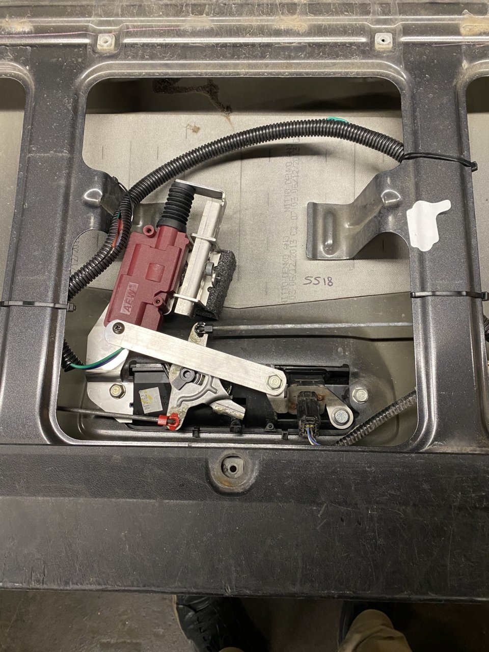

    I ended up going back to the oem handle and added the P&L 8521. I forgot how much nicer the oem handle is. The lock works great. To help with the single bolt on the bracket, I added an additional aluminum support bar.

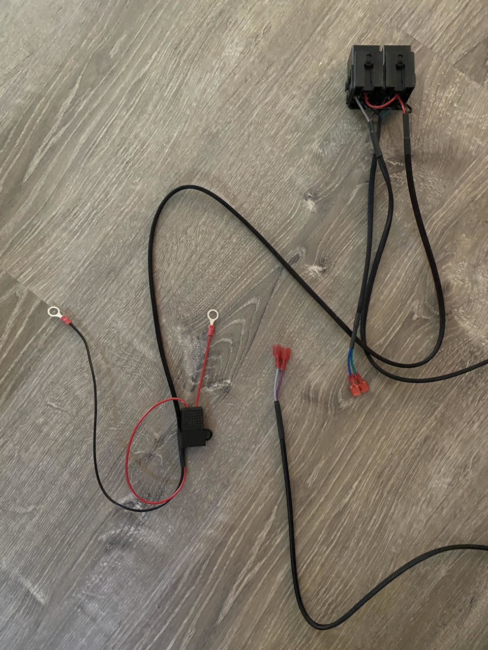

    Pace Edwards Powergate LK410 has a relay. I think the kit is needlessly complicated.
    The red and black wires with fuse: you're instructed to connect to the positive and negative of the fuse box.
    purple and grey: get tapped to the truck
    Green and blue: go to the lock in the tailgate.
