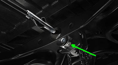

    If you have an alloy wheel with large spoke openings, a thief can reach through the wheel spokes and turn the metal piece with pliers, bypassing the cone-shaped receiver:
    I take up the spare tire chain slack with a lock, Abus P/N 70/35 KD:
    The lock itself is marine grade and weather hardened. I keep one key on my keychain and the second key with the jack and tool kit. Plan is to spray some teflon lube in the lock's key hole before each winter, the same time I do the gas cap lock, tonneau lock, and tailgate lock.

    Yeah and the stock steelie is fine, too. It's a vulnerability with spoke openings large enough to put your fist thru (e.g. OEM TRD Sport, SCS F5, TE37 & knockoffs by FN/RRW/Motegi).

    Yes, but have you tried to get to that with the spare on? It is a pain in the ass. I tried doing it when I didn't realize my lock was a lock and so I was trying to remove it. Needless to say, it didn't work and with a bit of research, I discovered what I actually needed to do.

    With my spare (Konig Countersteer) it's easy. I discovered this when my previous truck got rear ended and the holes in the bed floor no longer lined up to feed the prop rod thru.

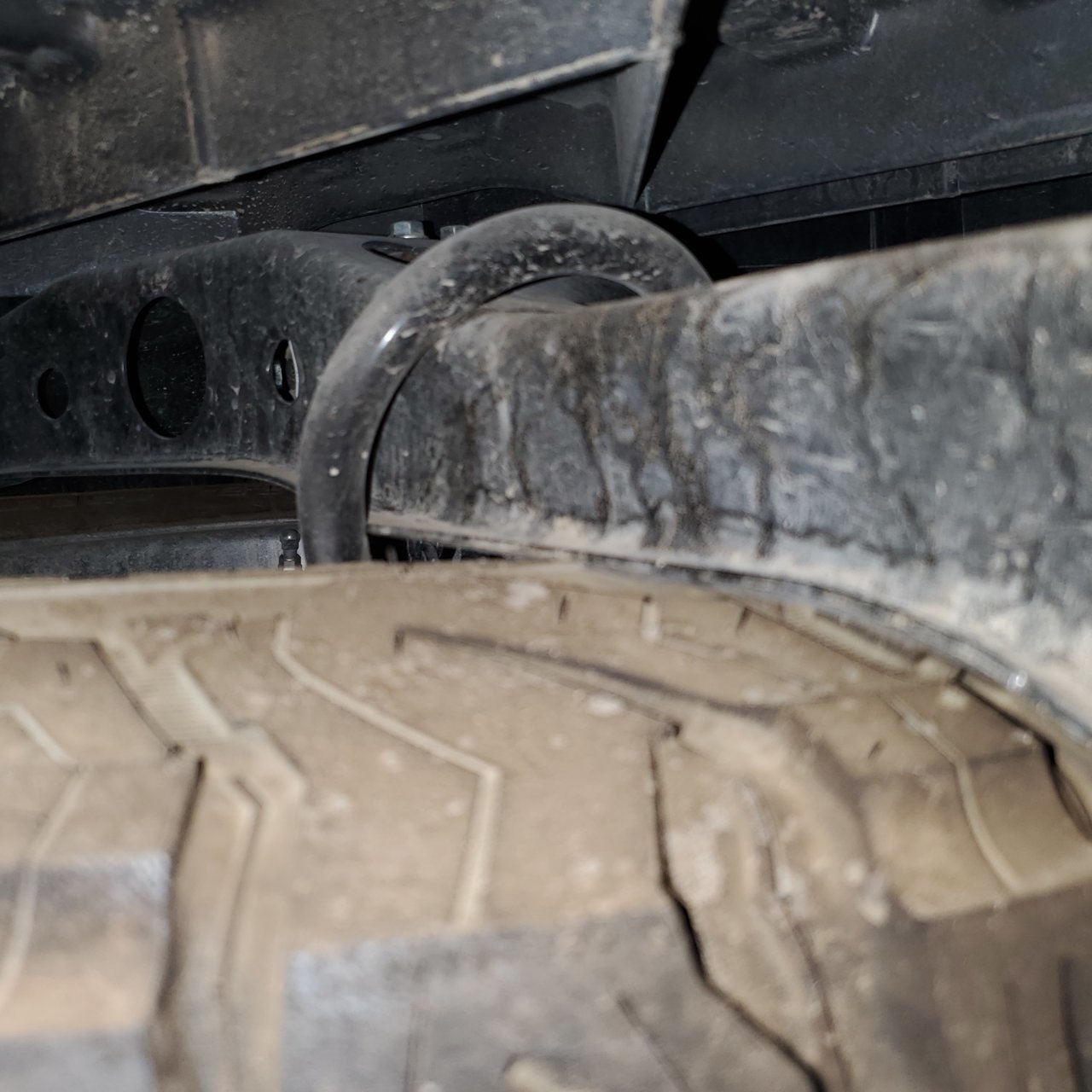

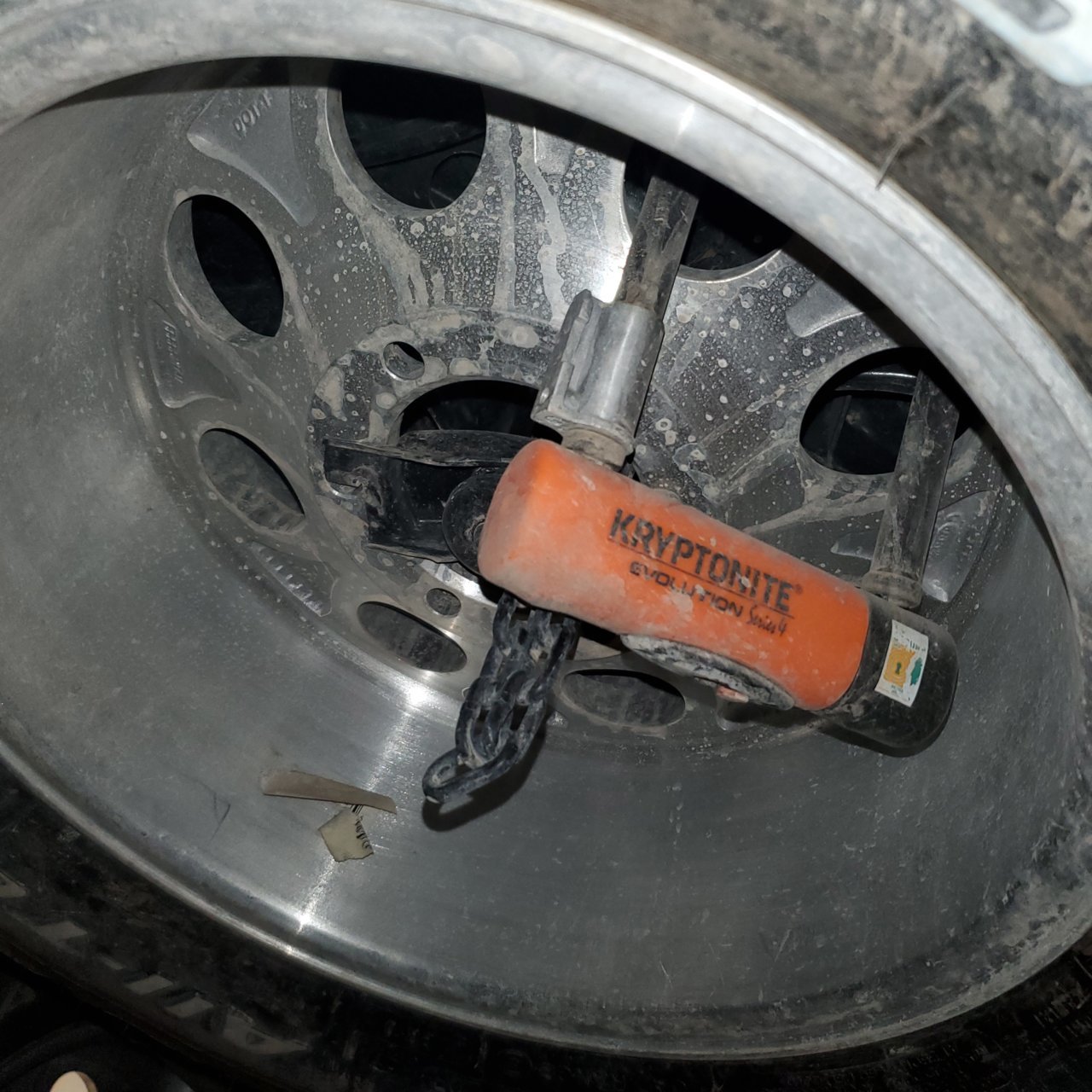

    I use a Kryptonite bike lock. Mine never got stolen yet. I'm just paranoid. 20201114_174518.jpg 20201114_174501.jpg

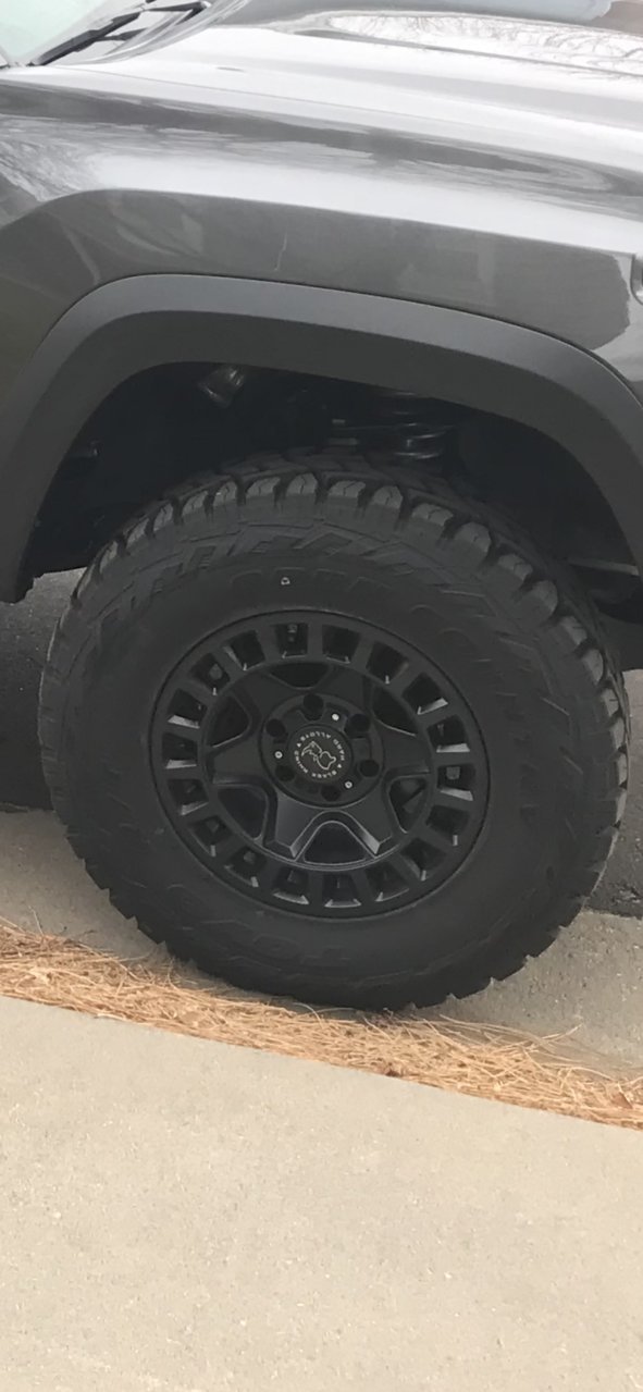

    I like this idea too. I need to see if it will work with my rim. What size is that?

    It's a 16x8 Pro comp 69.
