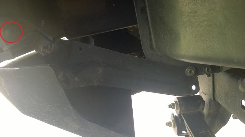

    I took the supports that use to attach to the bottom of the bedsides that I cut off, flipped them upside down and attached them to the opposite side of the truck. Then I drilled a hole through the bedside and attached them to the support with a nut and bolt. For the bottom of the flare I ran a ziptie around the support. I have no wind flippity flopping. Crappy pic but you can kind of make out where I put the bolt. If you need a better pic let me know.

    I'd like to see a better picture please

    The plastic L piece attached to the flare came off the bottom part of the flare section that was cut off. Attached it with some JB weld as an anchor point. In the second picture you can clearly see where the bolt was put through the bedside.

    I had no idea that shakey bed sides were an issue with HC bumpers. This is good info for a future mod!
