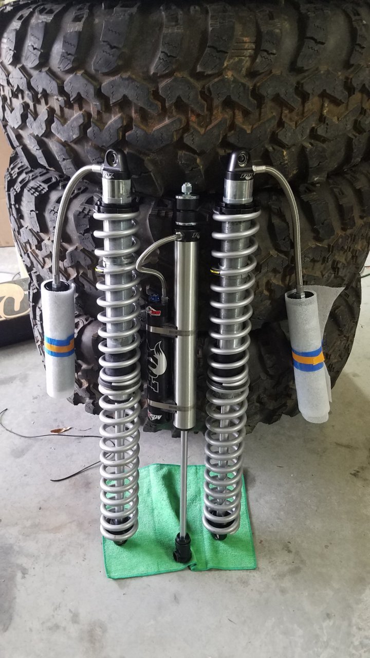

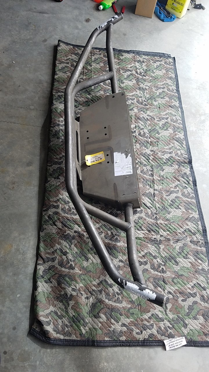

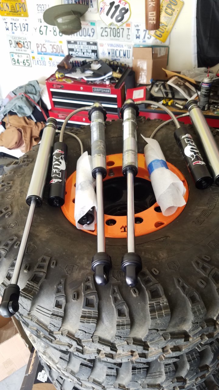

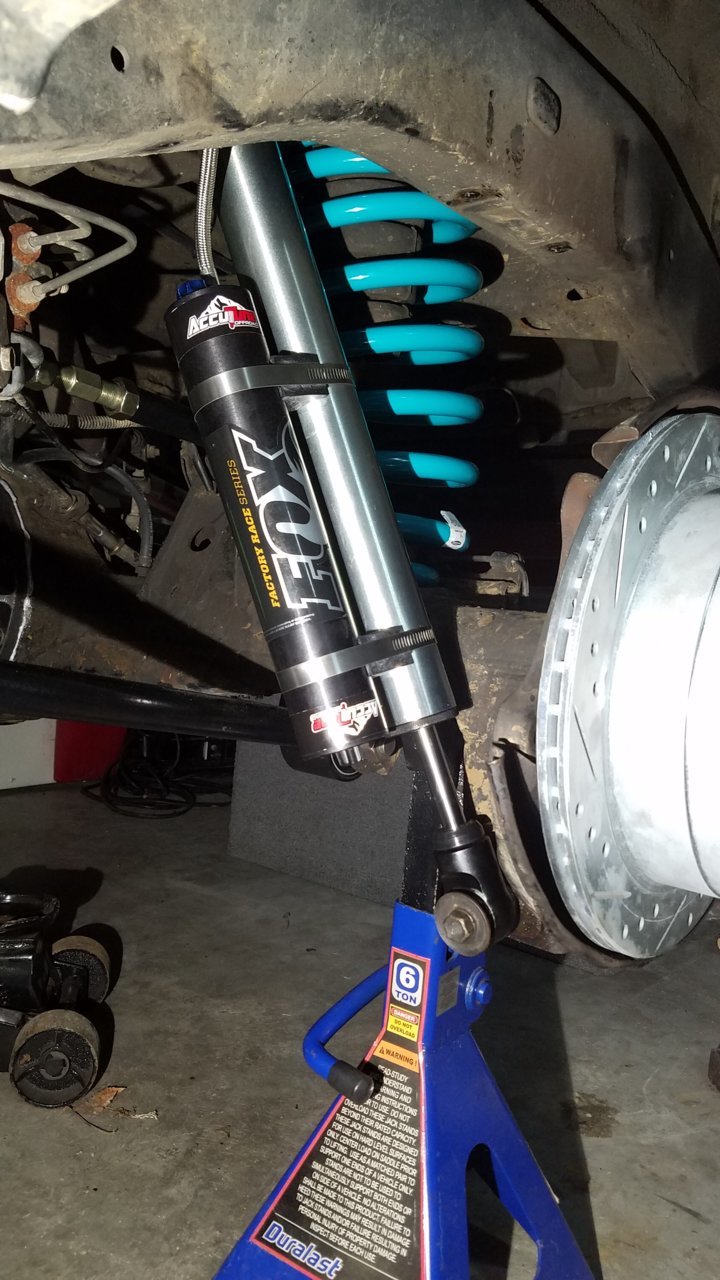

    Got the bumper on Monday and rear shocks in today. Had a long talk with the guys at accutune who have done a few 3 link setups on the 80 and convinced me to run a 250 upper spring so that showed up to. I'll give it a shot at 250/350 and if it's too soft I'll swap the 300 on the coilover. Should have those back from being tuned in a week or 2.

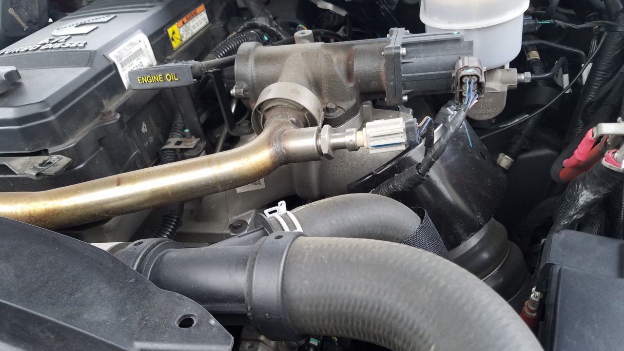

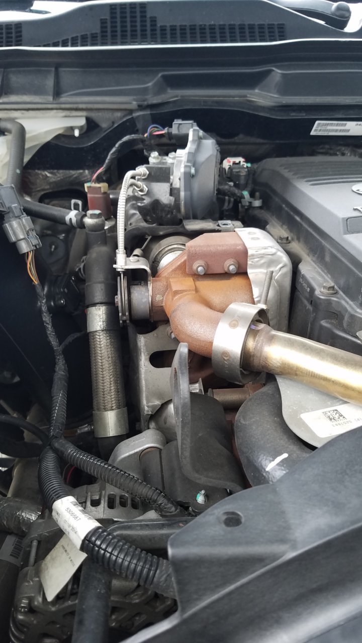

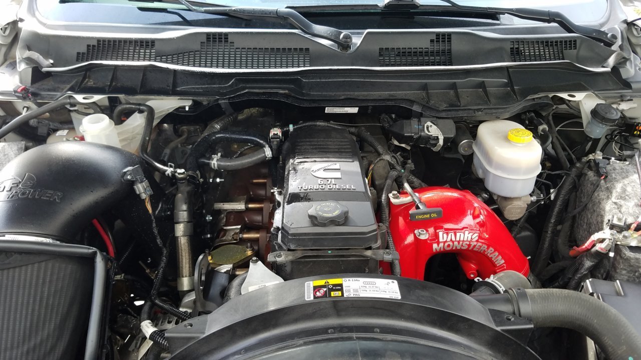

    Spent the day with the Cummins. She needed so love while I've been spending all this money on the burrito.
    Warranty LOL...
    New and clean and EPA disapproved...
    Old and nasty and making hippies happy 20180401_100016.jpg 20180401_100010.jpg

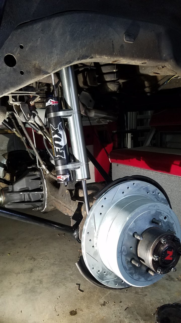

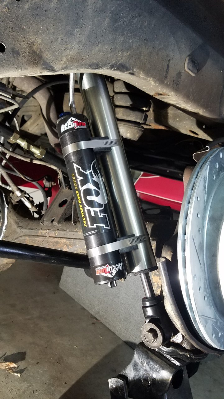

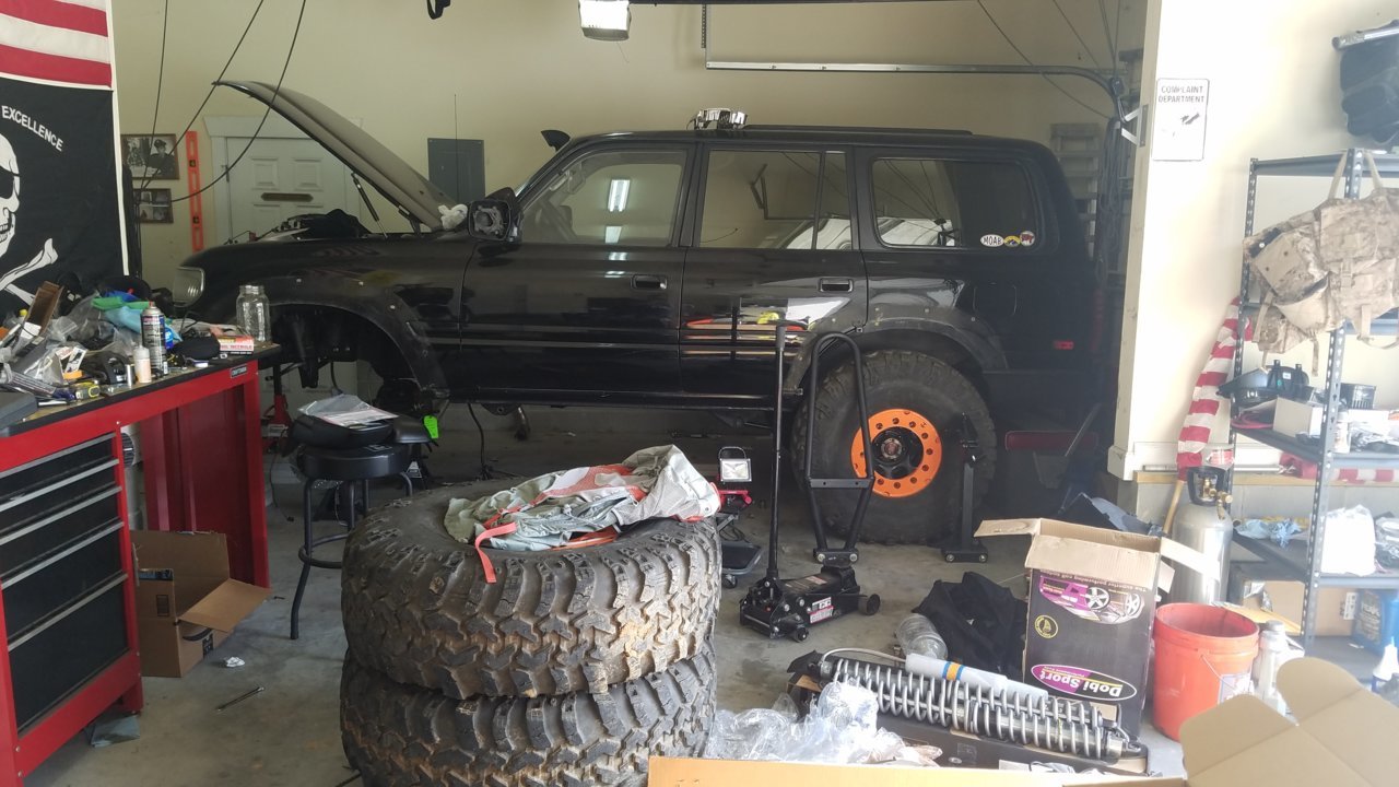

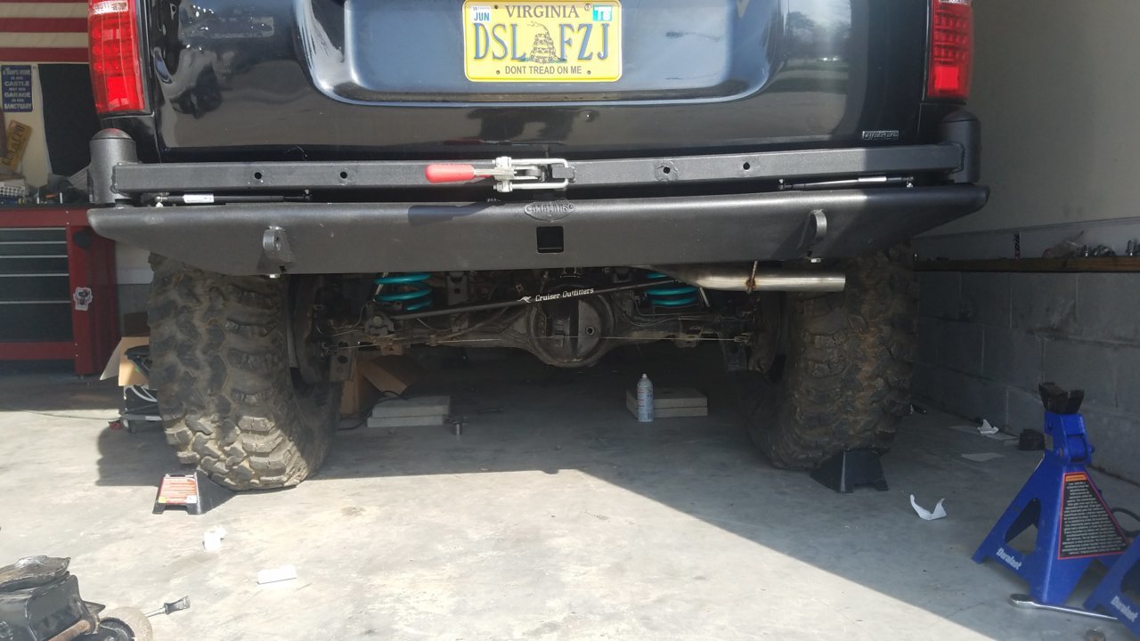

    Little bit of a busy day working the burrito.
    Got the coilovers back together so I could drink in the sights. Also worked the rear back into shape so now she is own her own weight in the back end. Sitting lower than the OME springs for sure and should be nice in the droop dept once I get the lowered bumpstops built and get it strapped to hold onto the slinky Dobinsons in there now. Droop for days now!
    Photos at ride height.20180407_083858.jpg 20180407_105101.jpg 20180407_104938.jpg

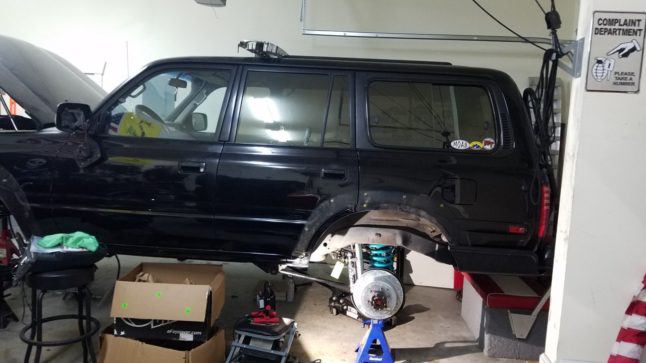

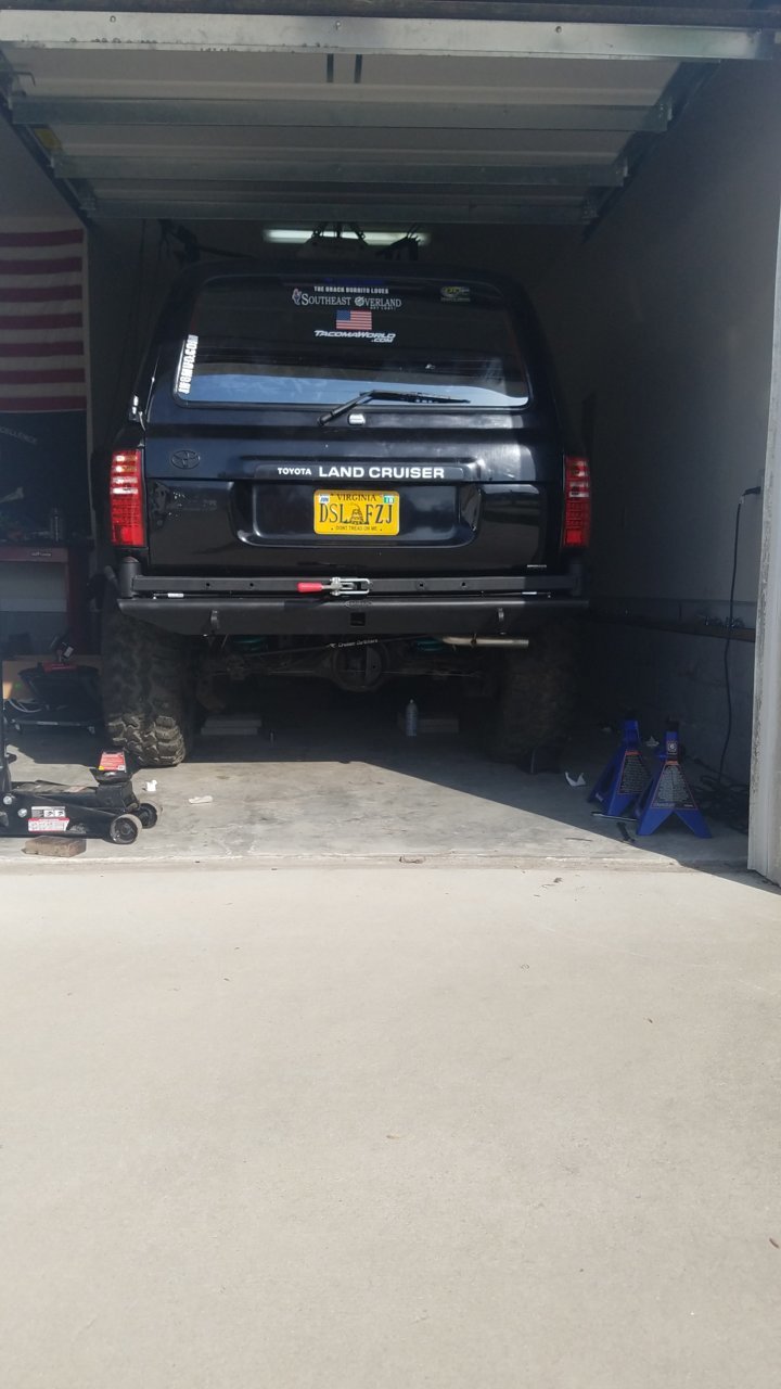

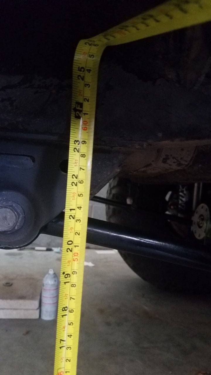

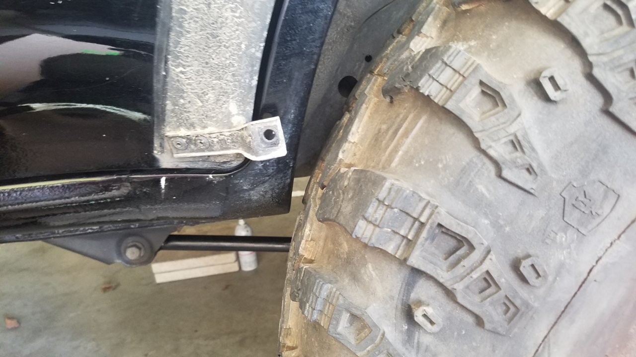

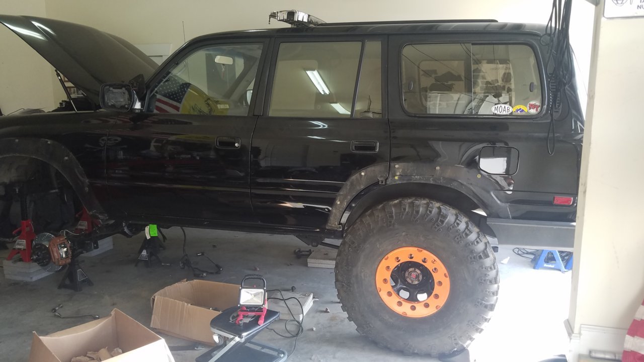

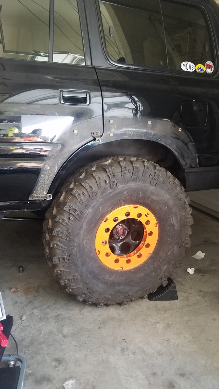

    Got off work a little early today so I decided to get the burrito off some stands today. I'm glad I made the jump to the Dobinsons springs. I'm sitting lower with more travel and I'll assume a nicer ride more or less.
    I can feel it rubbing like cray already :)20180410_165242.jpg 20180410_165319.jpg
    23" frame height is pretty darn good for me at this point. Was too tall before.
    Best mod of the day is finally putting a TW sticker on hahaha20180410_165329.jpg
    Good side views to see that new height. 20180410_165918.jpg 20180410_172116.jpg
