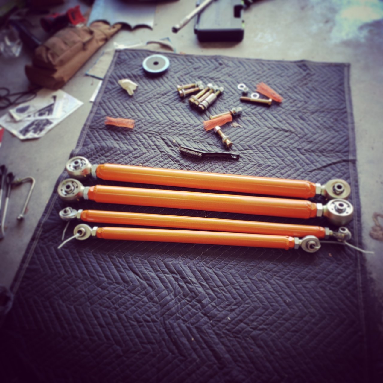

    Got the axle smoothed today and brackets fitted. Couple of little things and I should be welding next week in the evenings.20180617_173528.jpg

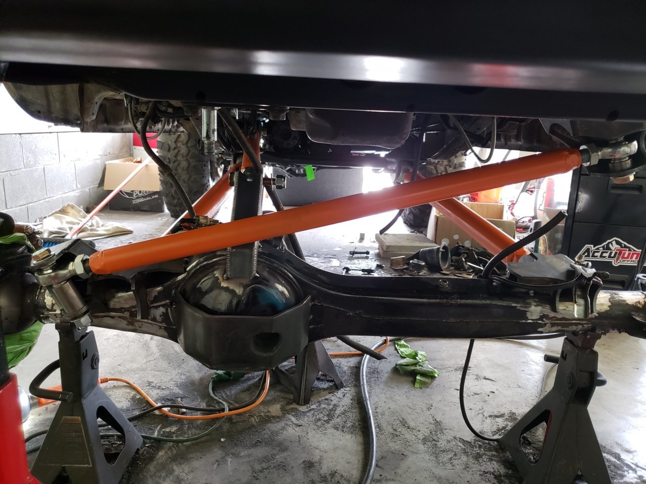

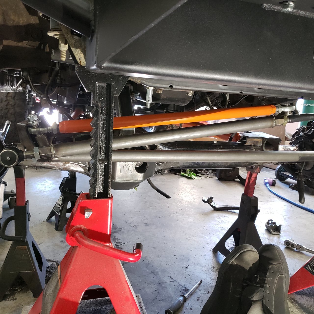

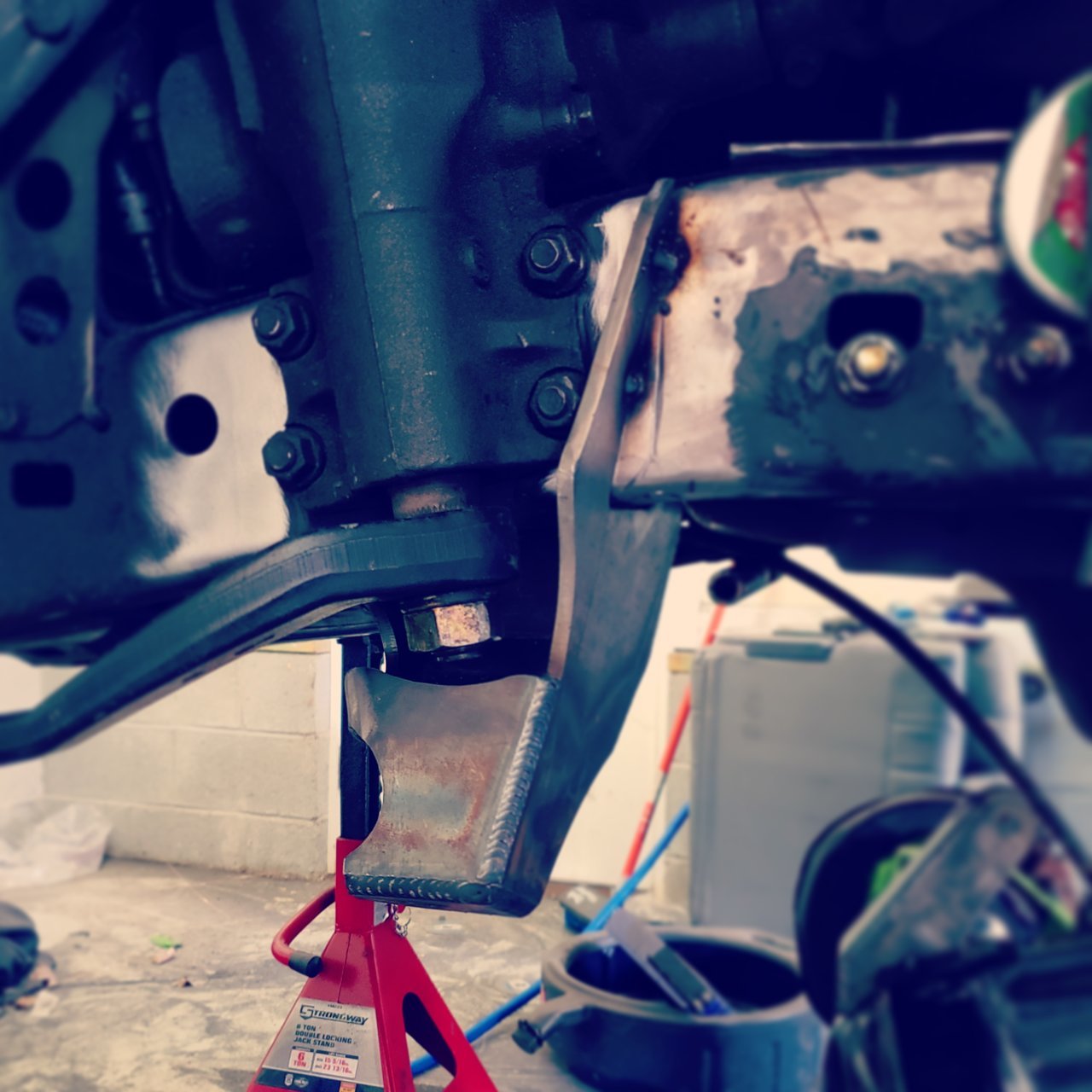

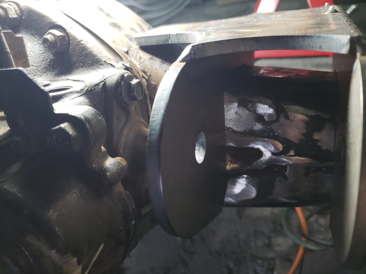

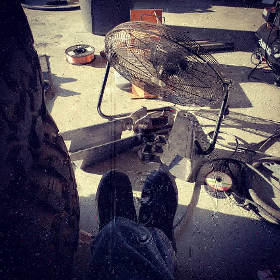

    Been slacking on updating... sorry guys. Should be cycling the 3 link today if things go as planned. Happy Independence Day! And I guess a belated Canada Day to America's Hat!
    IMG_20180630_115422_898.jpg IMG_20180703_200321_555.jpg 20180703_165705.jpg IMG_20180630_115804_223.jpg
    BYJOSHCOOK, RPS1030, stumbles and 3 others like this.
  8. Jul 5, 2018 at 4:05 PM
    #5268
    loco
    loco [OP] Who wants to ride my Brack Burrito???
    Dec 2, 2012
    #92254
    6,351
    Phil
    Virginia Beach, VA
    1996 Diesel Land Cruiser AKA Brack Burrito
    Well its a land Cruiser with a diesel so I've got that going for me.

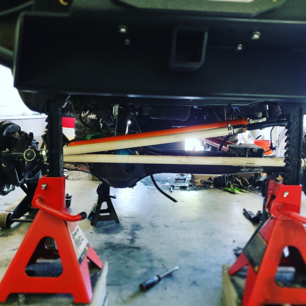

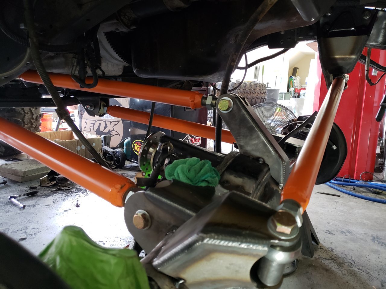

    Got a lot done yesterday...

    Everything looks good except for that gross looking diff guard. :puke:
    Does it clear your panhard at full passenger stuff? How about your tie rod at full lock? I usually see those with the top trimmed down to pretty much were the fill plug is for clearance.

    That's why it just had 3 tack welds... got the steering together today and I'm probably going to cut it down a few inches. Need something to save the front pumpkin from a rogue rock. Looked at some other guards but I like having a big ass thick diff guard. The one in the rear is skimpy and just covers the ring gear but it's the only 9.5 specific guard out there... or at least was a couple years back.

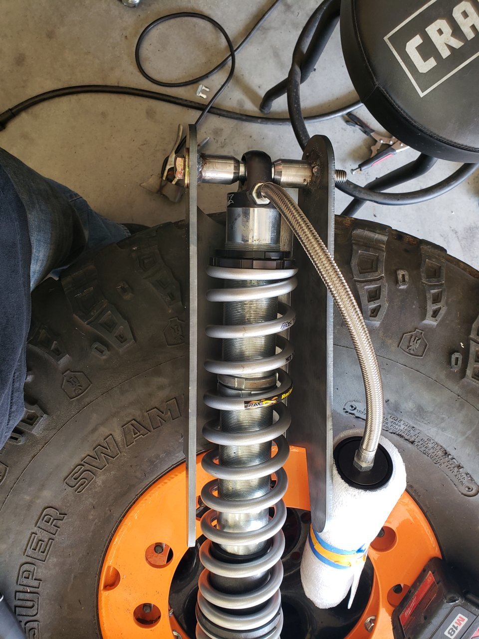

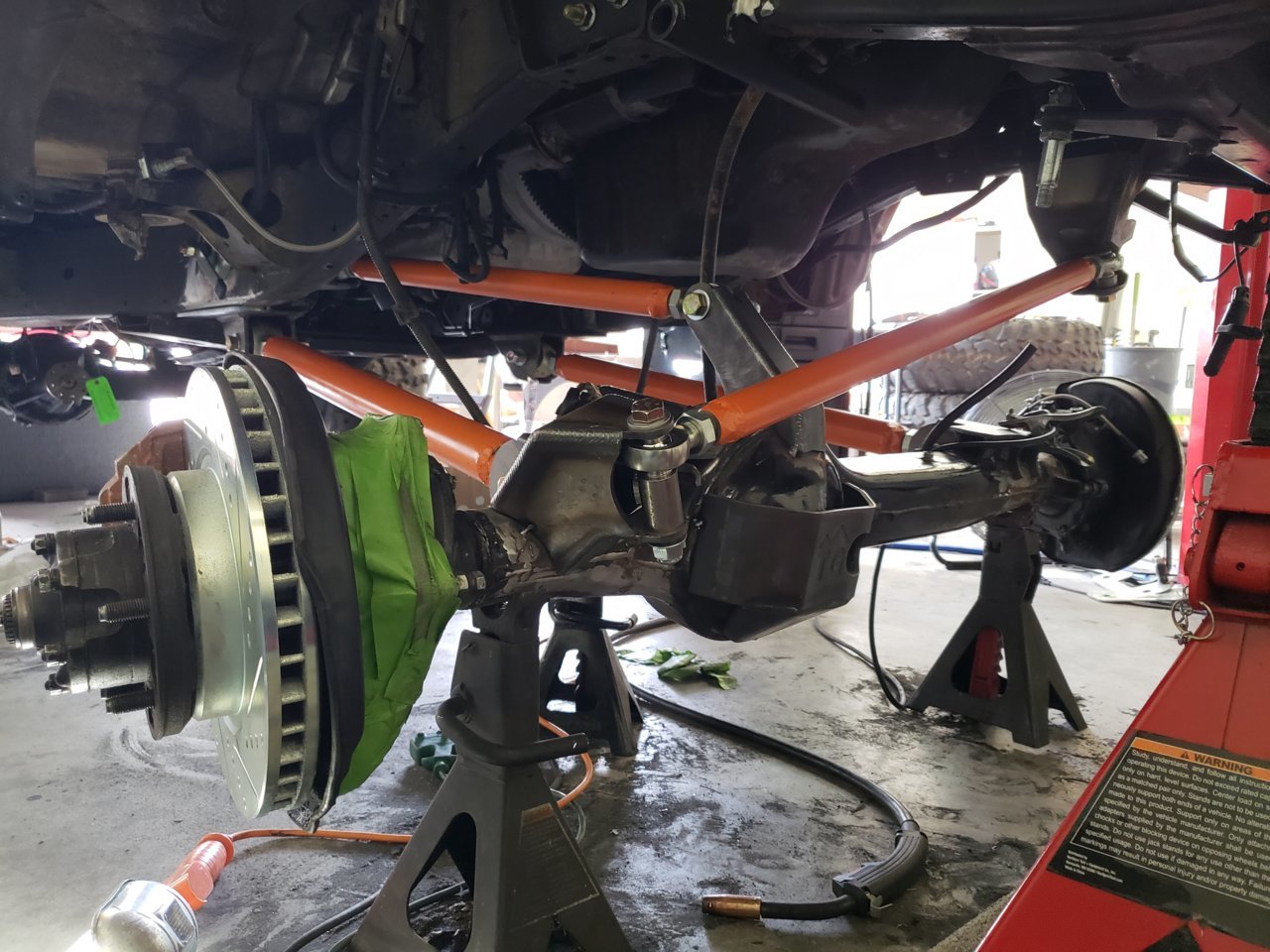

    Steering is all done now. Changing up the coilover mounting... stupid steering linkage is getting in the way so trying something else. Trial and error has been in full force this week.
  18. Jul 8, 2018 at 2:40 PM
