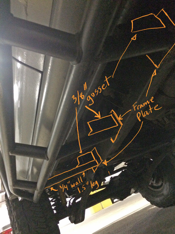

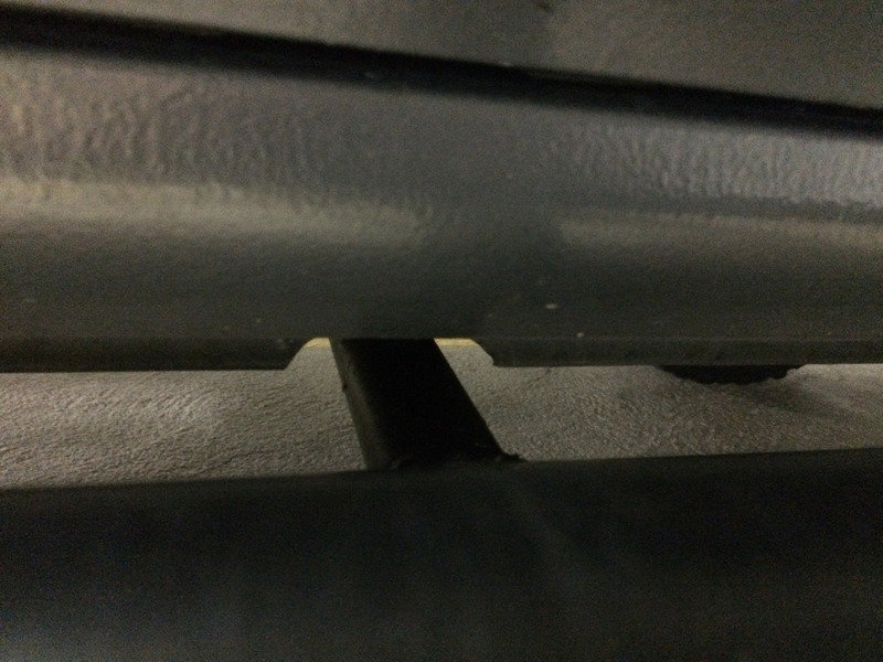

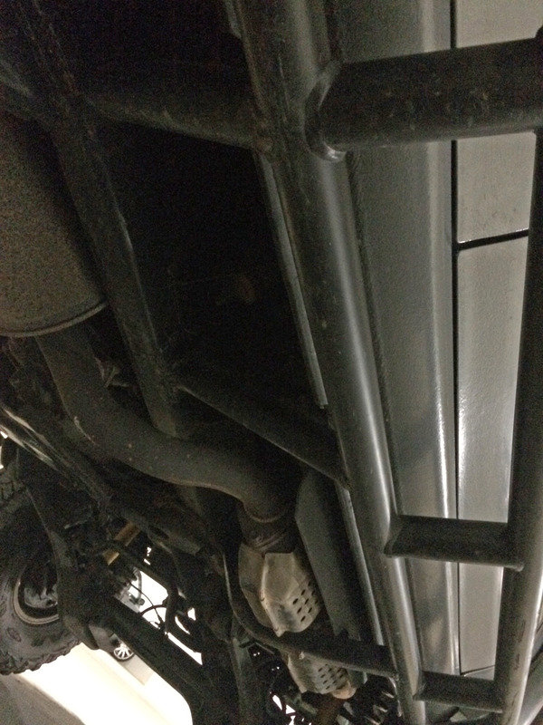

    Sorry for the crappy phone pics but here's a few of my slider legs. These are the 67" TG ones. The provided legs (6 of them) work fine except for the front 2 which are not long enough. So you'll need to make your own front legs. The driverside is really straight forward with nothing in the way behind the rocker panel. Just weld some frame plates, and weld the sliders on. The passenger side is trickier since the exhaust and cats are in the way of the front leg. You'll need to either bend a custom leg (this is what I did) or fab a plate style skid type leg to support the front of the slider and protect the cats. But with your diesel conversion you may not have this issue and it will be as simple as the driver side. I'm rebuilding my cat protection so it's not in the pics.
    The passenger side has a small heat shield at the bottom of the rocker. If that's still there you'll probably need to notch it for the leg. Also, the rocker panel pinch weld is lower than the frame so you'll need to notch the pinch weld, and the legs will probably need to be welded flush with the base of the frame and also be angle down a bit to fit.
    I had some hunks of 3/8" plate that I used for the gussets on top of the legs. The longer down the leg the gusset the better.
    driverside
    notched pinch weld
    passenger side with leg between the cats
    Little draw over to explain it since the pics suck

    Perfect info! I don't have any cats and the exhaust runs under the truck now 100% tucked up so it should be pretty straight forward. Was more concerned about the downward angles on the legs but looks like it will be fun with some Gussets so I guess I get some of these drummed up.
