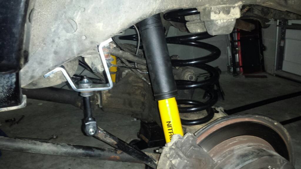

    Rear 90% done. Once I had all the parts that arrived yesterday (new end links and the proper sway bar drop) it was a quick job. Just gotta get it on its wheels and weight to set the panhard. Still waiting on the last bushing for the radius arms to arrive next week and then I'll get the front knocked out.

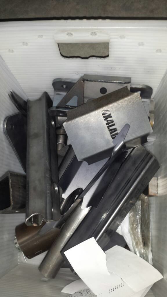

    But the good news is that I opened up the first box from 4x4labs and shits nice! Bumper is built next weekend and I will have the sliders next weekend as well but doubt they will be installed until the following weekend.

    Bumper comes disassembled? Where is the ladder?

    Yup sure did...and I was assured I would be near 4" with +400lbs...I am not thinking they did the math quiet right. I'm going to hold my reservations till its all loaded and back on its wheels before I call bitching. But yes likely a spacer in the rear.

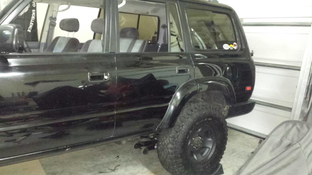

    And honestly a 37 would go in there as it is now.
    My biggest issue here is that I eyeballed frame to tire spot before the lift in the rear since that was somewhat close to a normal setup...it's in almost the exact same spot... maybe 1/4" higher...maybe.

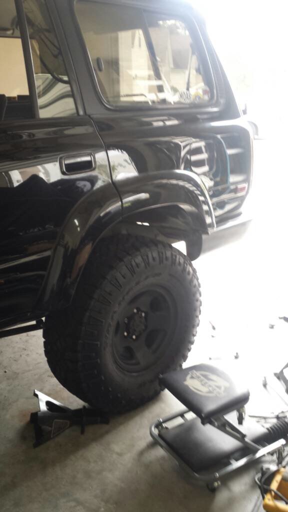

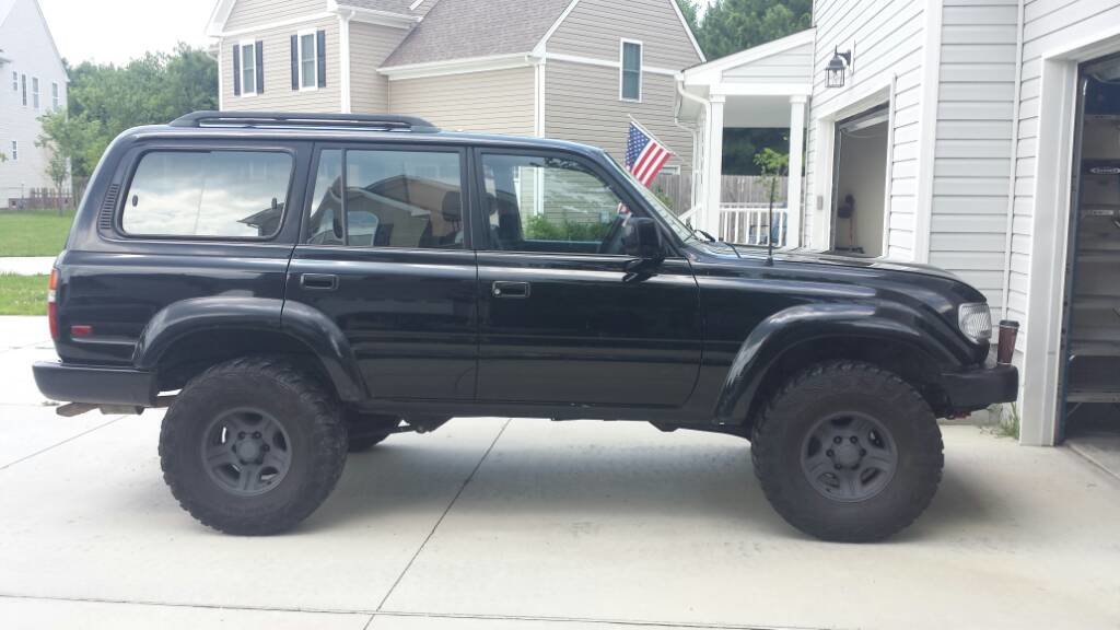

    Here's two pics. Top is right meow and bottom is in the driveway before the lift.
    You can see the top of the frame in relation to the tire... that's not 1.5" of change. So either the 2.5 TJM coils were giving me way more lift than advertised, which is not uncommon with 2.5 springs to get nearly 4"of lift...or this 3" spring isn't going to be tall enough.
    Again I will hold off on calling them till I can at least get it on 4 wheels and outside which should be Tuesday/Wednesday but based off the Ole tape measure I will be sitting ass low without even adding my accounted for added weight.

    37s are going to fit yea but will they self clearance your fender off the truck upon stuffage is the question. I don't know if you plan on trimming or not.

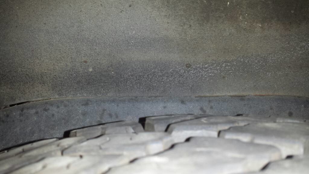

    Maybe this will help?
  18. Jul 4, 2015 at 5:49 PM
    #1218
    2ndGenJonny
    2ndGenJonny Well-Known Member Vendor
    Jan 3, 2013
    #94306
    18,457
    Jon
    Gilbert, AZ

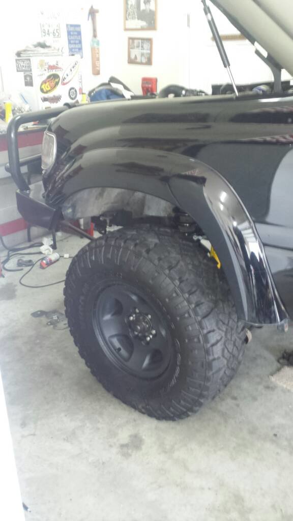

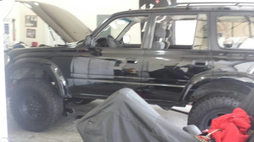

    So I said fuck the bushings and just mocked up the front end...it'll work out fine since now all I have to do is pull 6 bolts and then install the new bushings and then 6 bolts back in. So work now or work later.
    Fucking thing is sitting pretty levelish. Maybe a little ass low as she sits now but it brought the rear end up about 1/2" by just getting the front loaded.
    So I'm too low in the rear for sure. My new rear stuff is going to add an additional 400#+ static 24/7...with probably another 200# for wheeling.. she is going to drop about another inch is my guess once loaded. So I'll get a hold of Kurt tomorrow and see what he wants to do. I'd love to get the correct springs and get them swapped out but I bet it's just going to be a spring spacer fix...which bothers me because I really wanted the springs to be correct and do all the work without a spacer. I am really hoping Kurt gets me the right springs...but since these have been installed I am probably fucked.
