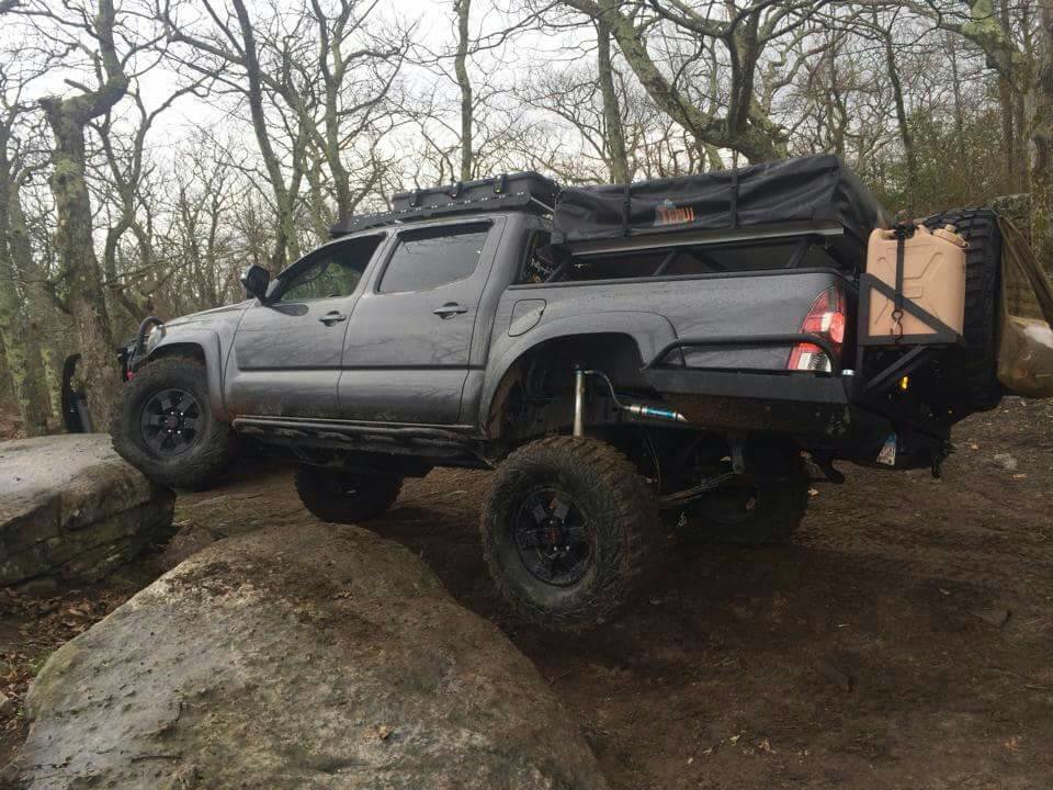

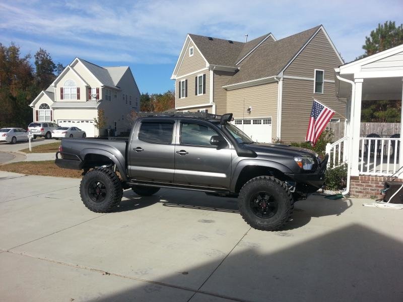

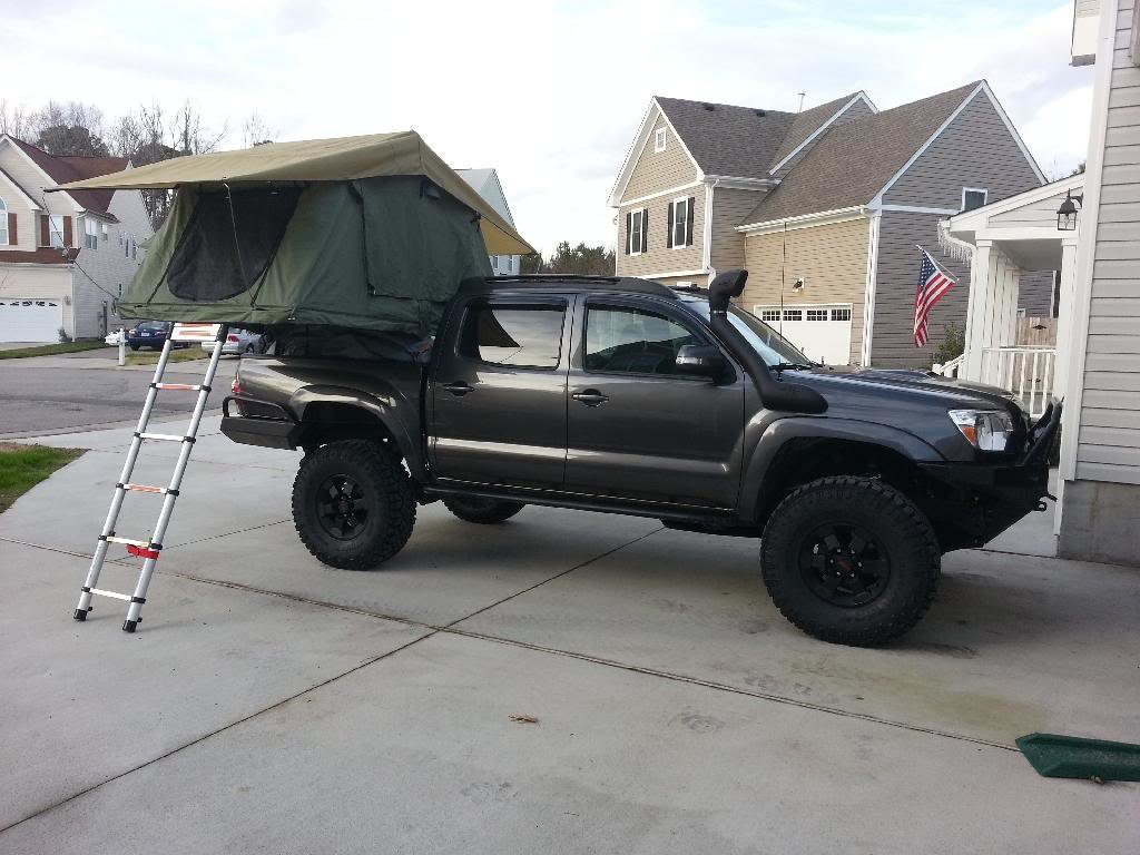

    Here's my build... Specs below pictures

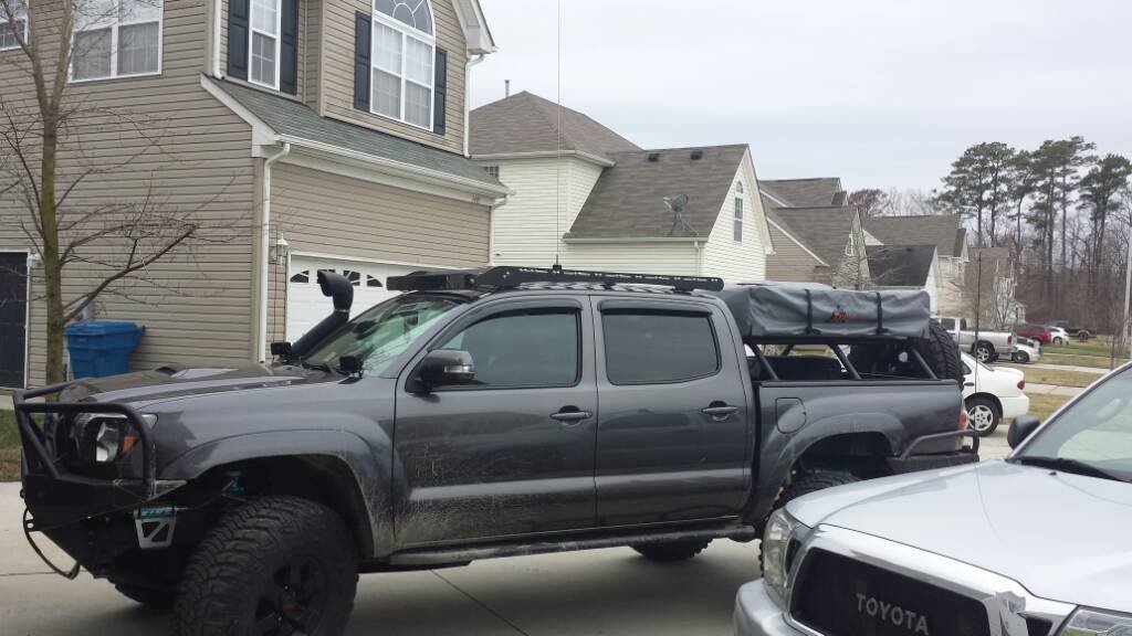

    Recent:
    Rustoleum removal mods...

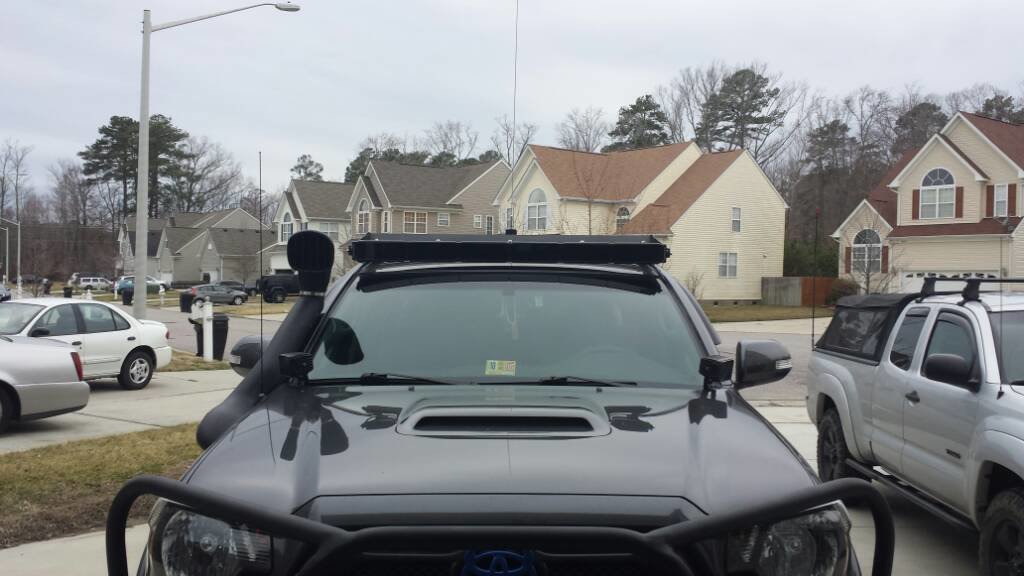

    Swapped out the CO2 for the ARB large Compressor and removed the mini compressor I was using for just the lockers.
    Installed the black Tepui Cover...much better looking now.
    Finally got around to installing all the party lights... rocks, bed and backup/dust.
    Swingout done and back on the truck. Just a little more wiring for the pod lights.
    Wilson 1000 installed on Prinsu rack and SWR is dead on 1.0 on all channels! Plus there is no hole in my roof....came out pretty good!
    XRC10 installed and winch solenoid relocated under the hood. Pretty slick setup with it strapped to the washer fluid reservoir.
    BHLM done...looks good with the MGM
    Jerry Can Mounts are done and ready to go on the swingout this Sunday when I have some help to support them.
    Beef'd CB Drop is in...
    Timbrens in...needs the 1" spacer...also cost me a very nice ratcheting breaker bar that also sets torque swapping out the plates!
    BHLM... yes sir I will!
    Rotopax 4 gallon on the forward bed rail.

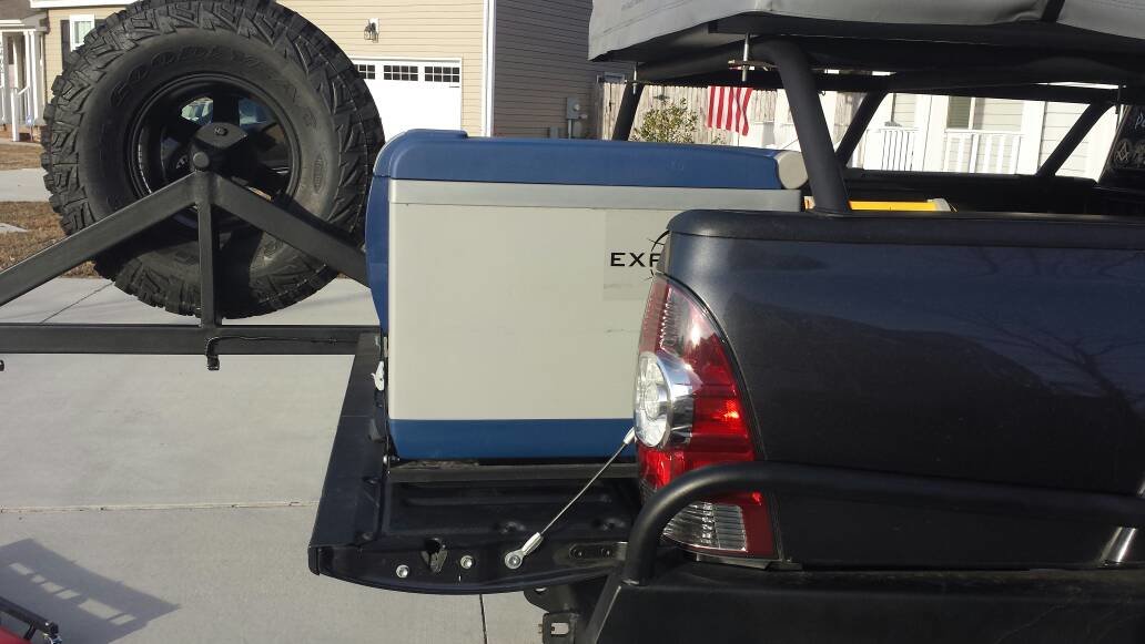

    Cold beer whenever I want. I hardwired it to run off one of the SPOD switches not being used. Very stoked.

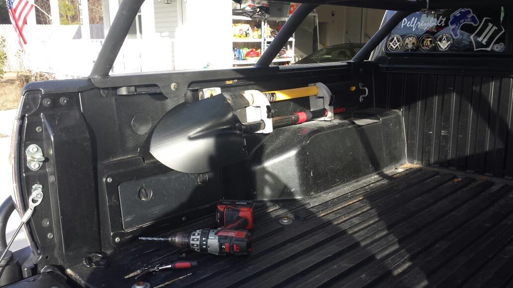

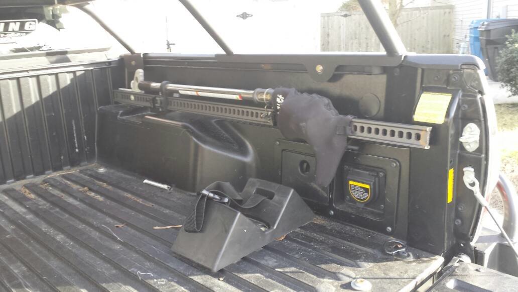

    Pelfreybilt HiLift and Shovel/Axe mounts installed. Worked out great and all the cubbies open and the power outlet are accessible with the 60" jack.
    Installed the 2 Plano Cases on the Prinsu.

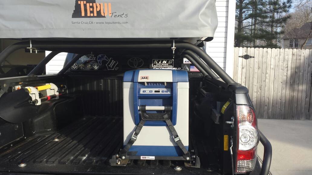

    Mmmmmmm Fridge...

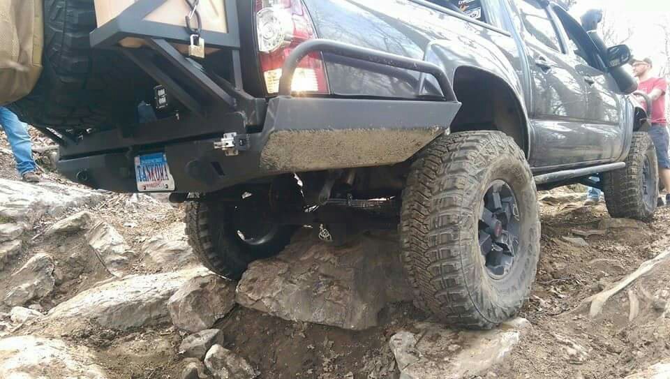

    Finally got a chance to flex her out...Need to work on the bumpstops...FML Timbrens are expensive!
    Got the winch all back together and spooled up. Loving my new black fairlead thanks to Steve down at Southeast Overland for that and the new chaffing guard.

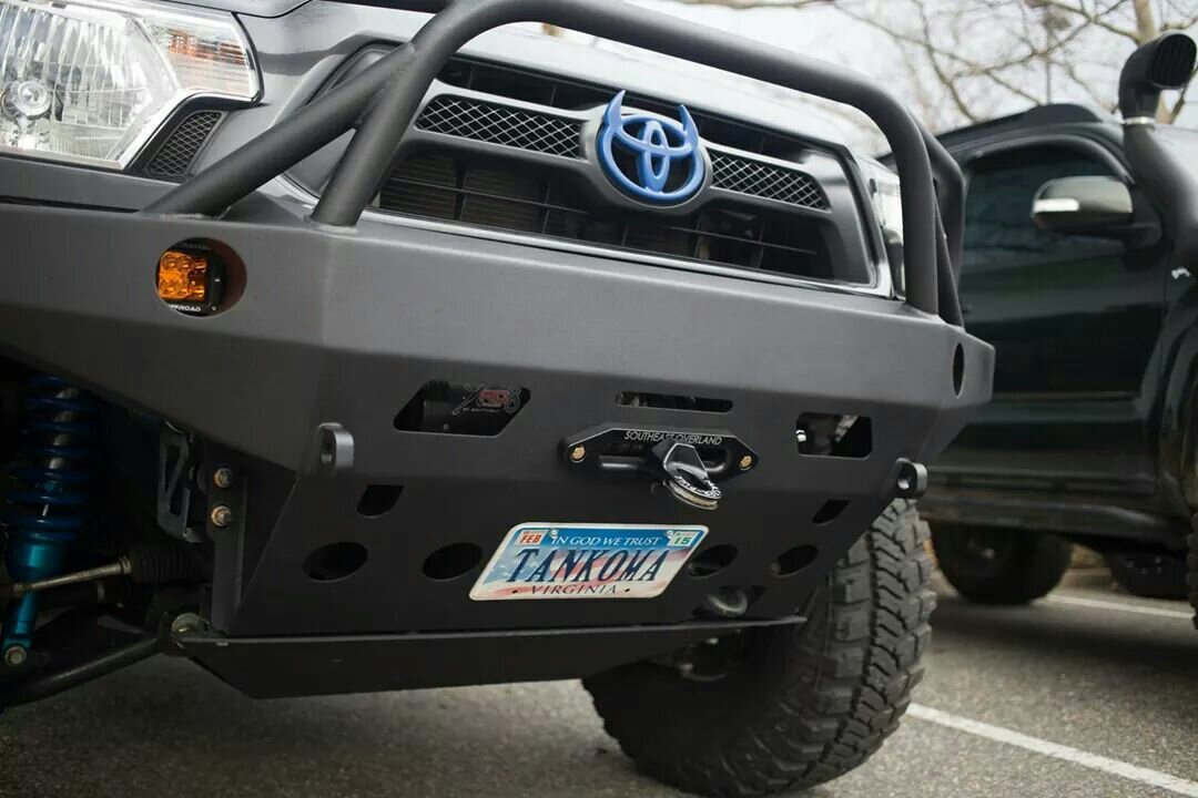

    Added the side hoops to my Pelfreybilt bumper. I love how it looks now. The center only had been bothering me for a long while. Also added a set of 3x3 18w Pods. Fuckers are brighter than my headlights...good thing I did them in amber instead of white.

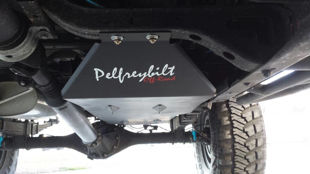

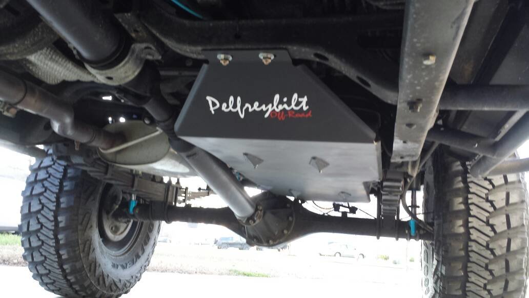

    Installed the Pelfreybilt Gas Tank Skid after welding in some bolts for it. Looked so nice I thought I should put an extra sticker on it.
    Overhauled the XRC8...I couldn't free spool it and the solenoid was totally corroded to the point of not working at all!
    Backup Cam relocated...works great.
    Ditch lights on. CB going somewhere else.
    Finally installed the flyzeye...I'm lazy.
    Tablet all mounted up and I dig this setup a lot.
    Swingout is painted and installed ...jerry cans to come soon
    Building the new swingout...bit more to do but coming along nicely!

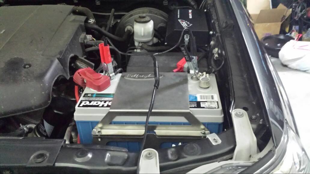

    Pelfreybilt Battery Tray and Group 31 Battery in.
    Prinsu on with the 50" getting some buffeting so I'm working on what angle is best. The light bars should be illegal...ohh wait they are.
    Driverside all done...
    Front end mocked up...gonna be awesome!
    12" King Smoothies on BAMF mounts are in...painted everything up nice and black too while I had it apart.
    Shoulda done this before they bent! Ohhh well.
    60" Hi Lift Extreme mounted. That is a big ass jack!
    Nice shot...
    35s are on!!!
    Airflow snorkel...
    New FJ Trail Teams Rims...
    She got a new ASS today!
    Ready for install! Just need to get some sheet metal out of the way!
    Shackles have been flipped! Fuck doing that twice!
    Spotted while on my way home
    Got the new camper shell back from painting...love it.
    Painted sliders, debadged, pin stripes removed, no more TRD bed sides and tossed in a set of LED fogs.
    Got the 255's installed. Look nice and my gas mileage is better than the 265s.
    Day after I bought her:
    2013 Double Cab Short Bed Sport 4x4 4.0 6 speed manual
    Suspension:
    Front:
    King 2.5 Remote Res Ext. Travel Coilovers
    700# King Springs
    Icon Tubular UCA
    Allpro Prototype Stock Length Uniball LCA
    Total Chaos Spindle Gussets
    Welded Alignment Tabs... do it before they get bent flat!
    Rear:
    Allpro Expo Leaf Pack
    BAMF Shock relocation
    King 2.0 12" Pro Race Smoothies
    Timbren Bumpstops
    Allpro U bolt flip
    ATO Shackle flip
    Rubicon Express XJ shackles
    Wheels/Tires:
    FJ Trail Teams Black
    SpiderTrax 1.25" Spacers all around
    315/75R16 Goodyear MTR/K
    Performance:
    4.56 Nitro Gears
    ARB Air Lockers Front and Rear
    Borla cat back chopped off at axle
    Airflow snorkel
    Crawford Performance Eco Block
    Diehard Platinum 31M
    Protection:
    4X Innovations Sliders
    Pelfreybilt Front Bumper
    Brute Force Fab High Clearance Rear Bumper
    IFS/TRANSMISSION/TRANSFER Custom Flat Skids
    Trailgear Diff Guard
    Exterior:
    Custom Ditch Light Mounts
    D2S Retrofit
    Vent visors
    Bed Rack
    Tepui Kukenam RTT
    PRINSU Roof Rack
    Pelfreybilt Axe/shovel mounts
    Pelfreybilt HiLift mounts
    Dual Jerry Cans on Homemade Swingout
    Wilson 1000 Mounted to Rack
    Browning 2M whip antenna
    Interior:
    Clazzio Leather Seats
    Panavise Mount
    Proclip Samsung Tab Holder
    Galaxy Tab
    Cobra 75 CB
    Kenwood 281A 2M Ham
    Flyzeye Light
    Misc:
    SPOD Electical Managment
    ARB 50 Fridge and Slider
    Sidetracked Offroad 50" LED Light Bar
    LED Pods all over the place
    Smittybilt XRC10
    Winch Solenoid Relocated under hood
    Southeast Overland Black Fairlead
    ARB Large Compressor for OBA
    Fog Light Anytime Mod
    Arb Tire Deflator
    60" Hi lift Jack Extreme
    Straps and shit
    What Next?!?!?!...

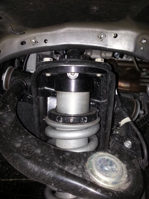

    how much lift is in the back? and ou have 2.5" lift up front right?

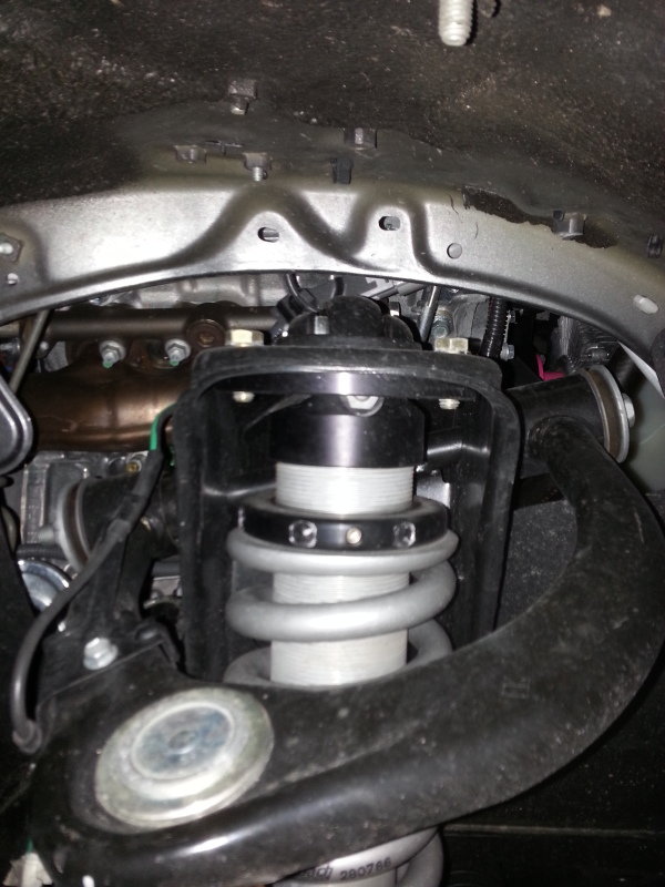

    The wheelers 3 pack with my overload netted me about 2" of lift and a softer ride.

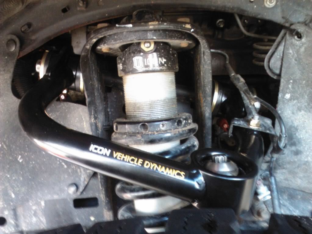

    In the front I am running a 2.5 coilover set at 2 1/2"s of lift until I decide which UCAs to buy then I will set them at 3"

    You might want to order the 700# springs now and install them when you do your bumper and winch...or the ride is going to be a bit rough because you will be cranked down quite a bit...Need 2 of THESE at 700 lbs....or you can get the Eibach if you want the "COLORED" ones...

    Currently I am running the 600# eibach springs. Just picked up Ryans old 650# to toss in there if I need to crank a bunch. Think the 700# springs are necessary? I have seen some folks running with 600# springs and plates but I have no idea how much preload they had dialed in.

    :eek: funny, because he replaced them with 700# because he was sagging with them from JUST his allpoo bumper front skid plate :facepalm: I would absolutely sell them and get the 700# springs. This picture is from HIS build thread. can't believe he sold you those....smh
