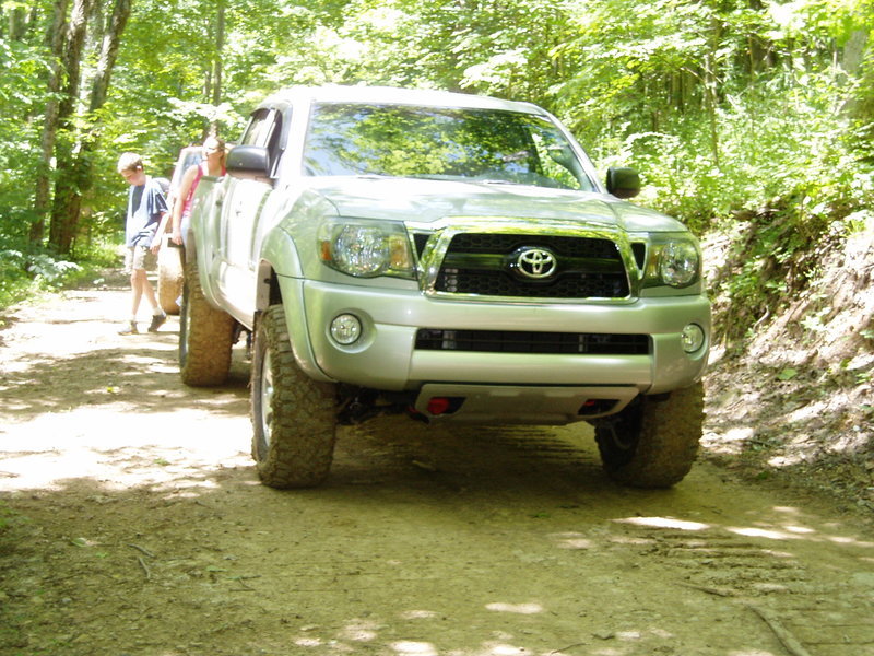

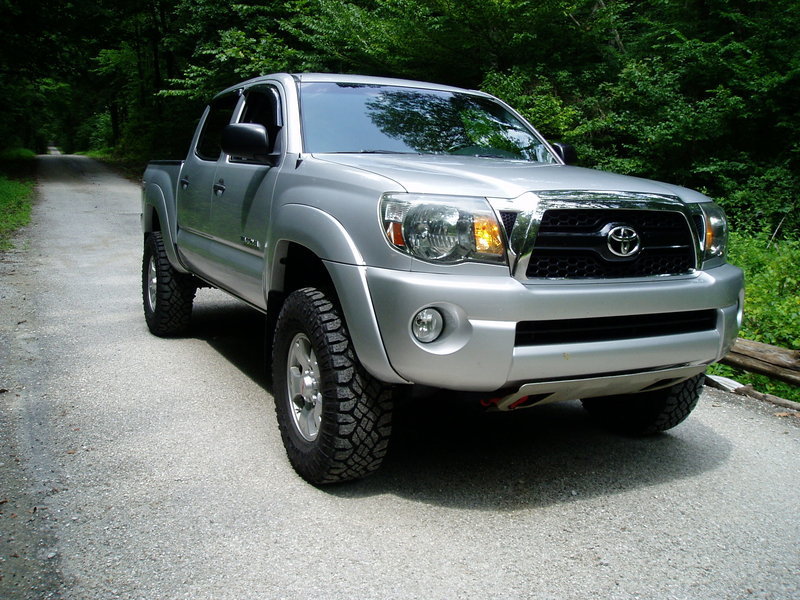

    You happen to have a picture of what your truck looks like with those duratracs? I seem to be in the same predicament as others here when it trying to put 285's on stock wheels but needing to figure out exactly what spacer to add to avoid rubbing.

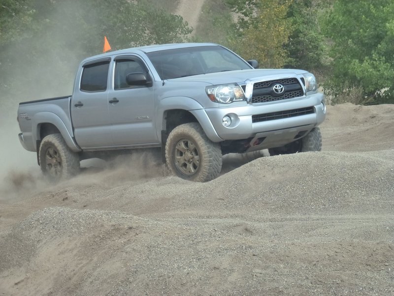

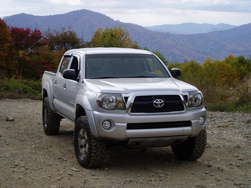

    2011 DCSB, TRD OR, 5100's, 885's 285/75r16 Cooper STT PROs.
    13937753_10107521970697289_1931633486973093650_o.jpg blackmountainbackground.jpg P1010001 (2).jpg P1010013 (1).jpg
    Here's the best pictures I have at the moment.....Not sure if they really show the tires well enough to see what you want to see....

    They look pretty good actually for being 265's, and Sweet looking truck too. Thanks for the pictures, I appreciate it.

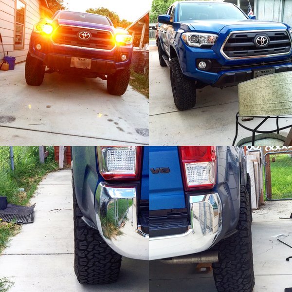

    2016 Toyota Tacoma SR5
    Maxtrac/Bilstein suspension 16x8 Pro Comp 69 315/75/16 Dick Cepek Morimoto Profile Prism RGB Halos & Demon Eyes
    @abcdefgHI808

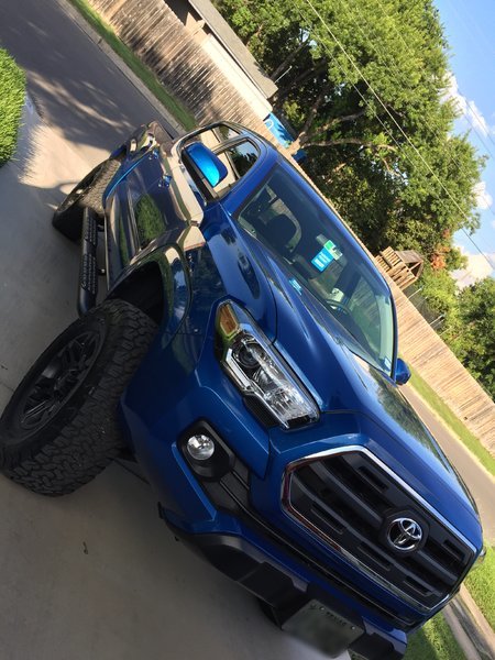

    2wd, 98% hwy driving, 2in front spacer only(rear suspension not touched), 1.25 spidertrax spacers (to clear UCA), 285/70/17 BFG KO2 w/stock wheels, air dam removed......only rubbing I get is in reverse w/wheel locked (which is hardly ever). Tire is very beefy enough for hwy driving (saving mpgs) and light trail rides. Mud tires will kill your mpg. Get a beefy All-Terrain that'll get all your needs done. Let me know what you think.

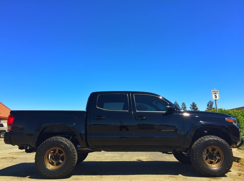

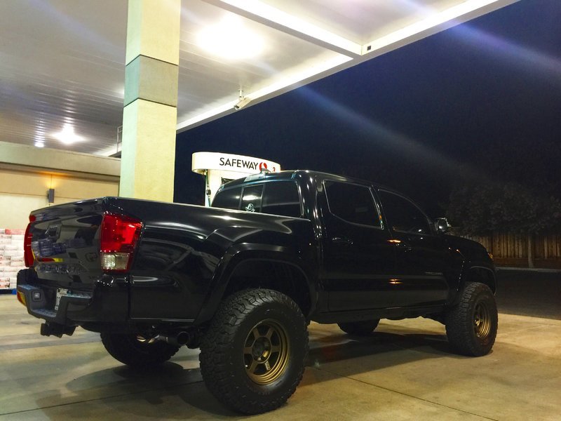

    I have a 3in lift and I'm running 295/75/16 size tires on my Volk te37s wheel specs are 16x8 0 offset.. I had to do a CMC in order to get rid of the rubbing. Actually putting on a spacer would have brought the wheel out more causing it to hit the bottom edge of the fender flare.. I didn't need a spacer to clear the UCA. Under normal driving conditions I had some very slight rubbing on the frame when the wheel was at a 3/4s turn and the suspension was flexing... In normal driving conditions it wasn't that big of a deal. Of course if your going down light trails or any type of off roading you will definetly need to do a CMC.

    Everytime u post your truck it makes me want to buy Volks. Stop posting it...LOL JK! :thumbsup:

    Love it tho bro. That'll be the last thing on my list when my truck is done with mods or for HIN next year...LOL!
