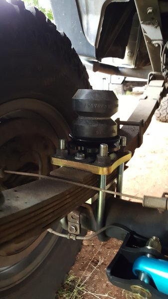

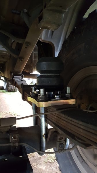

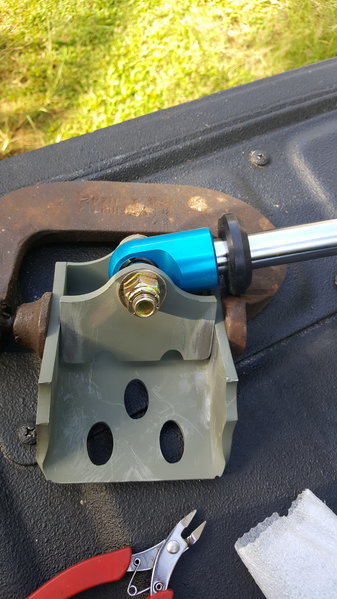

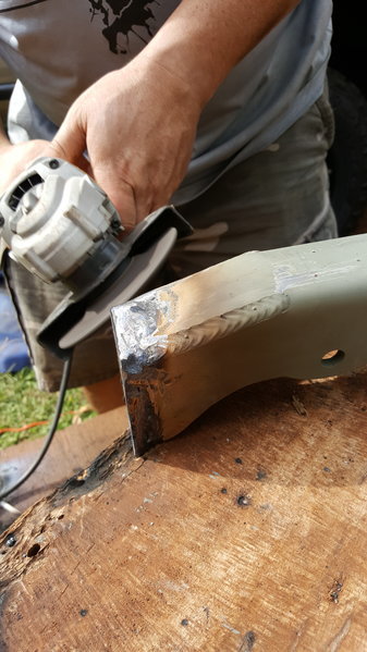

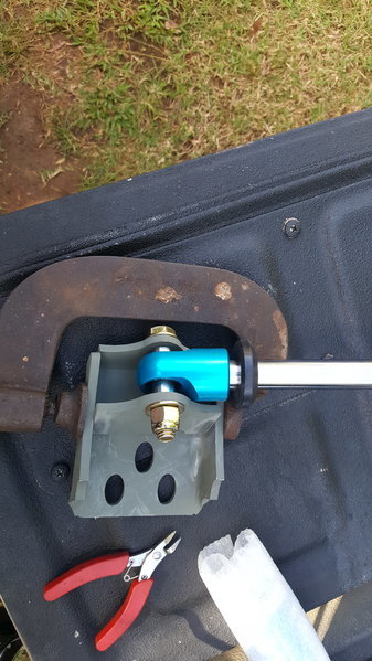

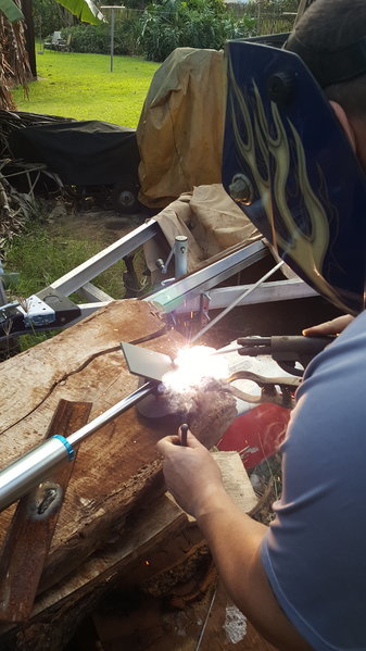

    Ok guys I still owe you installed pics...but for now. So the process went like step one we welded the lower mounts together to get the spacing of shock plus misalignment spacers *tip* when welding the lower tab add a washer.....so it should be washer, misalignment spacer,shock, misalignment spacer inside the tabs and tack it...then remove shock and blast the weld.....makes it so much easier to put the shocks in after its all welded up...figured this out after the first one:facepalm:
    Next step was to remove shocks and you will have to cut and grind down the stock upper shock mount on the drivers side to fit the frame plate that the cross bar gets welded to.....sorry no pics. Next thing we did was install my U-Bolt flip kit......BTW we did not remove the bed...my friend said no need sooooo he was welding not gonna argue with him :D

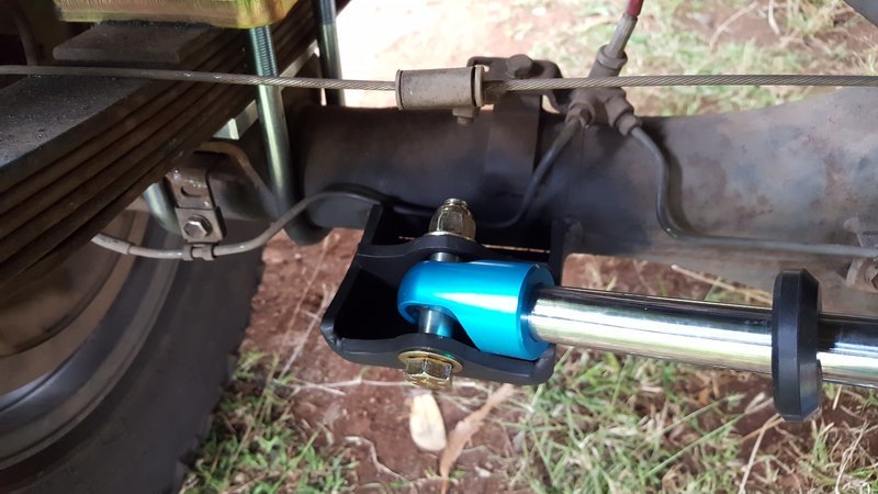

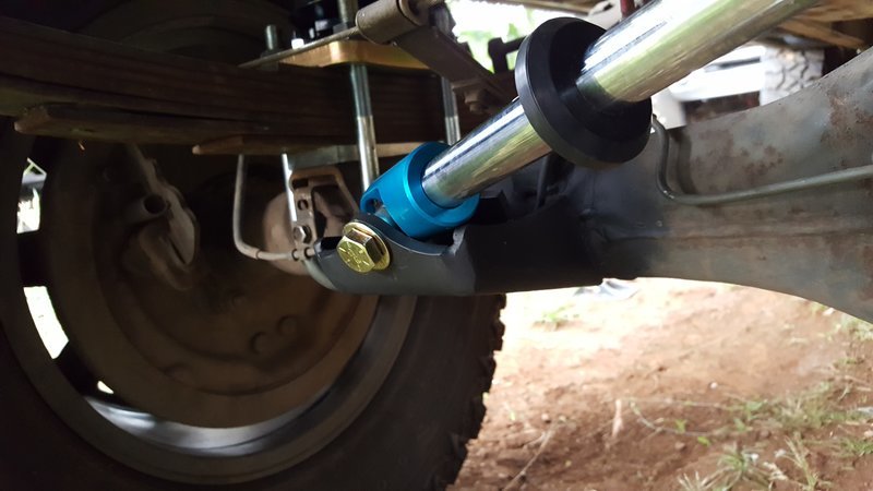

    The next thing we did was weld the lower shock mounts to the axle.....and yes I know you see them in the above pics but I didn't take pics of the u bolt flip until after.....*tip* we used the raised ring/line on the axle to align the inside edge of the shock mount this way they are symmetrical and also needed to do this to clear the brake lines that run along the axle

    Next up was to figure out the angle of the shock in relation to upper and lower mount....once that was done we knew where the frame plates needed to be and welded

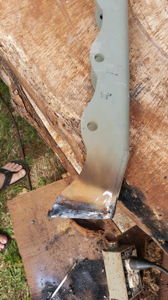

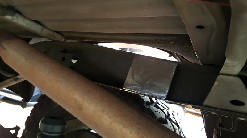

    Now this is where shit started to get not so fun......once we got the frame plate placed in the frame and before tacking we held the crossbar up and realized there was a 1/2" gap so a 1/4" on each side....no matter how we would of put the frame plates....sooooo we now had to weld a 1/4" "cap" on each side of the crossbar.....luckily my friend had some old leafs laying around, so we cut the ends off and the width and the angled cuts on the end of the leafs matched up perfectly
    Once we got through all that crap we figured out shock angle one more time and tacked in the crossbar. All welded we then finalized travel of the shock and this is where I owe you pics:anonymous:
    But as of right now my shocks are /\ .....I have no idea how someone could run a 12 under there without some expo leafs and a lift shackle.....I am going to get a shackle to put me up a little bit so I can move my shocks outboard one mounting location
