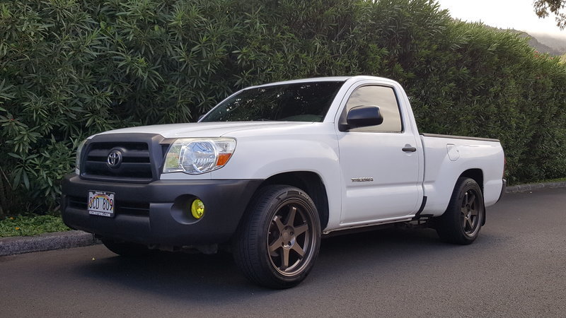

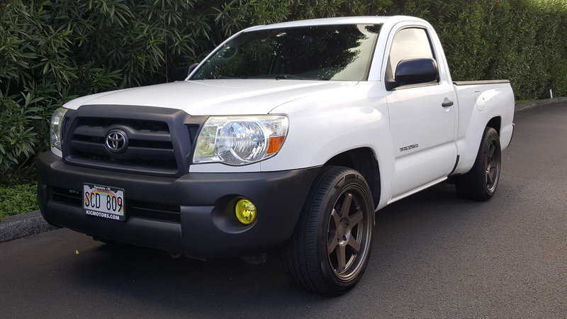

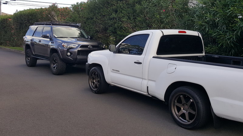

    Ask and you shall recieve.....Mahaloz to @bullaculla :bowdown::cheers:for the assist today....BTW don't ask us to ever help lower a truck :rofl::crazy:
    20170612_144718.jpg 20170612_144732.jpg 20170612_144748.jpg 20170612_144808.jpg

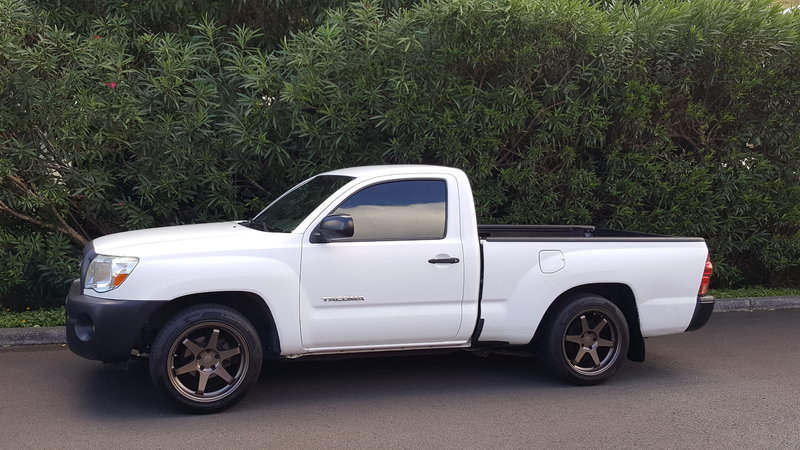

    Specs for the DD.....if anyone cares
    Wheels:
    ESR SR07 18x9.5 +22
    255/45/18
    Front:
    XII Performance drop springs
    X-Runner Billstein's
    Rear:
    Streetacos 3" Tapered Offset Pin Blocks
    QA1 Adjustable shocks
    Low pro bumps
    Pretty basic and wouldn't consider it "low" by any means but takes away quite a bit of the horrid factory fender to wheel gap and still rides nice.....probably better.

    Reminds me of my old Mazda B2200 I had in the 80's. Dropped and looking good! Except your wheels are legit... Lol. Looking bomb bro!

    :laughing: that was different for sure! The whole thing was so alien to me.

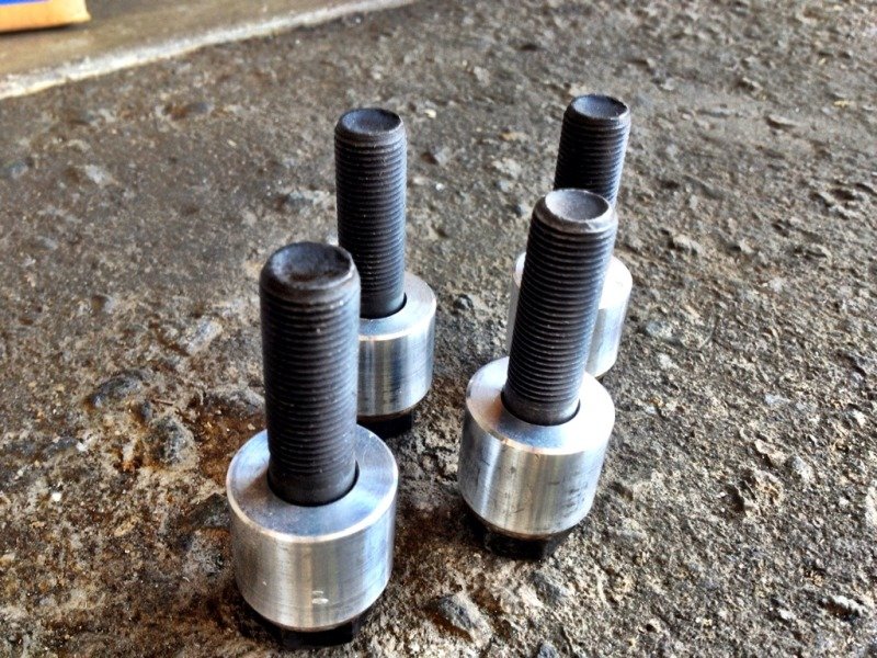

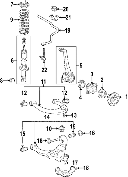

    Paging @bullaculla..... I may need to see about getting some of these made if possible and whenever in the future you have time and of course I would pay ya...thinking I need the front to come down 1/2" these are spindle spacers and no one makes them anymore...but the hard part is I gotta figure out what size bolt it currently is and find one longer
    They get installed between #5 and #18 on this diagram
    Maybe even a little more than 1/2" but gotta find the bolts first

    Sure man. I have some cro/mo steel about that diameter laying around.

    Oh that's super duper strength....the guy that use to make used aluminum
    Gonna pull a bolt maybe tomorrow and see if I can find a longer one at Home Depot or lowes

    i see what you're saying now.
    so i wonder if this could space it out enough to help a bad lower bj angle on a lifted truck

    No way, don't do that on a lifted truck. If your LBJ angle is bad, you either have it lifted to high or you need UCA with a uniball (like total chaos....etc)
