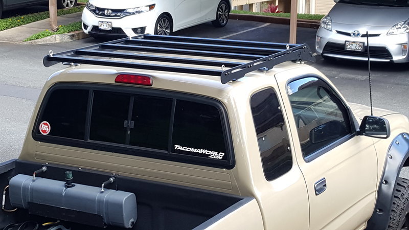

    Man, I want one so bad. I see two pelican rifle cases sitting up there across the cab just perfectly... Ideal for spares and recovery gear :headbang:

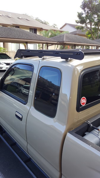

  11. Nov 13, 2016 at 8:37 PM
    #151
    LogCabins
    LogCabins [OP] Well-Known Member
    Apr 30, 2014
    #128878
    2,310
    Robert
    Oahu
    99 SR5 3.4L 4WD
    So when I got home today and parked my neighbor asks..."Robert, did you use your brakes, I noticed your brake lights are not working" :annoyed: So after checking my bulbs (good) checking the fuse under the hood (bad, had popped) replaced fuse and it popped right away...so must be the brake light switch behind the pedal. Ran to Oreillys changed that, replaced fuse and it popped again (WTF)...got under the truck by the tail lights and figured one of the crappy wire crimps that the PO had used must have grounded out a wire....changed all those and fixed the wiring, changed the fuse and......popped. So after some cussing and head scratching I started thinking I just drilled 10 holes in my roof maybe I drilled a wire running to the third brake light.....sure as shit that was the problem!!!! Oh well at least it's fixed and I have brake lights again :rolleyes:

  13. Nov 13, 2016 at 9:04 PM
    #153
    LogCabins
    Apr 30, 2014
    #128878
    2,310
    Robert
    Oahu
    99 SR5 3.4L 4WD
    Nope...I didn't totally mangle the wires just nicked them when drilling thru, just cut and connected them with a good crimp and all brake lights are working now

    Shit didn't even see the tag. Looks good man! I think the number is up to 4ish. Welcome to the club of Prinsu First Gens! :cheers:
    How was the install?

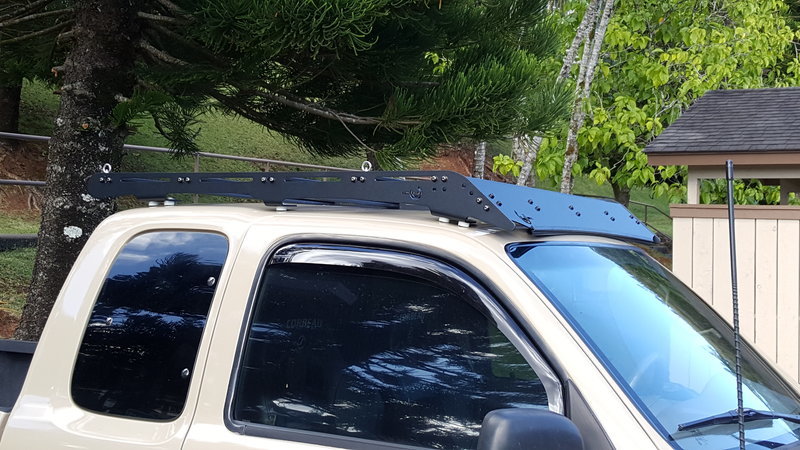

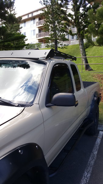

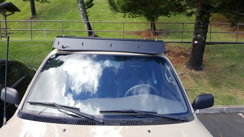

  15. Nov 16, 2016 at 9:05 AM
    #155
    LogCabins
    Apr 30, 2014
    #128878
    2,310
    Robert
    Oahu
    99 SR5 3.4L 4WD
    No worries....not to bad, except where I drilled and hit my third brake light wire so had no brakes for the day until I figured out that's what happened :anonymous: Those bolts he supplies are Waaaaaaay to long, and cheap broke two of them during install. Need to hit Home Depot and get some shorter grade 8 hardware...besides that it wasn't to bad. Took me about 4 hours start to finish by myself. Love the look of the rack, need to put my awning on with the brackets and get some pics
    Thanks again for all your help and words of wisdom!!!! Definitely helped

    Yeah I found that out too, ended up using my buddies bolts. Glad you got it figured out, did you add silicon to the holes as well?

    Yes silicone when I put the the rivnuts and then put it on after when I put the spacers on, no leaking yet :fingerscrossed:

    Awesome! Glad it works, I haven't had any water in mine either. Every time you take it off for whatever reason be sure to add silicon again just for peace of mind

    Definitely....probably will clean off the silicone and apply fresh stuff a few times a year, just for peace of mind
