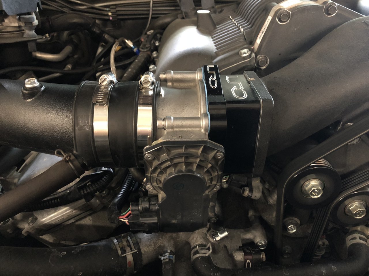

    70mm FJ throttle body with URD adapter.
    When combining 7th injector and throttle body adapter you have to extend the coolant lines to the throttle body.
    When changing throttle bodies, disconnect the battery for several minutes. This causes the ECM to re-learn throttle valve angle for proper idle speed. If you install a larger throttle body and don’t disconnect the battery, the truck will idle high. In my case, it was 1100 RPM.

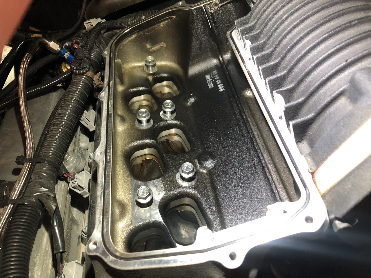

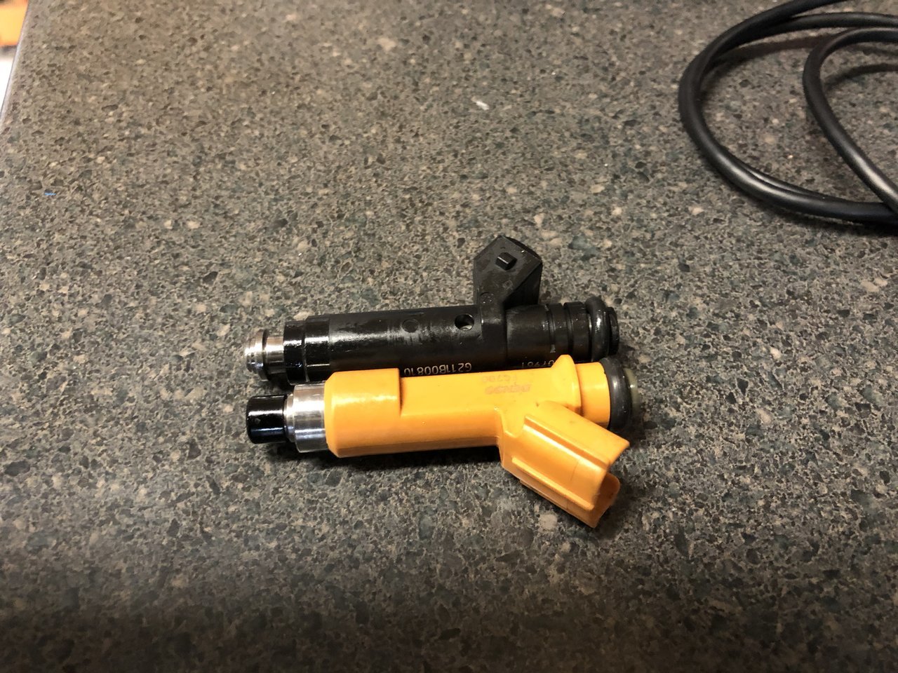

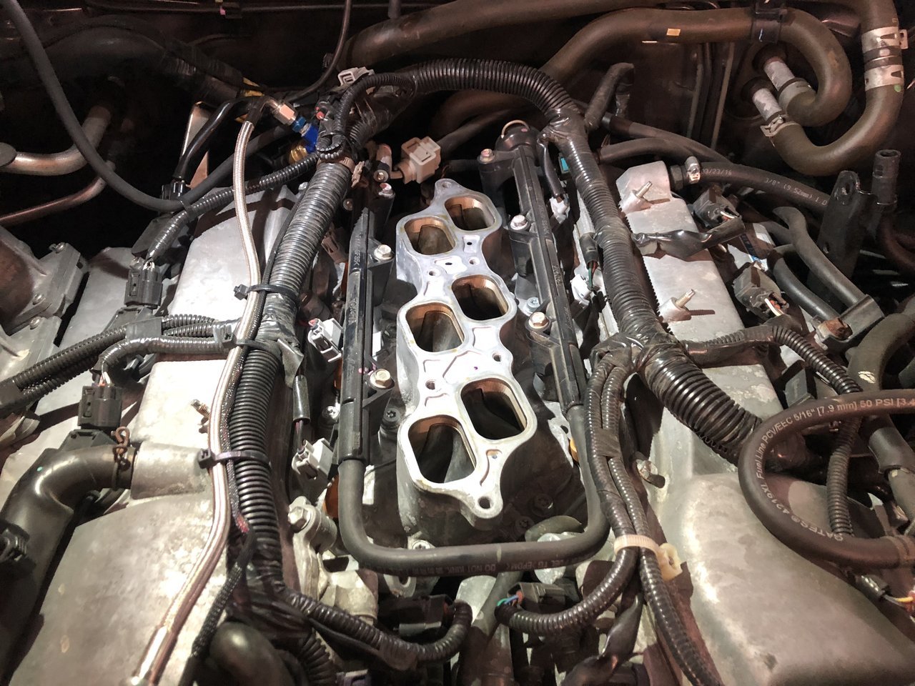

    Upgraded from the TRD 455 c/min orange injectors to Siemens Deka 640 cc/min injectors. Moar fule.
    Intake ports fairly clean. Maybe the catch can helps with that. :notsure:
