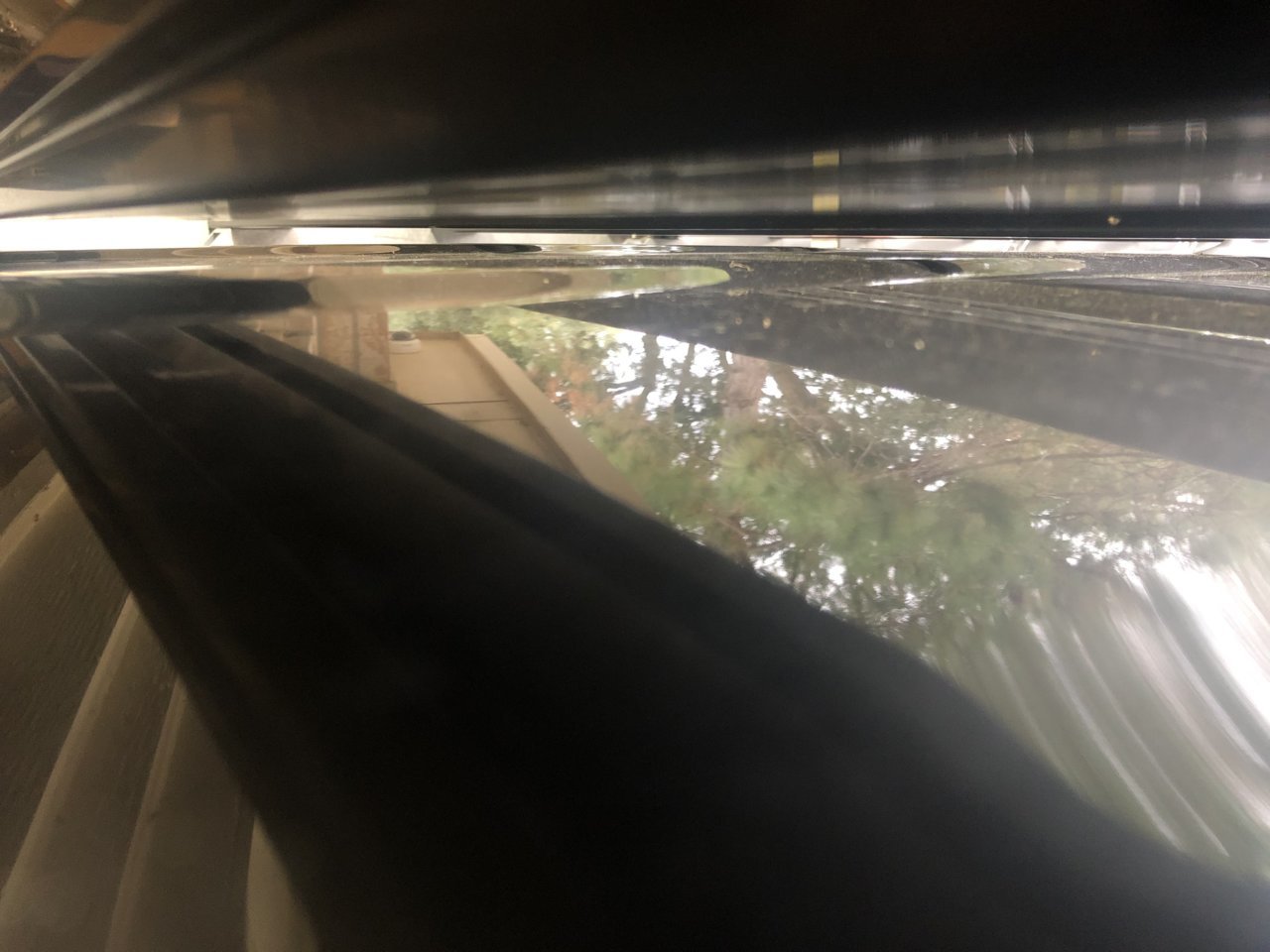

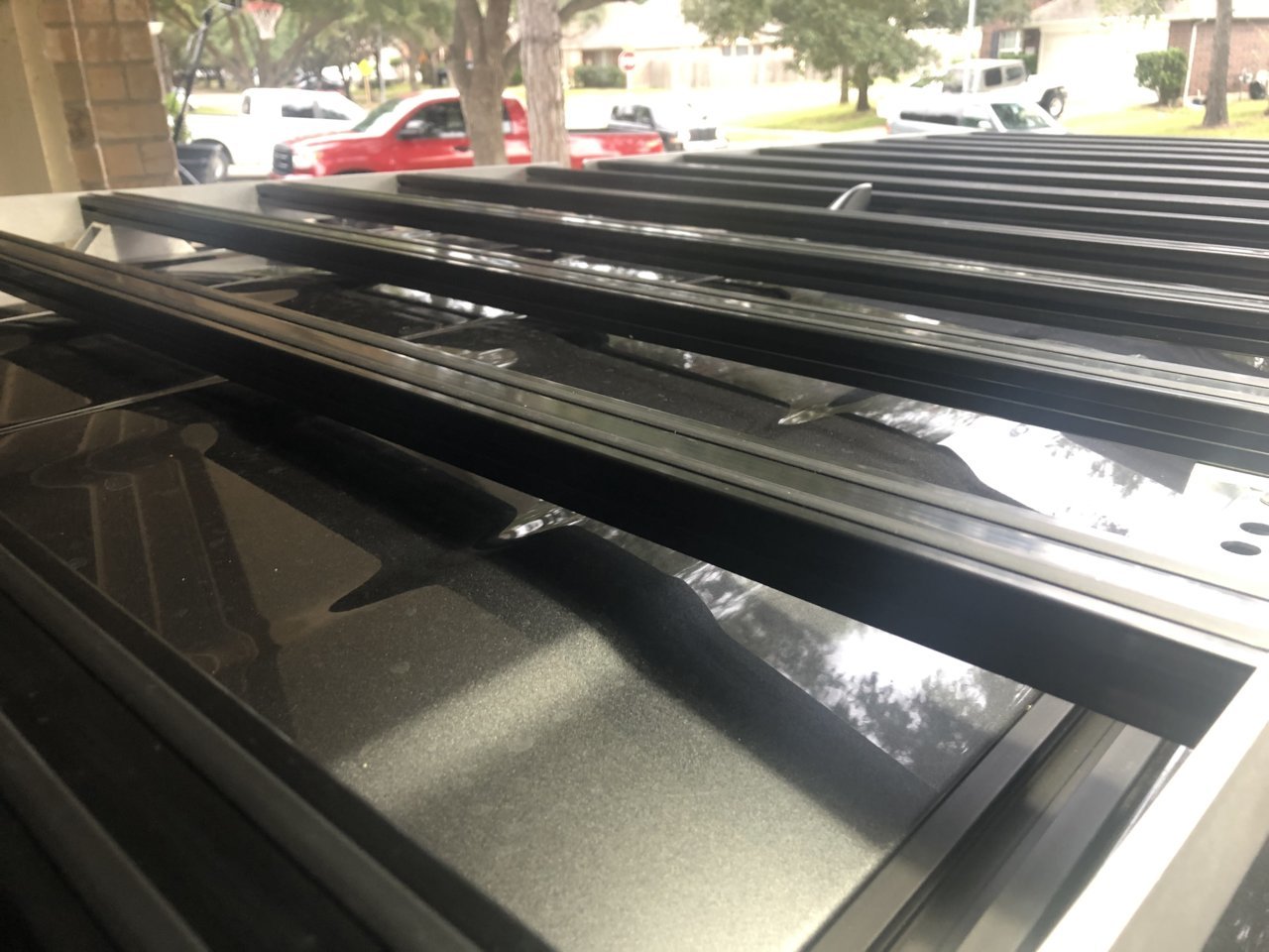

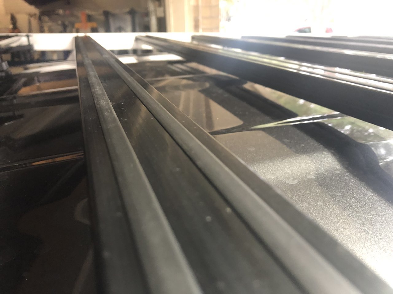

    I’ll admit I’m lazy and I don’t wash my own truck. I pay a monthly fee at a local full service wash place for unlimited washes. One of the things I’ve noticed is when I get the truck washed, the first corner I take, water pours out of the channels in the cross bars.
    So I ordered inserts for the channels. Two per bar. I little cutting to length with a razor blade and they tap in with some light taps of a hammer.
    I’ll see if it makes a difference. If nothing else, it should make the bars a little more aerodynamic.
    28AB9E77-67C3-44C6-A6E8-D33FE2B682F6.jpg 3ECBACDF-1D8A-4C9E-81F1-6DFBD6DF5207.jpg

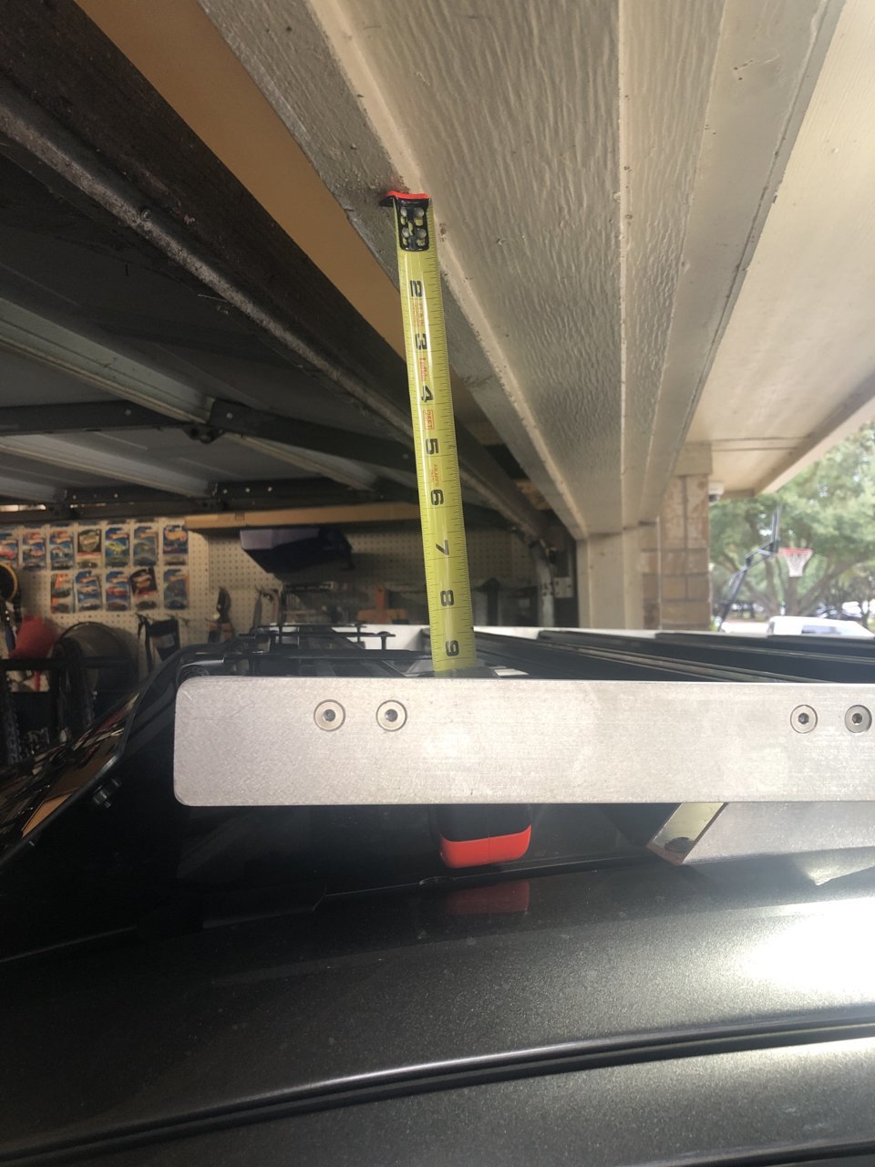

    The bars look close to the cab in the pic, but they’re about 1/2” to 3/4” away. Tried to make it hug the roof as much as I could in case I park it in a garage.

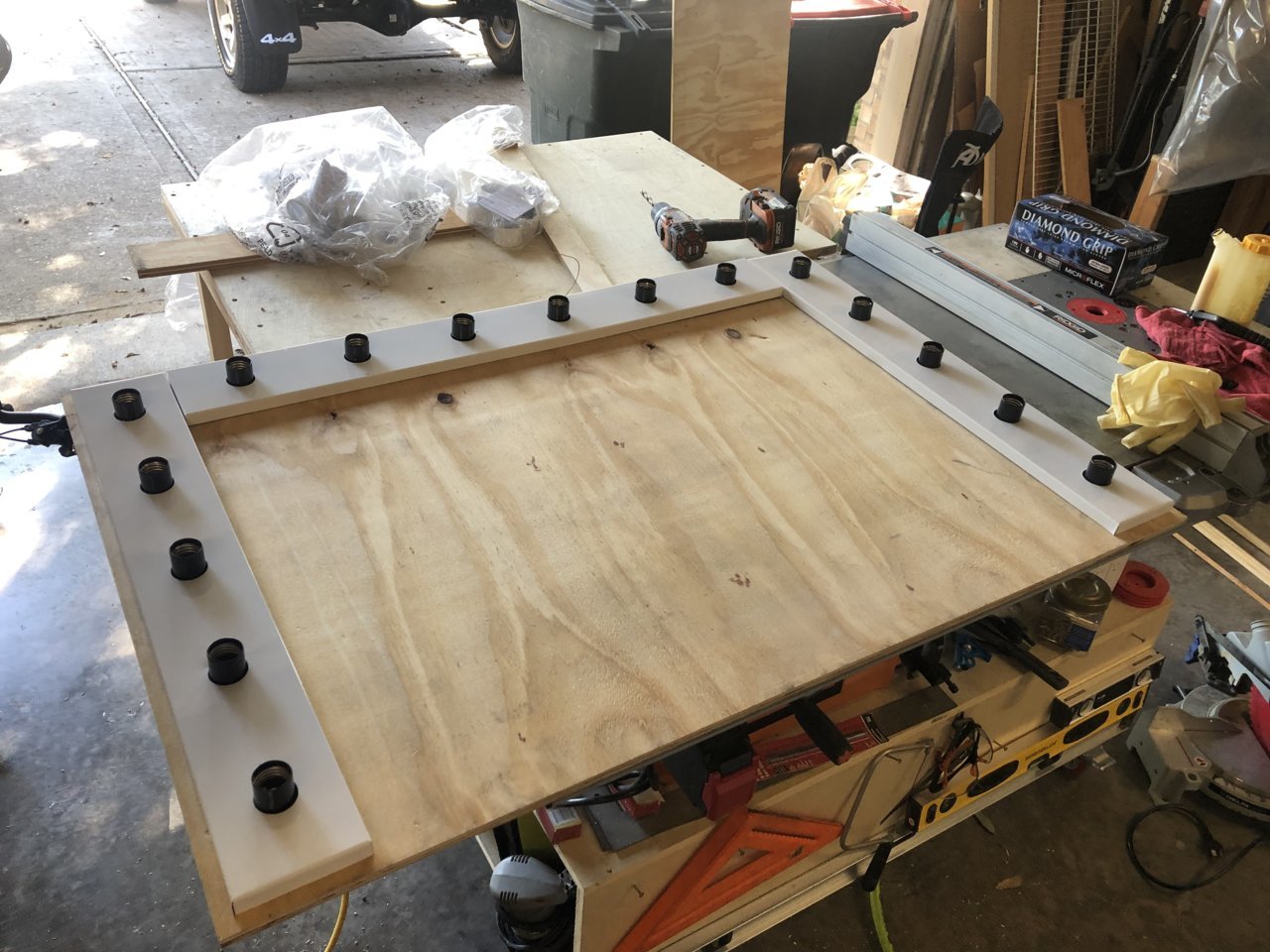

    When you have a beautiful 14yo daughter who needs a space to do her makeup, these are the types of projects you spend your Saturday on. (Well, this.. and cleaning your guns)

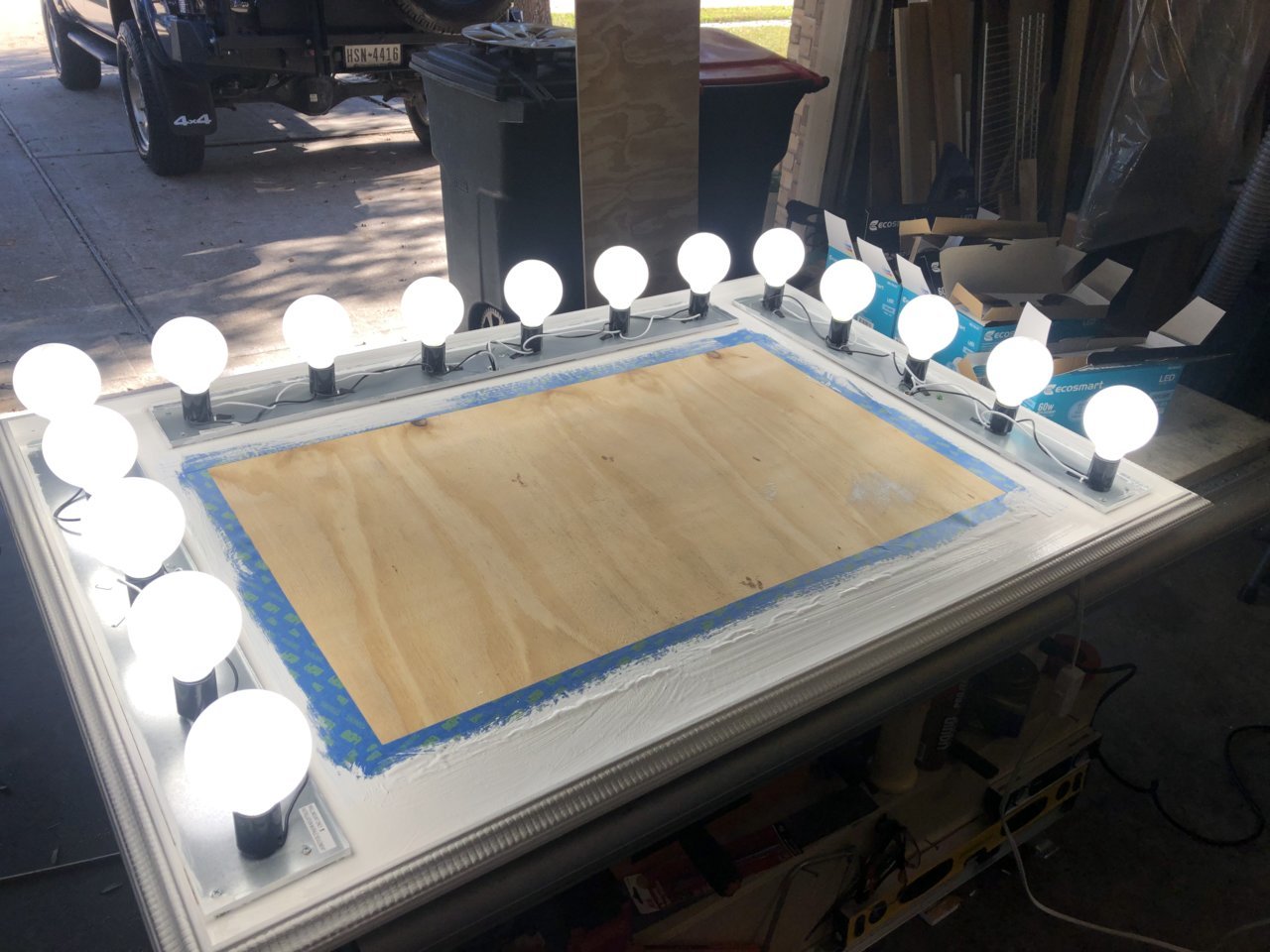

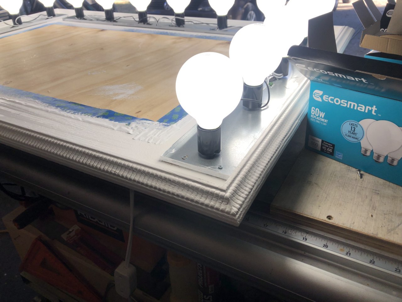

    Testing out the lights while the paint dries. Bright AF! :eek:
    Added a little trim at the edges. Not my best work, but it can out pretty good considering the time I have invested in it.

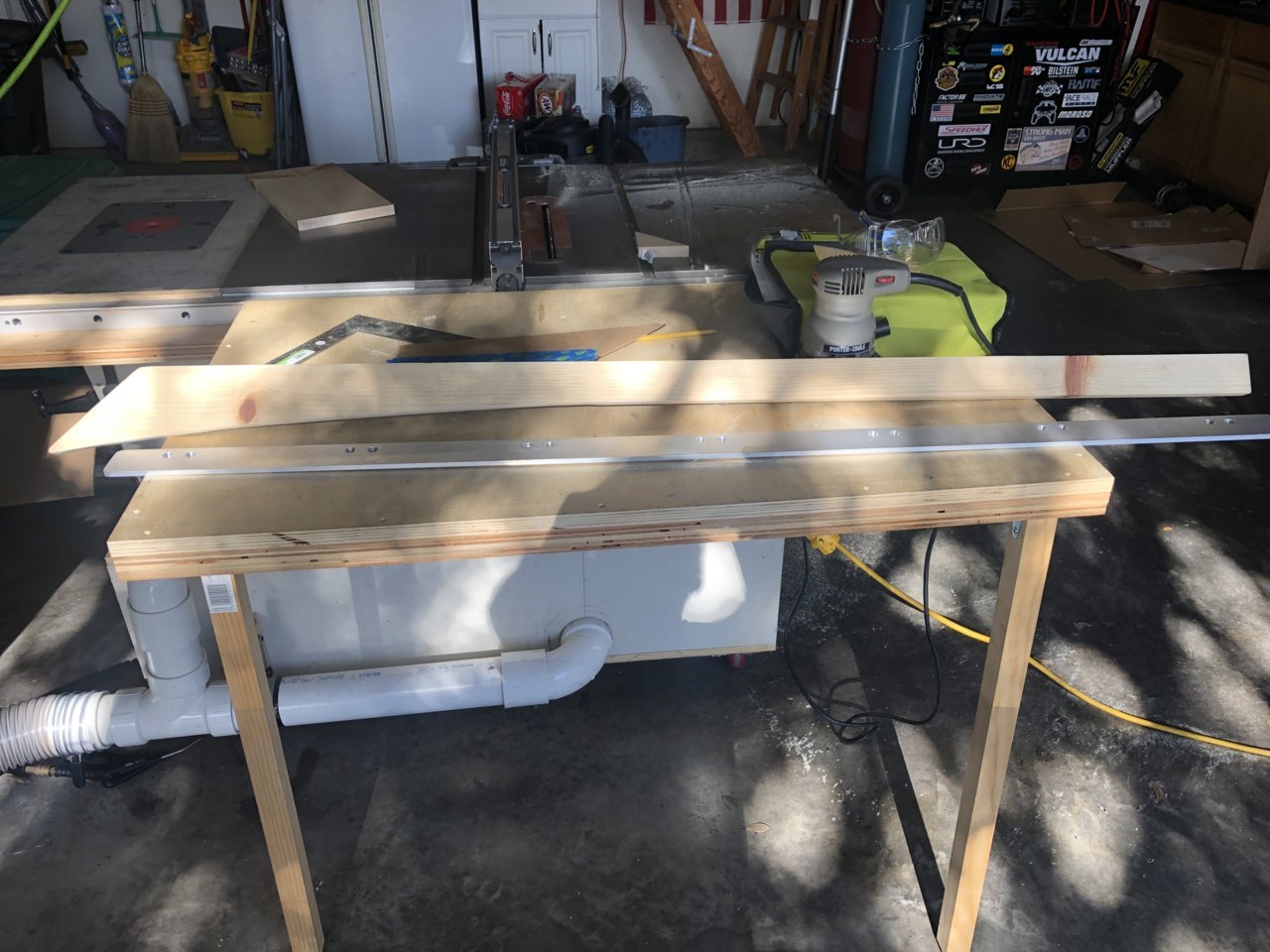

    LRA fuel tank is at the YRC terminal. Called them and they said the terminal is closed Saturday but open Sunday. So hopefully I can pick it up tomorrow.

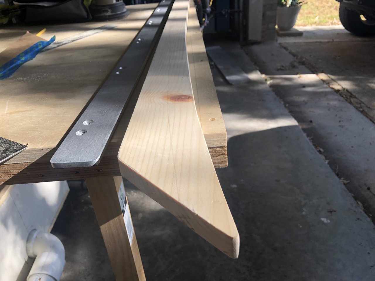

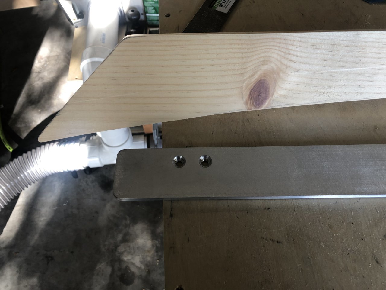

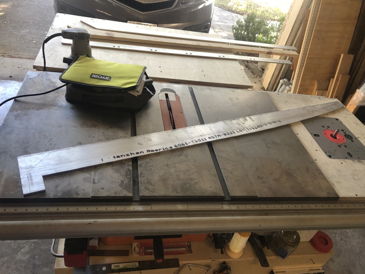

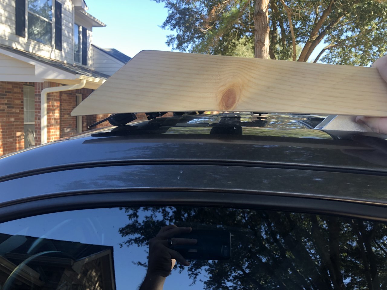

    In the mean time, I’m working on new side plates for the cab rack. I don’t like the Inno wind deflector, so the plan is to make my own.
    Made a wooden side plate to then transfer to aluminum stock with a flush trim router bit. I think the gradual curve is decent for free handing with a jog saw and then sanding it by hand.
    7ABAB65E-4156-48D5-A102-9AF904F0D909.jpg 5DA82D88-8C80-4B5D-B005-668F55E16D21.jpg 564955F7-1F60-4576-854E-78C8BD923A30.jpg
    Position isn’t exact but gives the general idea:

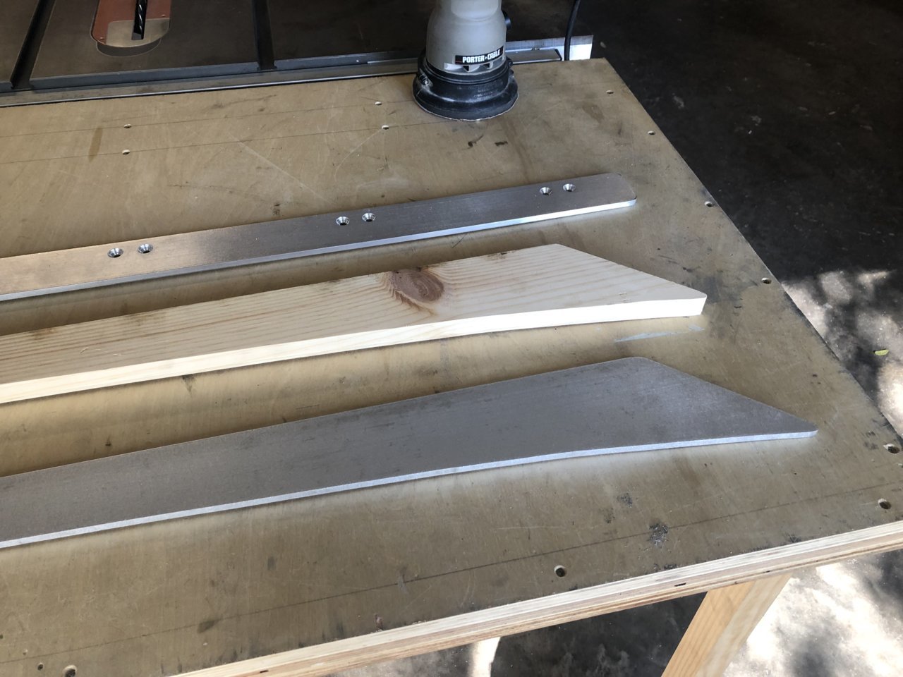

    First one is cut out. Now I need to copy the copy. Then get to drilling some holes.
