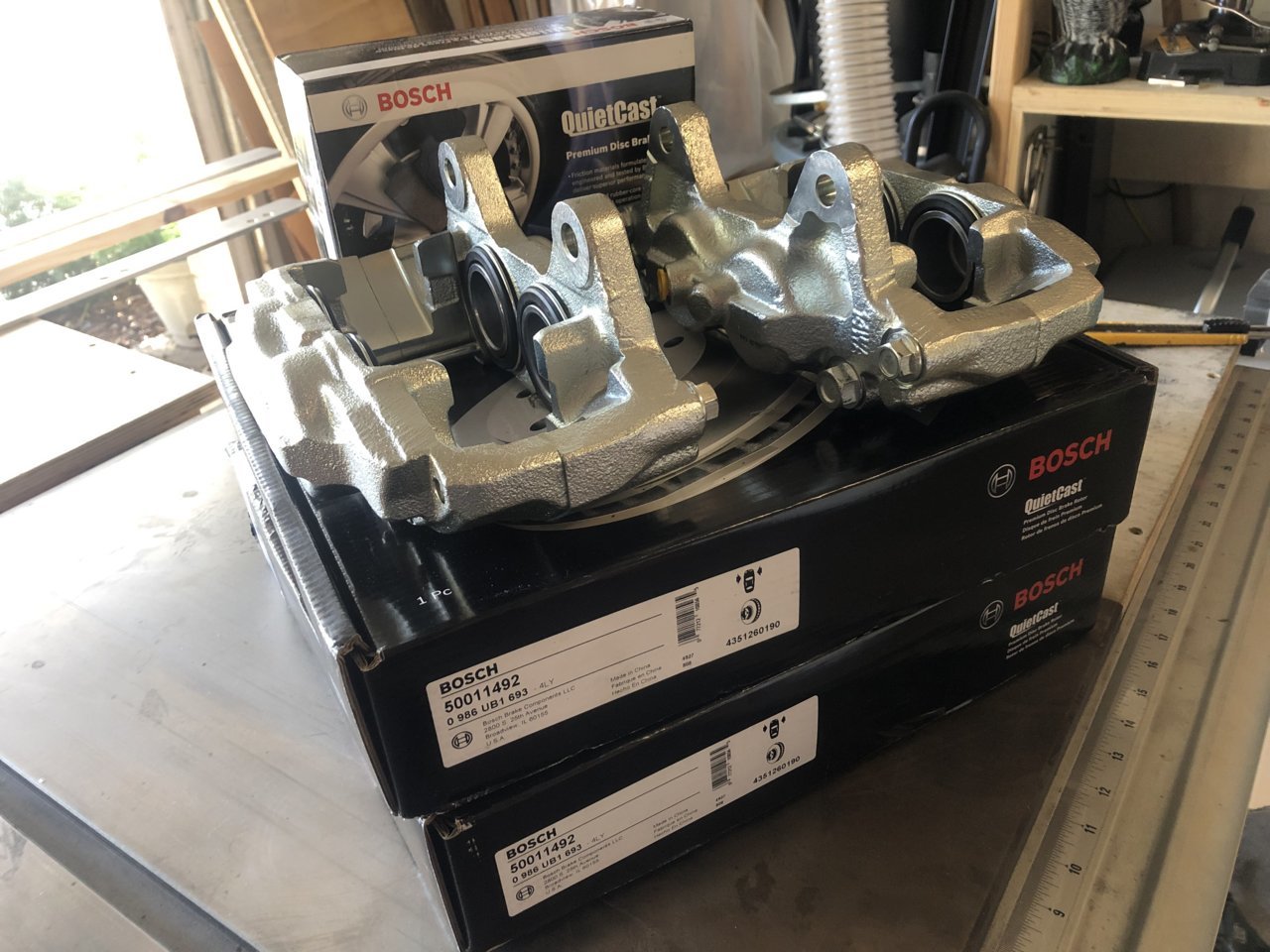

    2010+ 4Runner / 2010+ GX 460.
    Bigger pistons
    Bigger/thicker rotors
    Same pads
    Short of BBK ($$$) I think it’s the best brake upgrade we can do. I might do the rear disc conversion later on. I think @Torspd has had the rear disc setup since forever.

    I am running this setup, you will be pleased with it I think.

    Will the bigger calipers affect clearance on any wheels?

    I think you have to run 17” in order to clear the calipers.

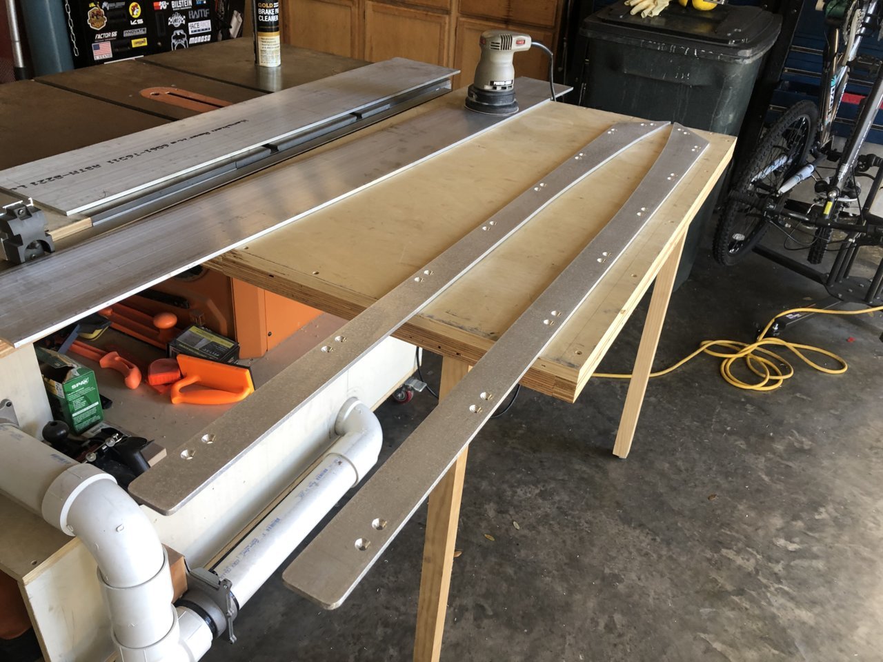

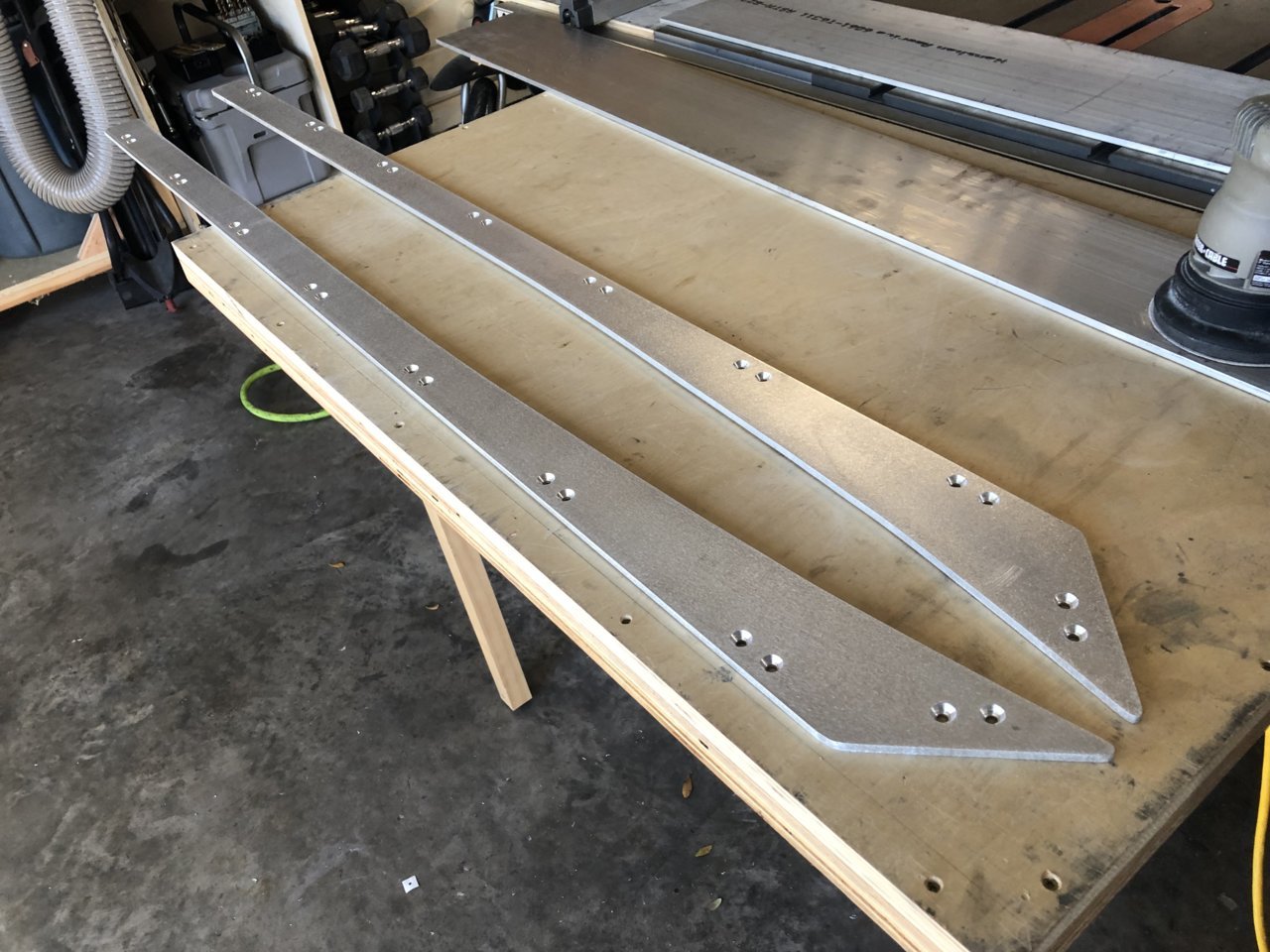

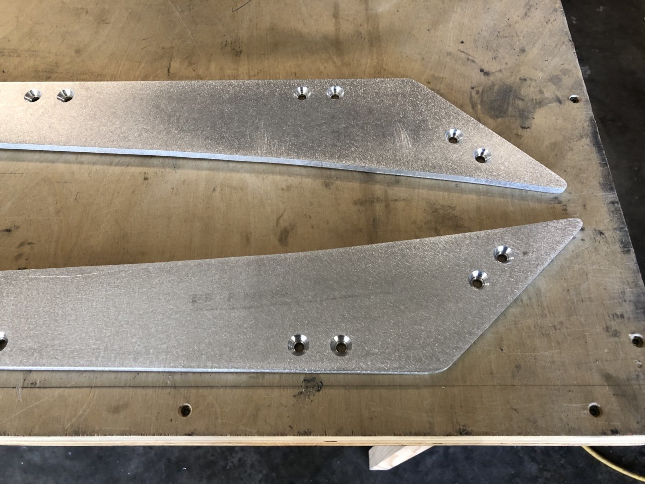

  10. Dec 22, 2018 at 1:12 PM
    #410
    loginfailed
    loginfailed [OP] Well-Known Member
    Aug 29, 2016
    #195923
    5,156
    Dwayne
    Houston, TX
    2014 DCSB 4WD
    Side plates done. Now on to the wind deflector.
    AAE8146D-C472-4CF5-982B-DC156E269751.jpg 2B12FBAD-0FF0-4198-91FE-DDC47E5EDA93.jpg 6AEB9FB1-2971-4DE4-B446-2584AA1EE3B6.jpg

    I have the hydraulic brake booster on my truck. My brakes feel great stock as @loginfailed can attest to since he has driven it. I wonder if the bigger brakes will even work on my truck.

    They will fit. The calipers, dust shields and rotors are direct swap.
    The pads are the same size, but more squeeze power from the bigger calipers should help a lot. Plus since the rotors diameter is bigger the squeeze happens further out from the hub.
    One problem I currently have is that the rotors are pulsating a bit. I think the beefier rotors will be less warpage prone.
    On paper is makes a lot of sense.
    Which master cylinder is the bolt on swap? Sequoia maybe?

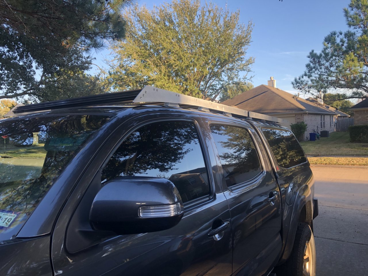

  18. Dec 22, 2018 at 2:47 PM
    #418
    loginfailed
    Aug 29, 2016
    #195923
    5,156
    Dwayne
    Houston, TX
    2014 DCSB 4WD
    Got it all bolted up, but haven’t started the wind deflector yet. Looks aight.
