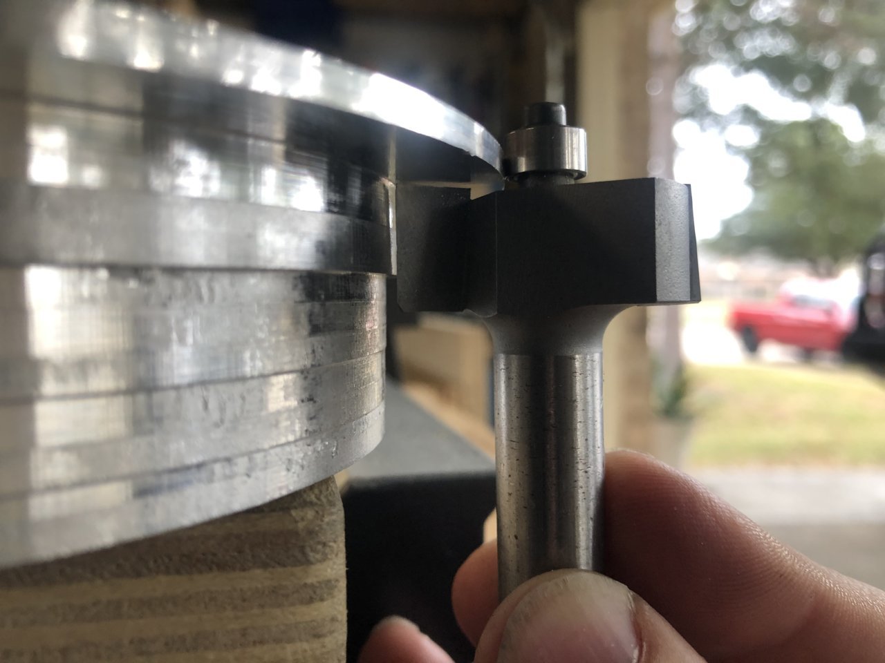

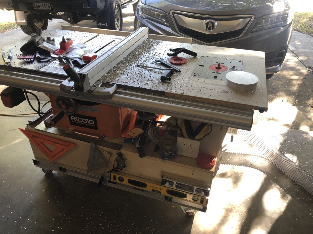

    Router bit likes small bites. Tried to do a half inch bite and it got away from me a little bit. You can see the layers in this pic. Slow going but it get it done.
    Had to down size the circle a hair so it would fit in the hole.
    Aluminum shavings everywhere! :goingcrazy:

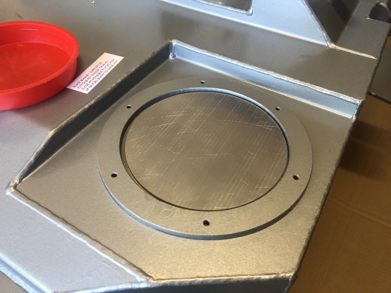

    It fits!
    Plenty of material I still need to remove. I went with thicker material so I would have a spot to bolt the vertical piece of the hanger to.

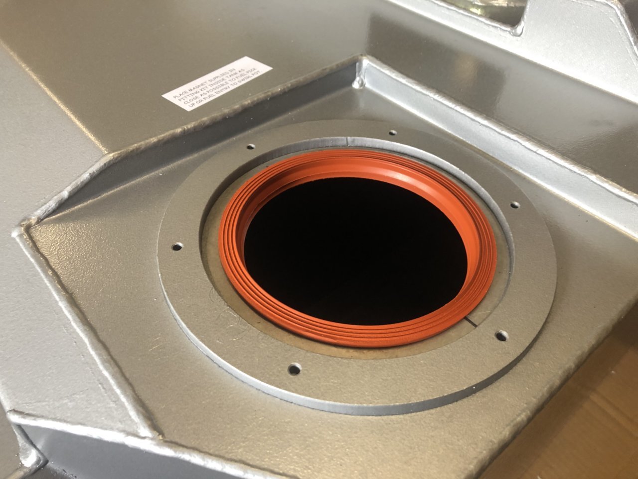

    Woot! Volkswagen fuel pump gasket fits! I was hoping it would because I like the flanged gasket vs. the plain old o-ring that Toyota uses.

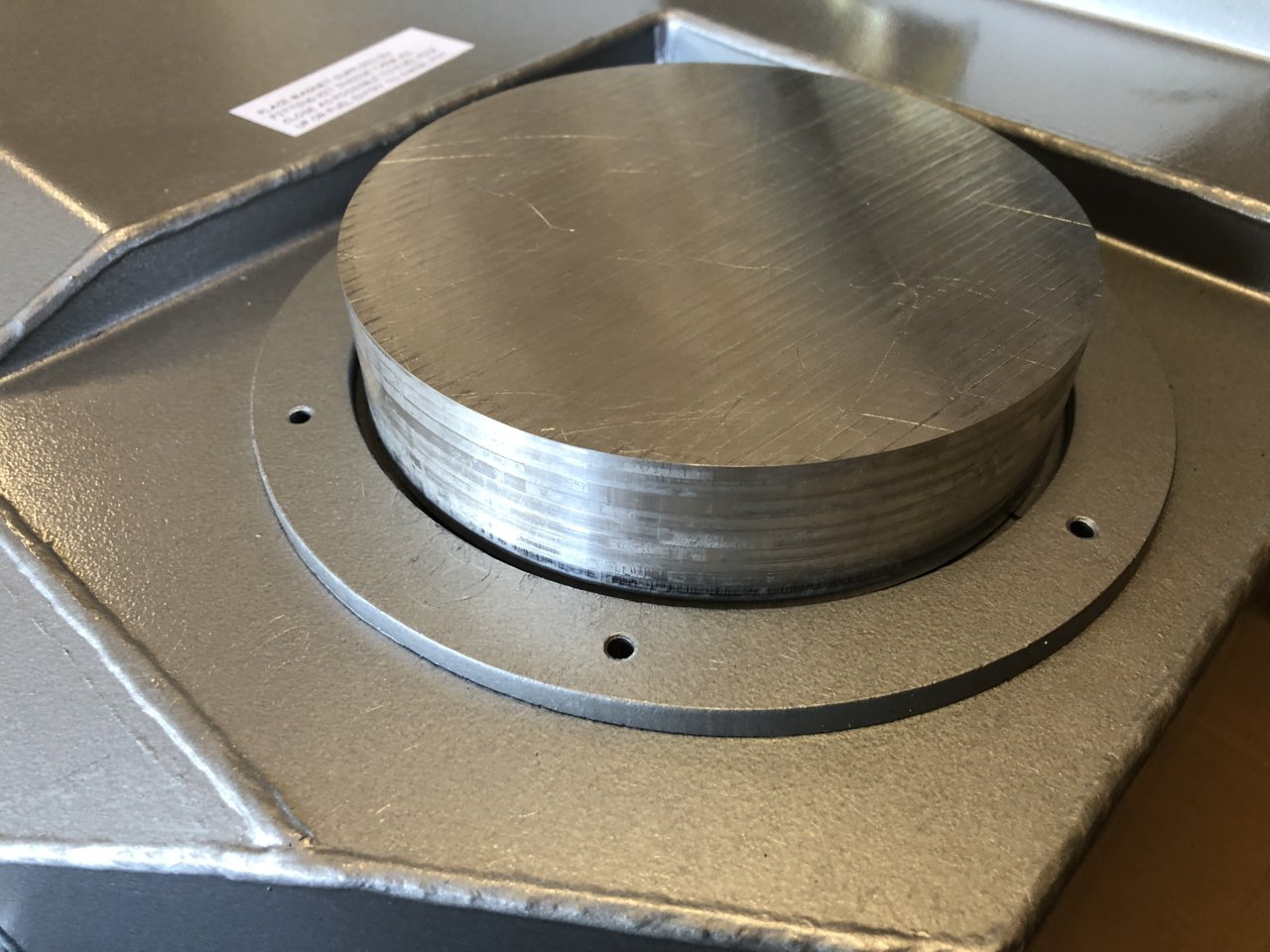

    It’ll come together eventually. I had to order a 1 7/8 rabbet bit to get this last little section. The bit I have is 1 3/8”. It can only cut as deep as 1/2 the diameter of the bit minus 1/2 the diameter of the smallest bearing. It can’t reach far enough past the flange.
    This is the Whiteside 1955 (1 3/8). The 1960 is 1 7/8” and will reach.
    Not quite big enough. Where have I heard that before? Hmm. :anonymous:
