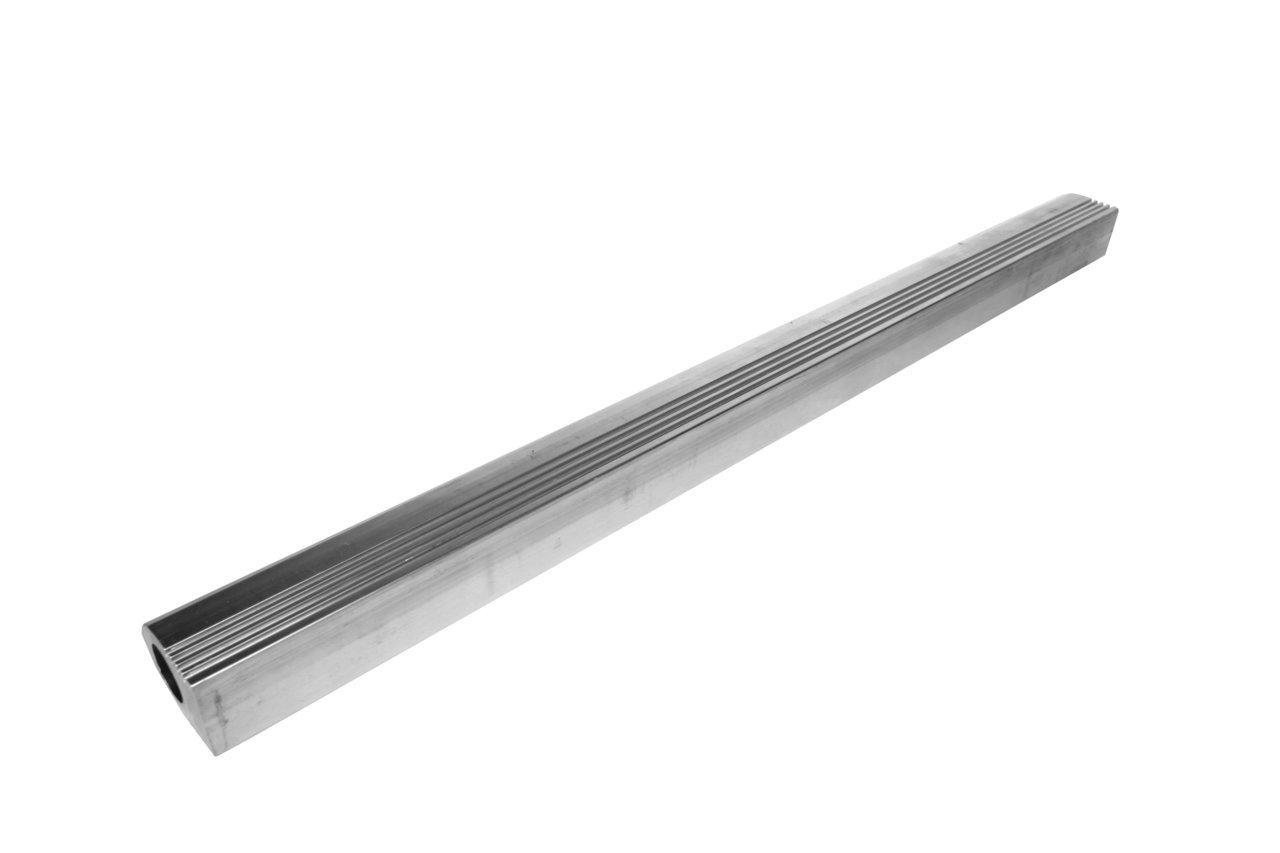

    Alright, I'm going to try to make fuel rails. It'll end up either being a big fail with the truck on fire, or it'll work just fine. :fingerscrossed:
    Ordered:
    36" Holley fuel rail extrusion
    https://www.summitracing.com/parts/hly-534-208/overview/
    Expensive-ass Ross Machine 14mm injector port drill bit
    http://rossmachineracing.com/injectortool.html
    3/4-16 (AKA -8an) tap
    https://www.amazon.com/gp/product/B000TQ6R2A/
    Used lower intake manifold from eBay for mockup
    https://www.ebay.com/itm/LOWER-INTA...runner-fj-cruiser-4-0-329-59716/202518363308?
    Used stock fuel rail from eBay for measurements
    https://www.ebay.com/itm/2005-2011-...ECTION-RAIL-4-0-6-CYLINDER-USED/283025846192?

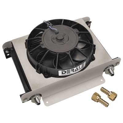

    Will that work with fuel? If I read the description correctly it said it was for transmissions. I'd like a way to cool the fuel on my 80's return line. It heats the tank up and then you get vapors coming out of the tank when you go to re-fuel.
  14. Dec 27, 2018 at 4:28 PM
    #494
    loginfailed
    loginfailed [OP] Well-Known Member
    Aug 29, 2016
    #195923
    5,156
    Dwayne
    Houston, TX
    2014 DCSB 4WD
    Yes, you can use it for fuel. They say it in the instructions.
