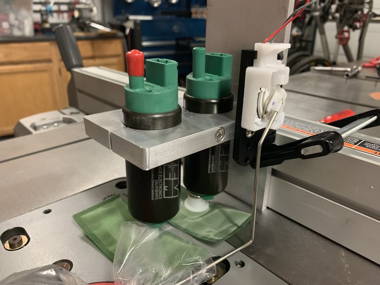

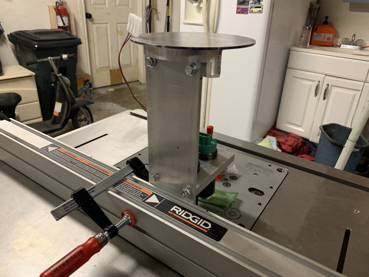

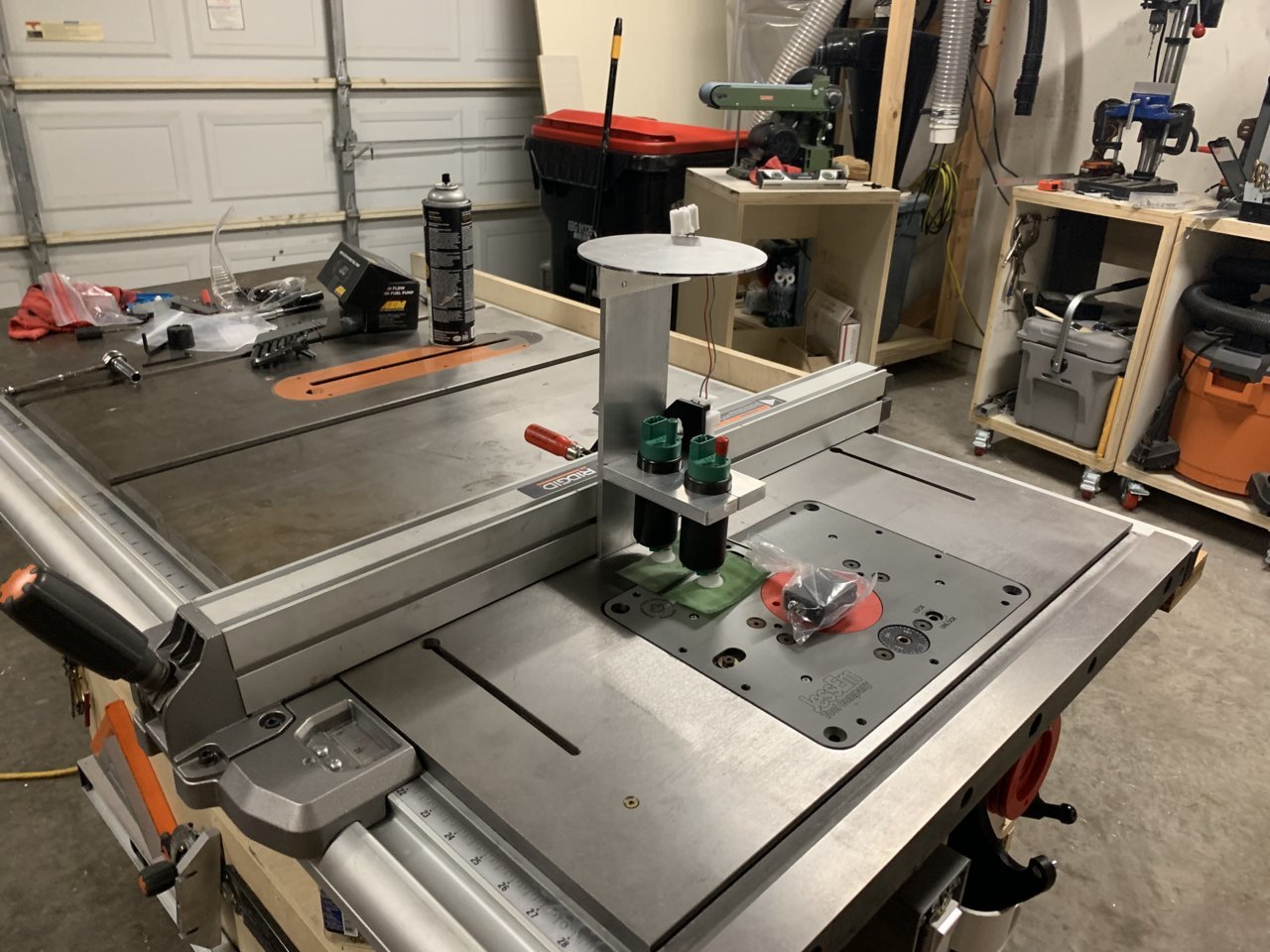

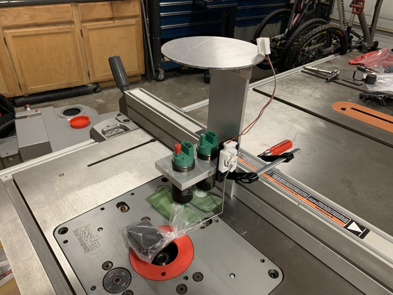

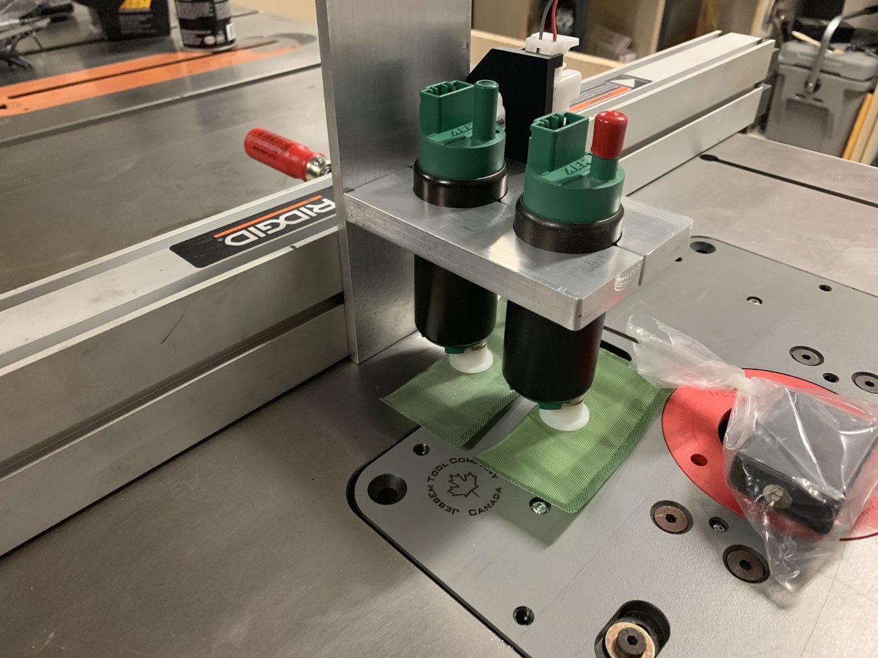

    I finally got around to finishing the fuel pump hanger. Had to make a few modifications to be able to get it into the tank opening.

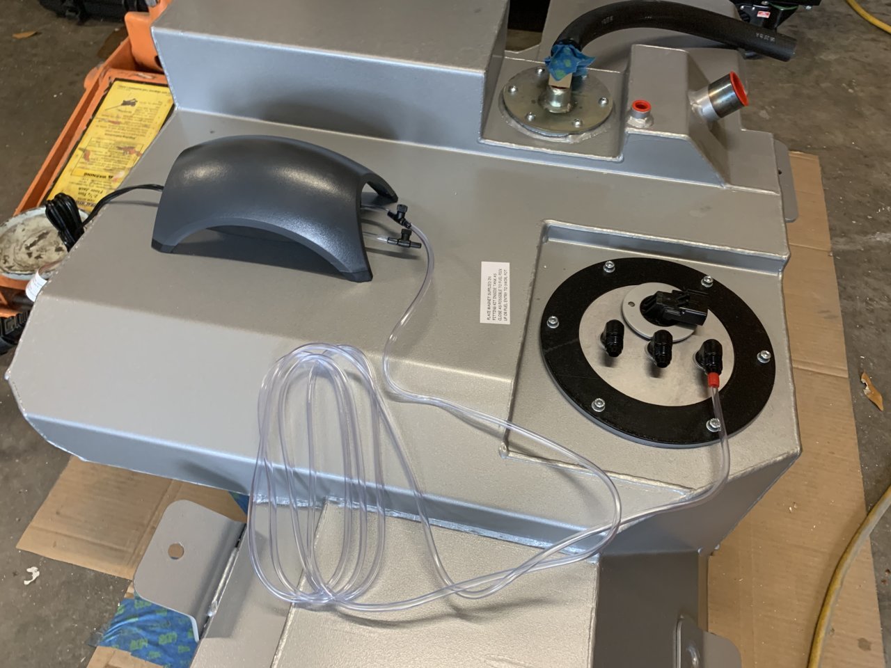

    Fish aqauarium pump pressure test. Does she hold?

    Seems like we have success!

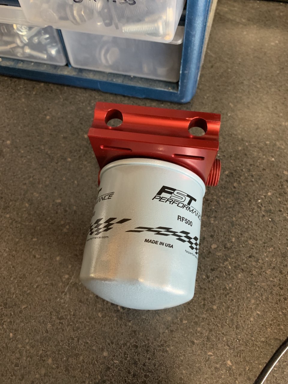

    Starting today. The tank probably would be doable in a couple hours. But I’m also running new lines to the fuel rail, new fuel pump power wires, an FST RPM300 spin-on fuel filter and a boost switch to activate the second pump.

    2014 DCSB 4WD
    @Torspd
    Where’s that pic of your fuel filter? Trying to figure out a good place to mount his thing.

    Here you are.
