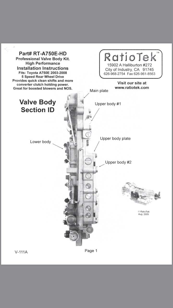

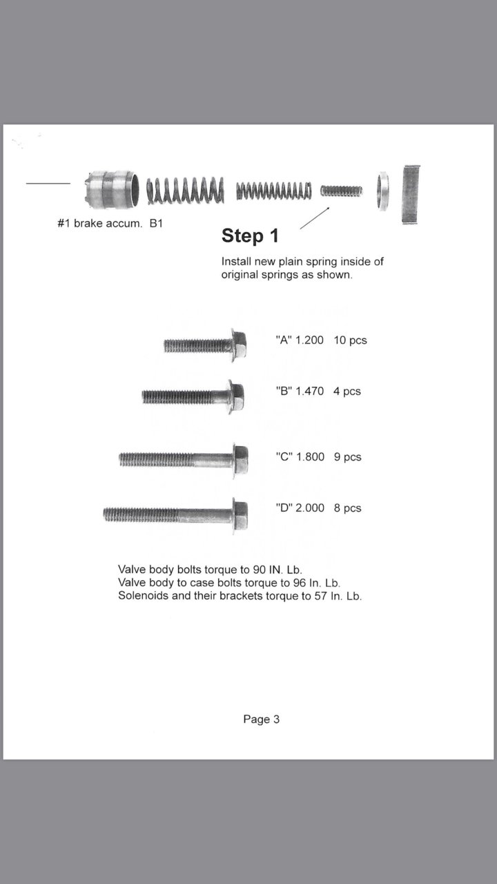

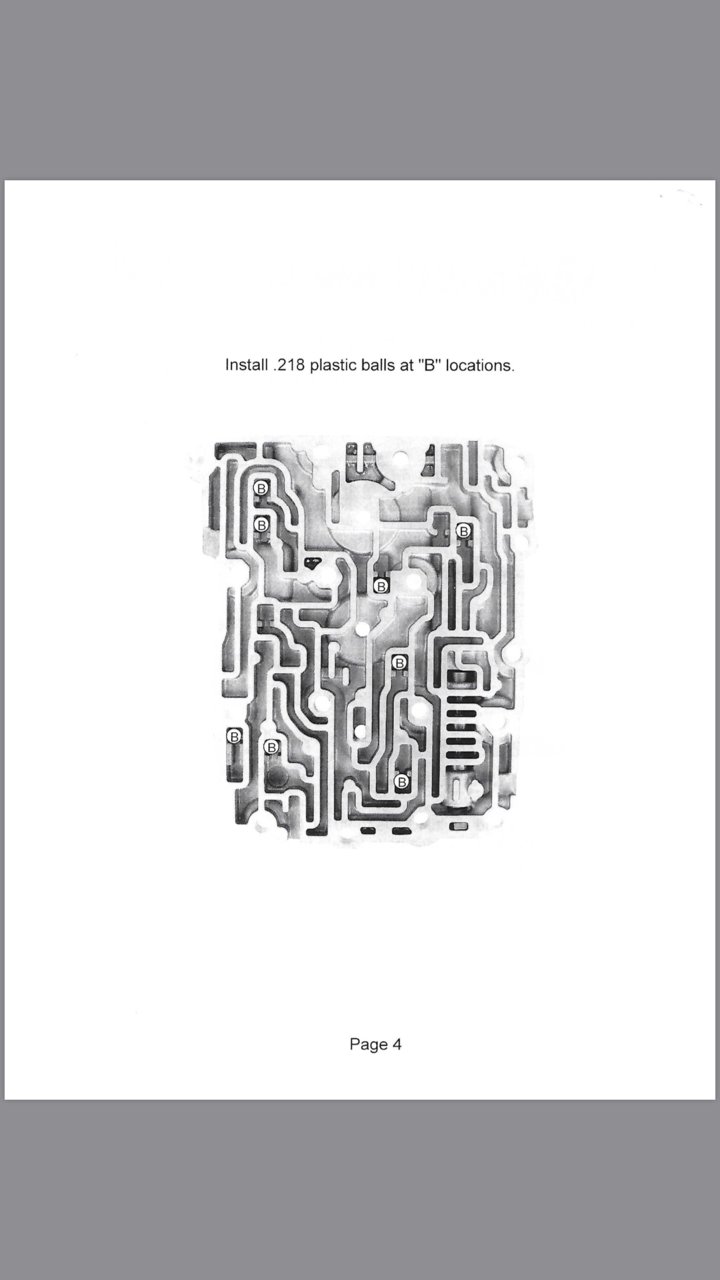

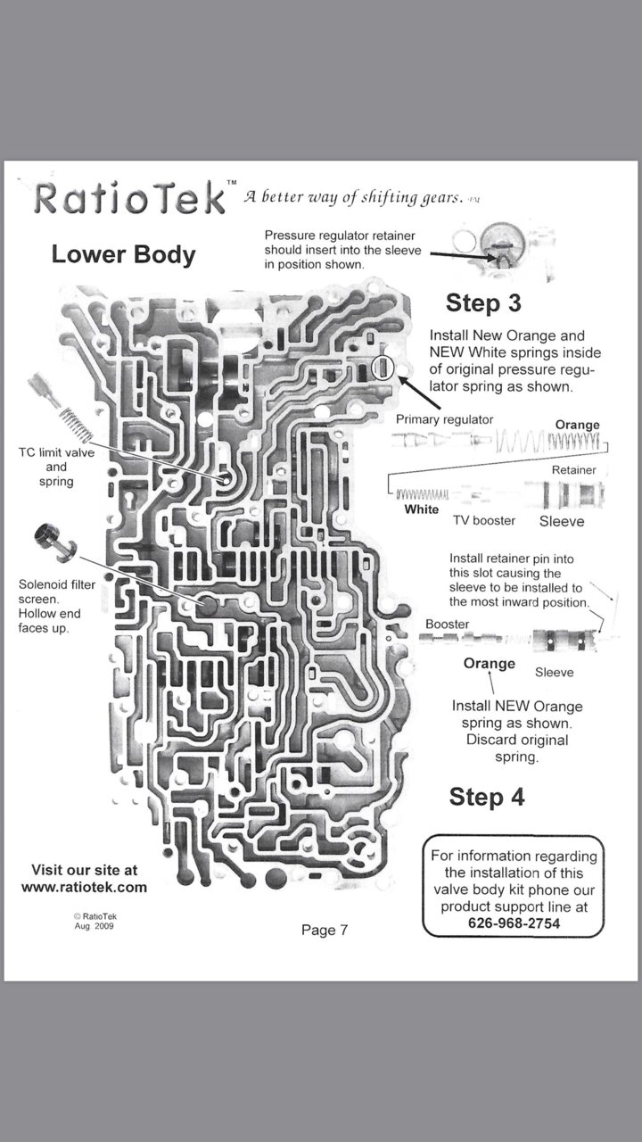

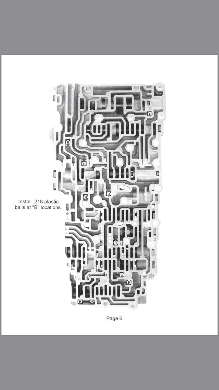

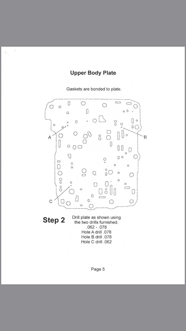

    There’s a ton of info on these valve bodies. The shift kit I used is from RatioTek. The instructions said 2003-2008 but I called RatioTek and he said it should work for a 2014.

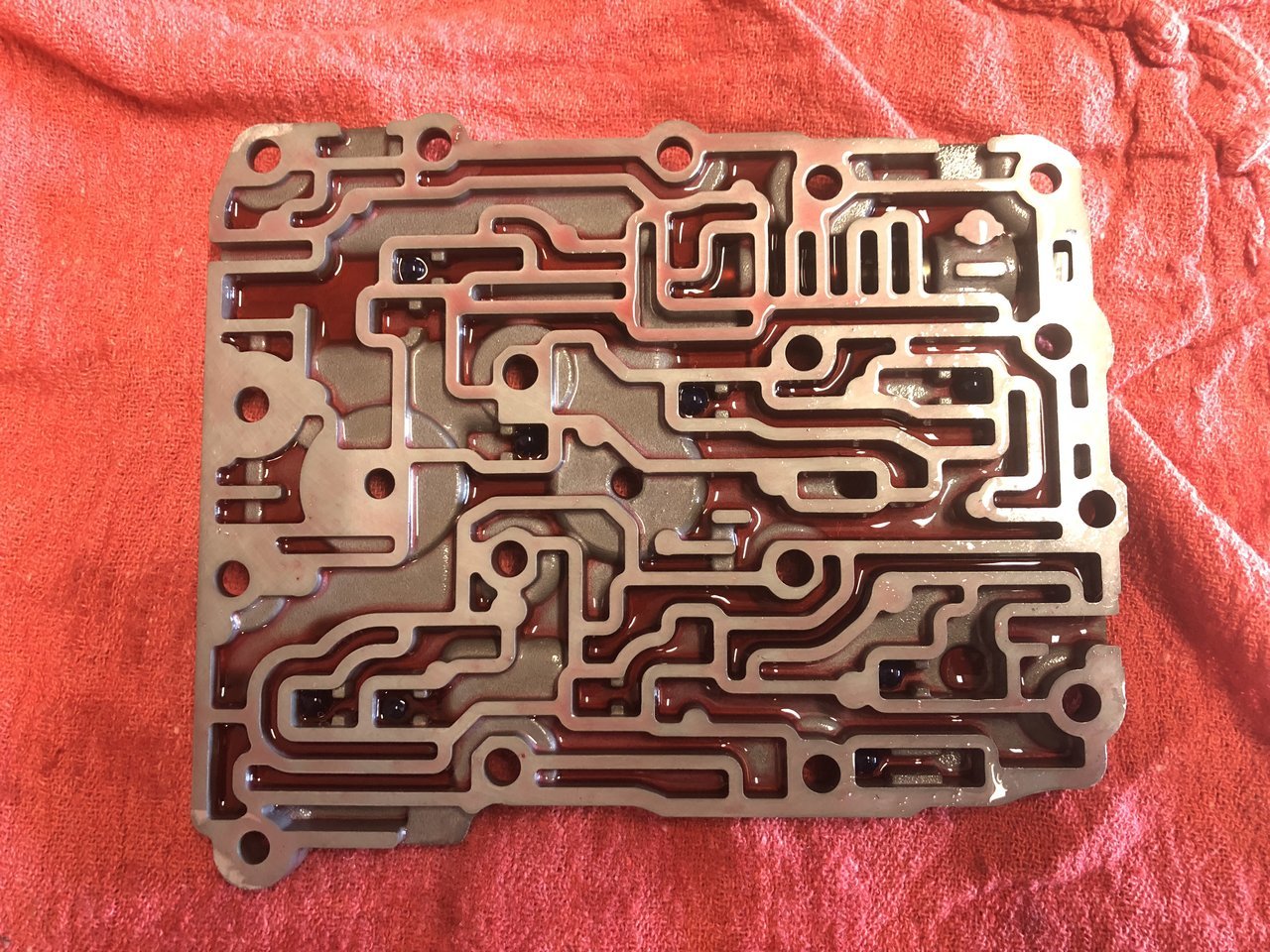

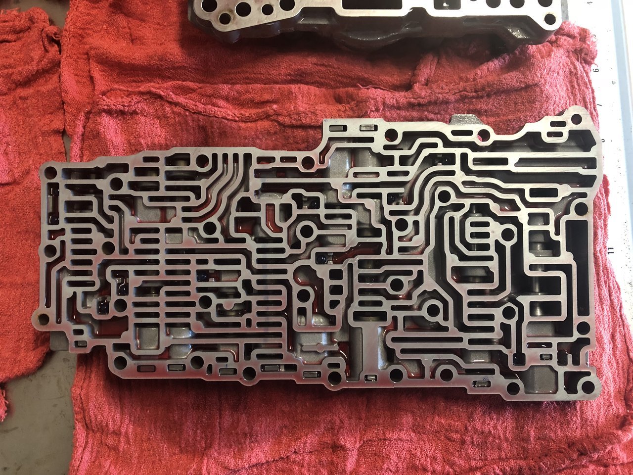

    I’ve already had it out twice. Didn’t really take any pics of the removal process. But here are some pics of the valve body itself, disassembled. I’ll take some more pic next time I pull it out.C1055E7C-D67E-4DE5-A49A-378A743CF5B5.jpg39514BF6-F552-48C8-9FE7-05A09B612B2A.jpg

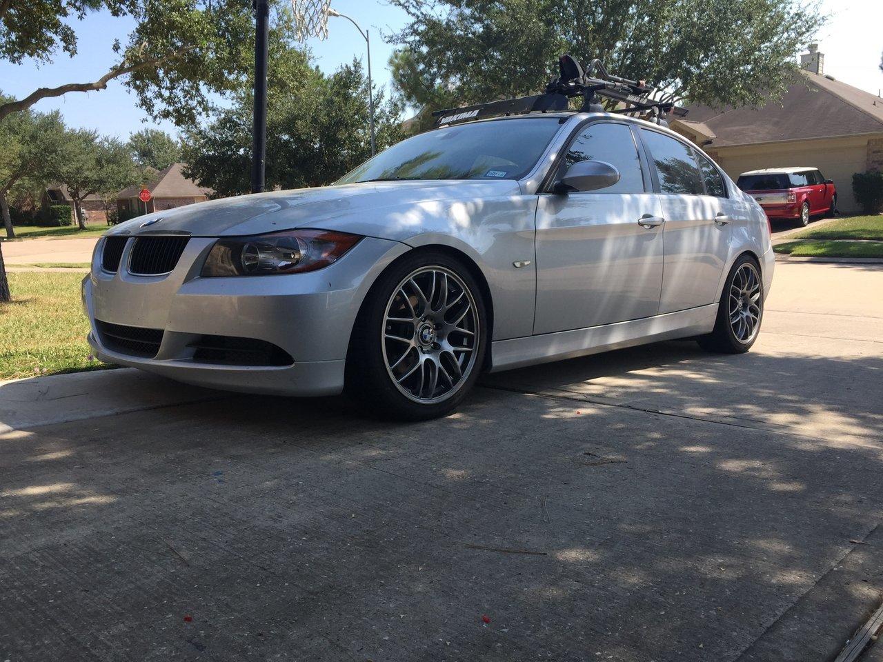

    Here’s my 2006 325i. Loved the car. It wasn’t fast but it had tremendous handling. My father-in-law side swiped it backing out of his garage and I wasn’t happy with the body work performed.
