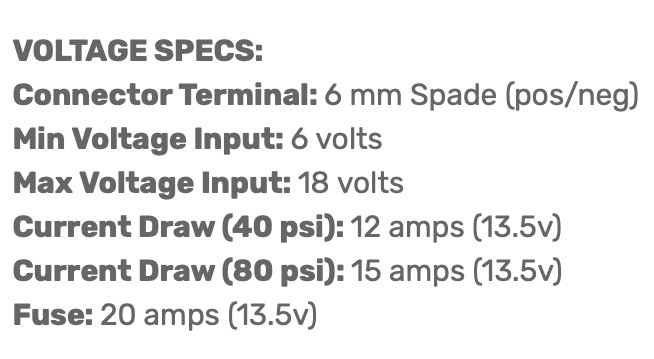

    AEM says these pumps are rated for up to 18 volts. Looks like this rig is getting the fuel pump resistor delete mod. :D

    Do tell, is this a thing? My resistor always seems like its in the way for mods.

    I haven't heard of anyone actually removing it, but I'm about to. It is a .75 ohm resistor. The ECM can decide when to run the pump through the resistor or not. I'm not sure what strategy the ECM uses to decide, but I'm not giving the ECM a choice.

    Torspd Custom Turbo kit [] Borg Warner 9180EFR Turbo [] Haltech Elite 2500 [] TiAL Q BOV [] TiAL V44 Wastegate @ 15psi [] CP Pistons [] CP Carrillo Rods [] ARP Head studs [] ARP Main Studs [] ARP Header - Head Studs [] Ported Heads w/ 1mm oversized valves intake/exhaust [] Brian Crower Forged Stroker Crank [] Darton M.I.D. Sleeved Block [] Kelford Camshafts [] Torspd 160* T-stat mod [] APR Large Fuel Rail [] Walbro 460 LPH E85 Fuel Pump [] FueLab FPR [] APR T56 Conversion Kit [] KP RACING Built T56 [] McLeod Racing Custom Twin Disk Clutch [] One Piece Aluminum Driveshaft [] MGW Shifter [] Custom lowering kit [] Ohlins Front Coilovers [] QA1rear shocks [] Custom Ron Davis Radiator [] Dual SPAL Electric Fans []
    Where is the resistor physically located? Is it the large one behind the driver side headlight? I cannot remember.

    Yes, I think it is down on the frame between the headlight and the battery.

    Not sure if it will set a CEL or not.

    So is this just another way to increase fuel pressure, except this should increase it all the time right? and not only when under boost like with the FPR?

    Based on this:
    https://www.customtacos.com/tech.ol...06toyrm/06toypdf/06rmsrc/rm2006ta/0050028.pdf
    The ECM uses the resistor to feed a lower voltage to the fuel pump at times it deems that full pump output is not needed. So at low RPM, light load. etc it runs through the resistor.

    On mine it's on the driver's side inner fender panel above the tire. I've reallocated that space for my Bussman RTMR relay/fuse box. Currently the resistor is homeless and tied to the brake controller. That resistor gets to be about 300 degrees or so when in operation. Need to keep it in a spot that has some decent ventilation. If deleting was an option, I'd look into the ramifications of it. It's not just a run of the mill resistor, it's a pretty serious bit of heat sink.

    I’ll let you know how it works out. Provided it doesn’t set any CEL, there should be no noticeable difference other than the fuel pump getting full power at all times.
