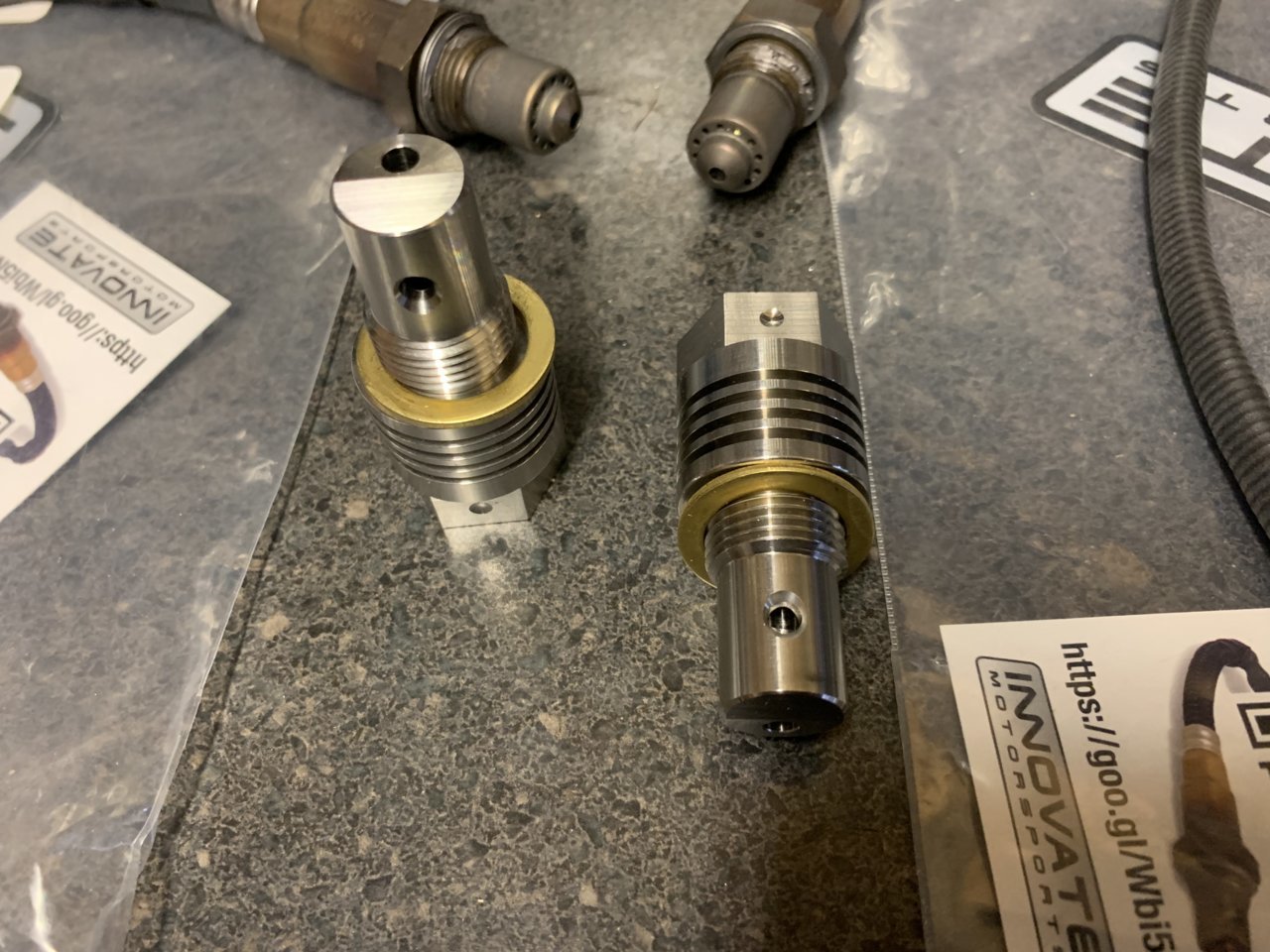

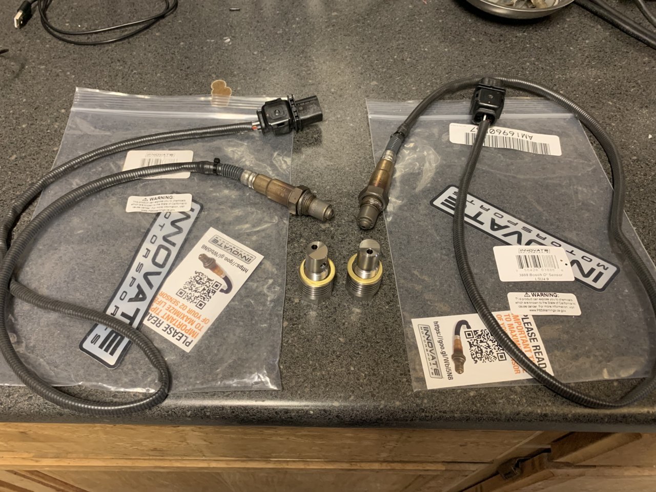

    Seems like the Innovate sensors screw up pretty regularly. Maybe they’re getting too hot, not sure. Truck is getting treated to a fresh pair.
    Also I’m adding some heat sink extenders. They have a hole that extends down into the exhaust flow to so they can get a sample without actually being directly in the line of fire.
