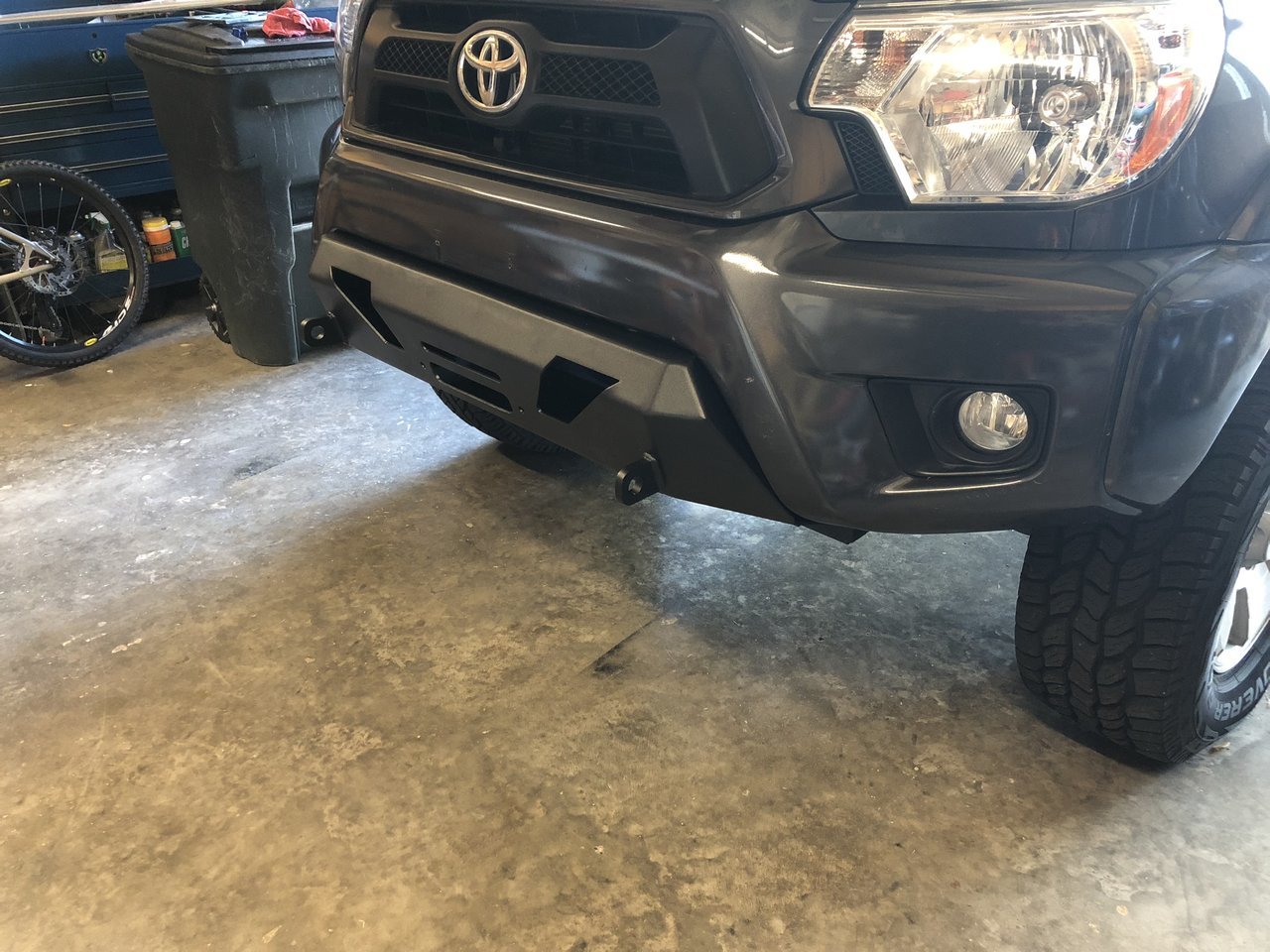

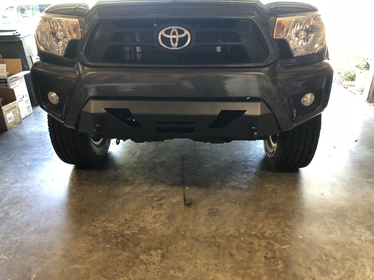

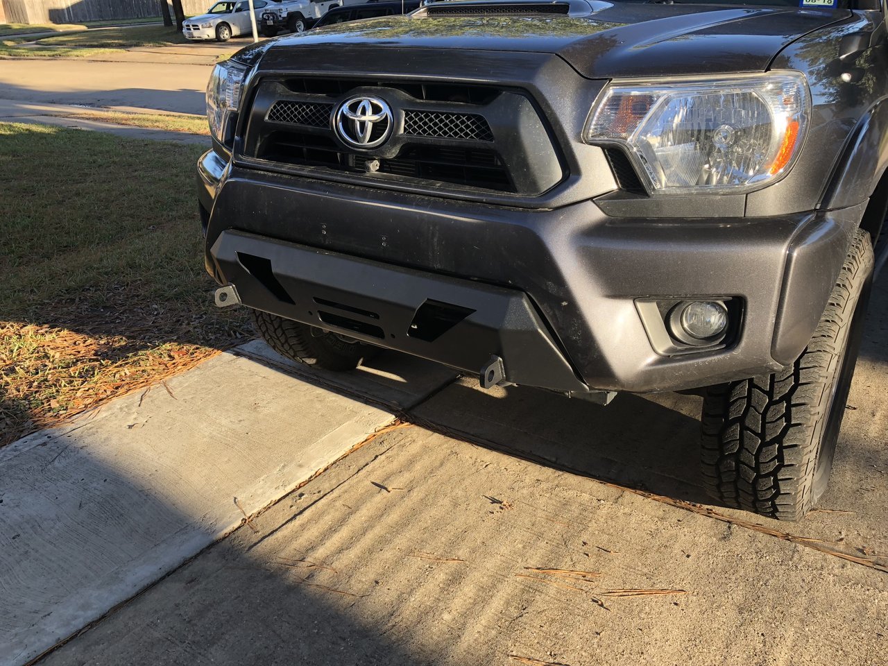

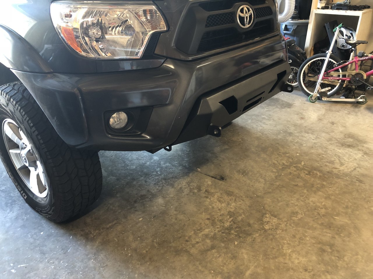

    I installed the SOS streamline today. No winch just yet. Waiting on Santa, :D

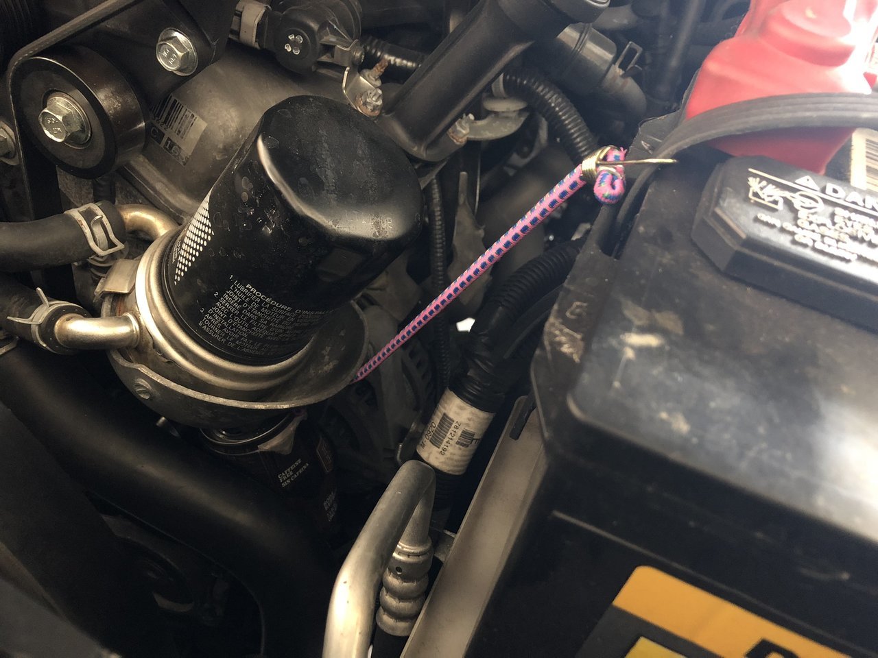

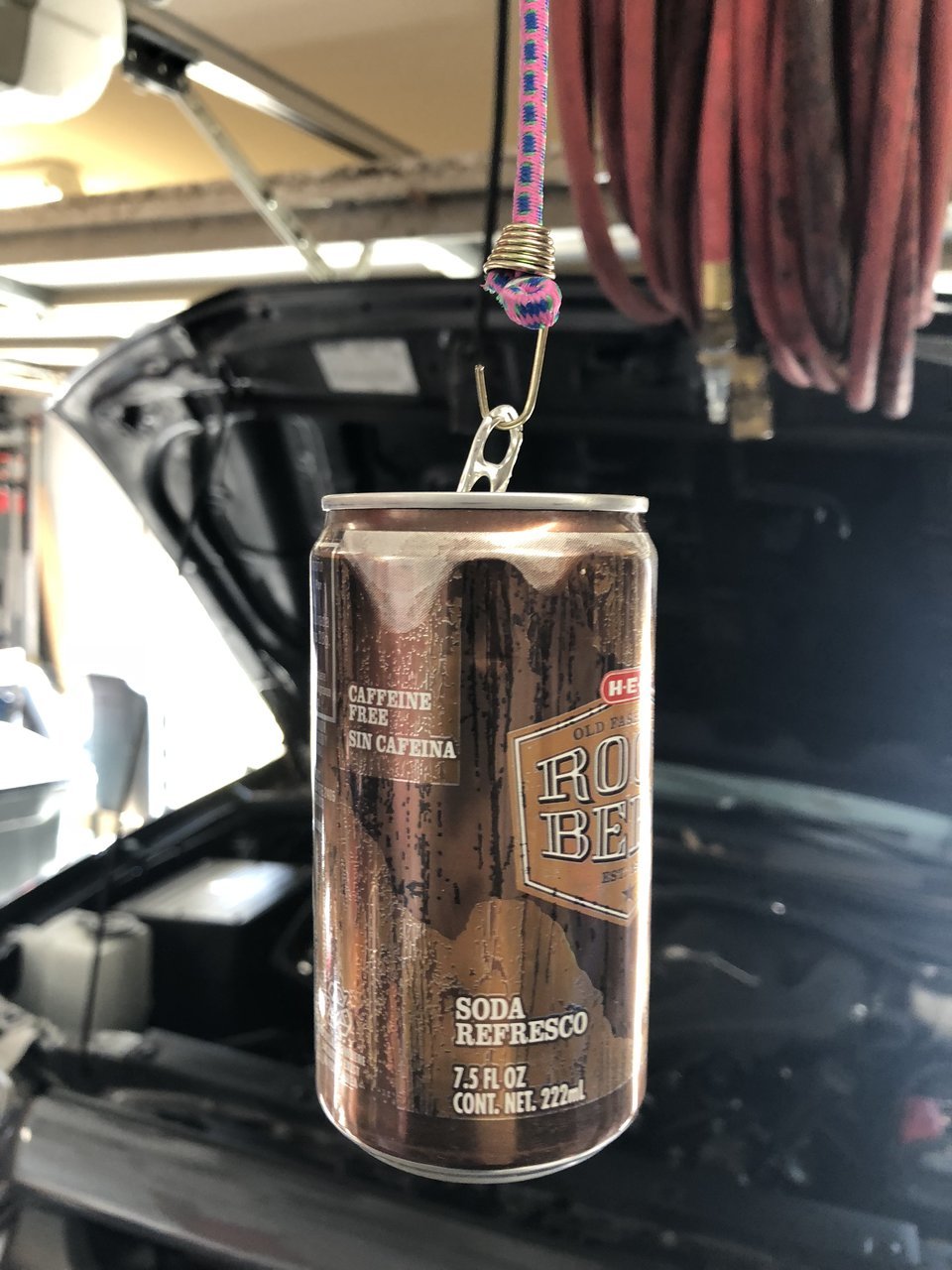

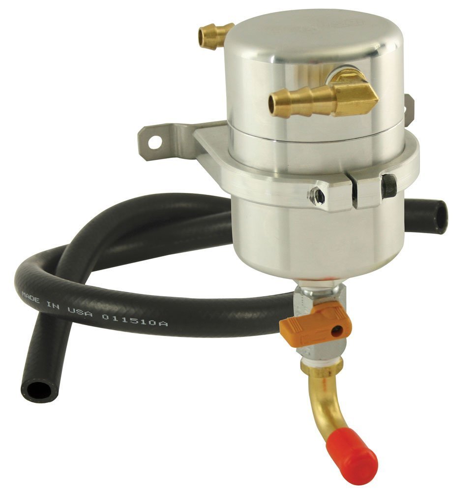

    Changed the oil on the Taco this morning.
    I rigged up this little root beer can with a bungee cord to catch the oil when the filter comes off.
    I also ran a rubber hose through the driver fender well to make draining the catch can a little easier and less messy.
    This is about 3,000 miles worth.

    Thats a pretty neat idea with the catch can. My ADD W1 didn't have a bottom drain, it just unscrewed and I poured it out. It could be a pain if it was on there tight though, hard to get my hands in and break it free. I used a deer park water bottle on mine when it was NA and it would fit perfectly under the nipple for the oil filter drain. Post SC install, I just had to hold the bottle there.
    My AOS on the subie has a drain that automatically dumps any oil caught back into the system. It is a clever design. It also uses hose that circulates coolant around it so to keep condensation build up to a minimum.

    Pretty cool how Subie has it set up. How you liking the new ride?
    The Moroso has a 90 degree outlet on the bottom with a lever you can flip to open and drain. Makes it easy to drain because you don't have to un-screw the bottom.

    Looks much easier than the one I had. Quarter turn ball valve and you're done.

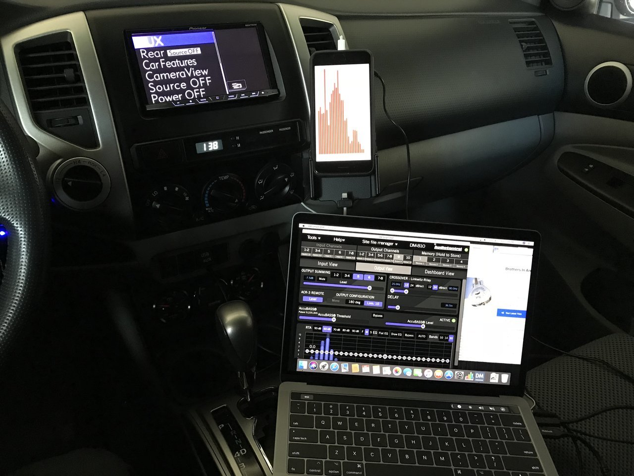

    Messed around with my processor a little bit. Audio Control finally came out with the MacOS version of their tuning app which is nice. Now I won’t have to boot into windows. Now if only iTronix would make the uTune software work in MacOS.

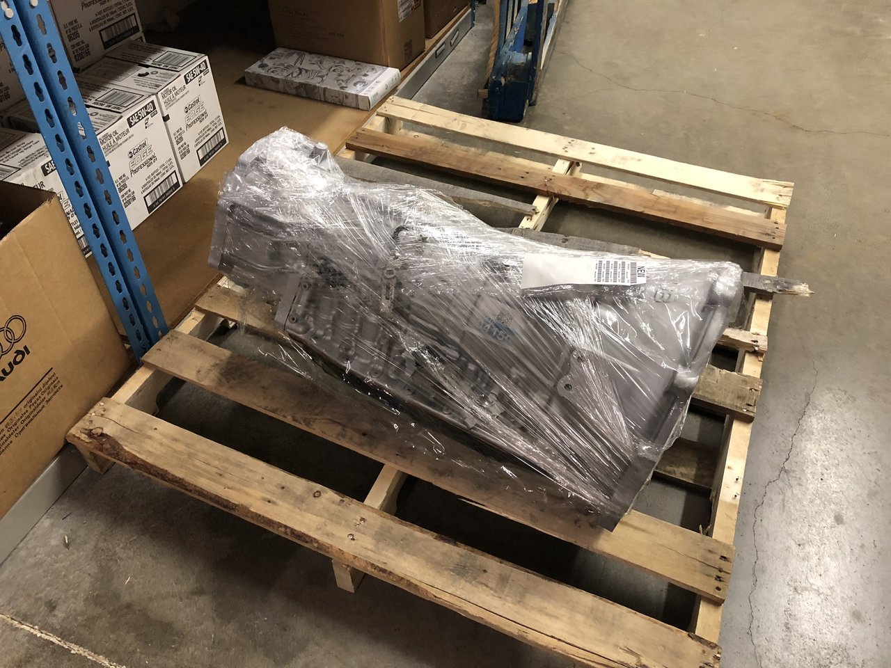

    IPT transmission came today. Maybe a Saturday install session. Woot! :headbang:

    Hopefully the install goes smoothly and no issues from the new trans. It’ll be nice to have 5th gear again. 3500 RPM @ 70 MPH, I try to avoid long trips at the moment. :D
    John at IPT told me once the trans is installed, to ship him my old valve body and he’ll fix it for me so I’ll have a good trans to keep as a spare or sell. Cool dude.
