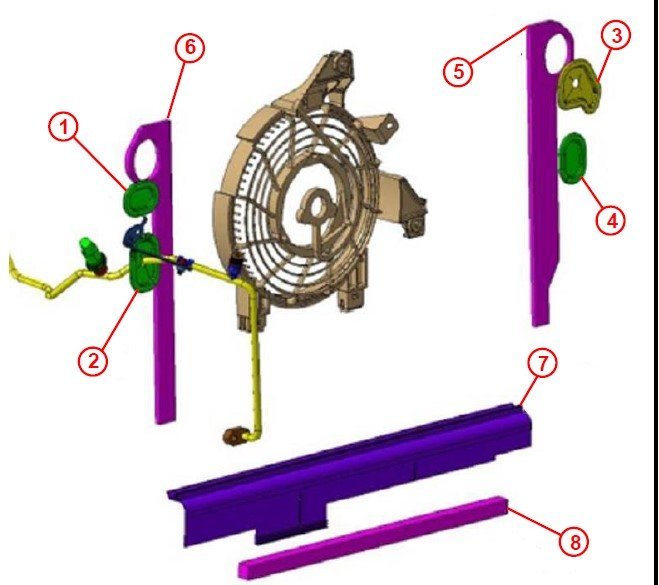

    Saved for later. Thanks @BillDaCat8 :thumbsup:
    #2 36869-04010 COVER, P $8.25
    #3 36869-04030 COVER, P $8.25
    #4 36869-04040 COVER, P $7.61
    #1 36869-04020 COVER, P $6.87
    #6 53285-04010 SEAL, RA $6.03
    #5 53286-04010 SEAL, RA $7.64
    #7 53398-04010 SEAL, RA $47.87
    #8 36867-04040 SEAL, PA $10.89

    Tried to order #s 1-6 and #2, #3 and #4 are discontinued, according to my dealer.

    Interesting considering this is a pretty new tsb. I'm sure you could buy the whole kit but that's expensive.

    Have you checked ebay? When i was looking for a block heater for the truck, my dealer said they were discontinued. I found a dealership in wisconsin selling them on ebay and picked one up.

    I was surprised to learn that some of the grommets are discontinued since like you said this TSB is fairly recent. I just took what they had for now.
    I did check eBay no luck. I’ll keep an eye out for the other pieces. Maybe I can snatch them up later.

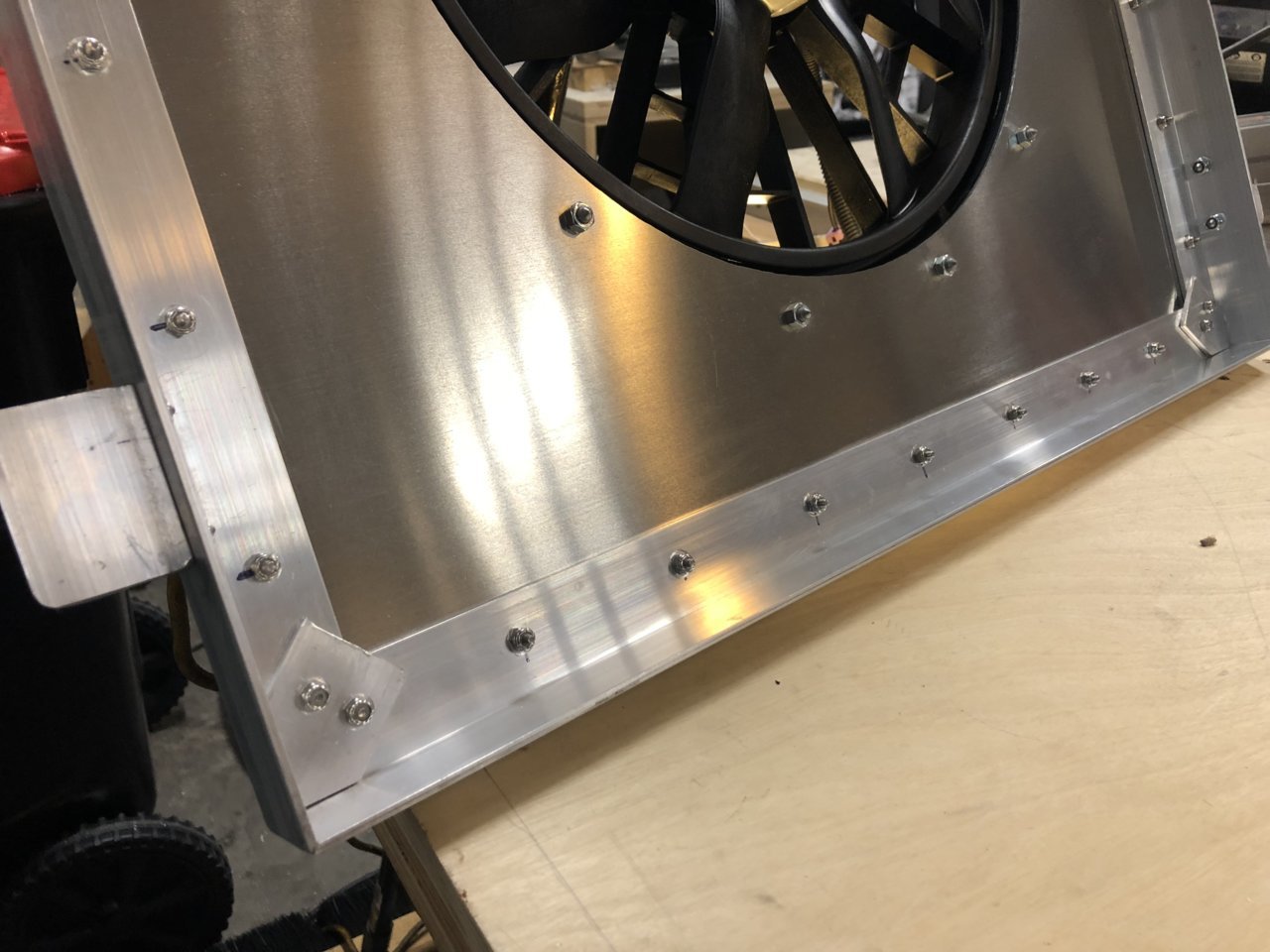

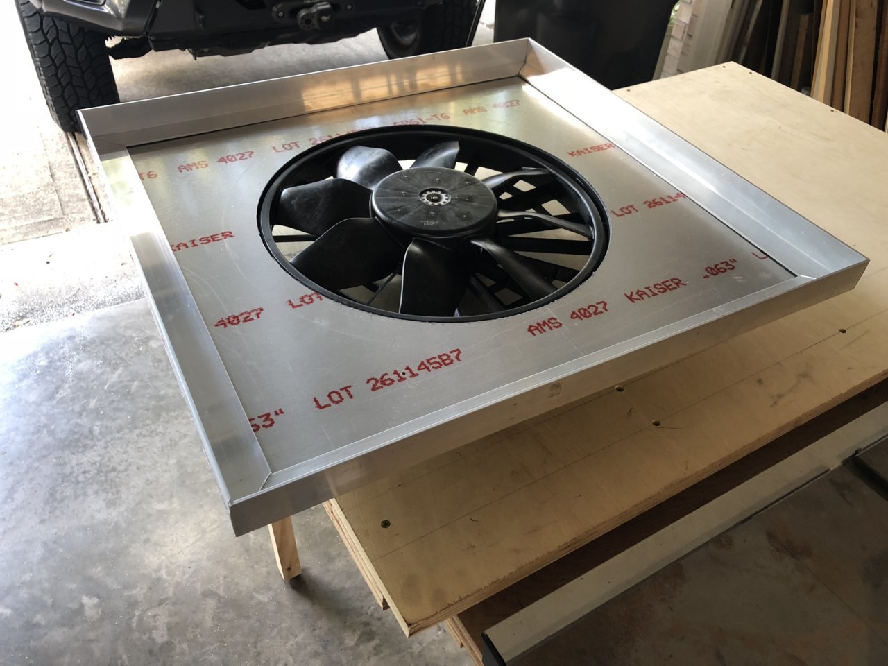

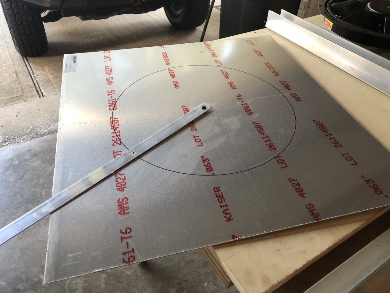

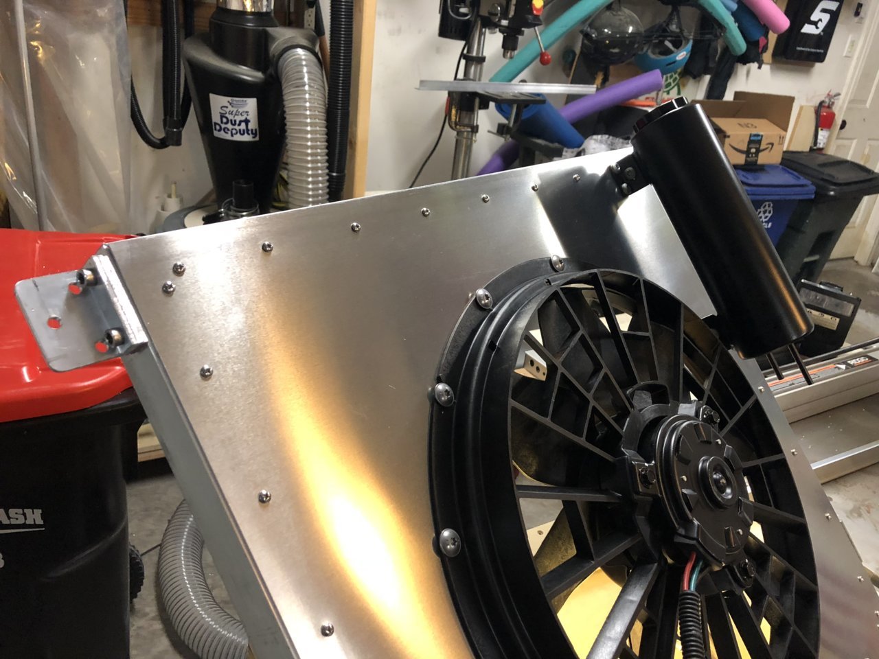

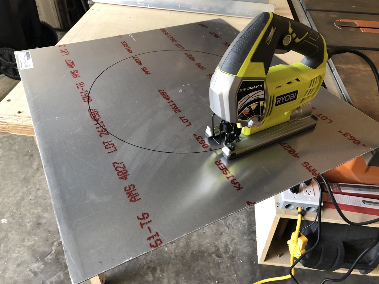

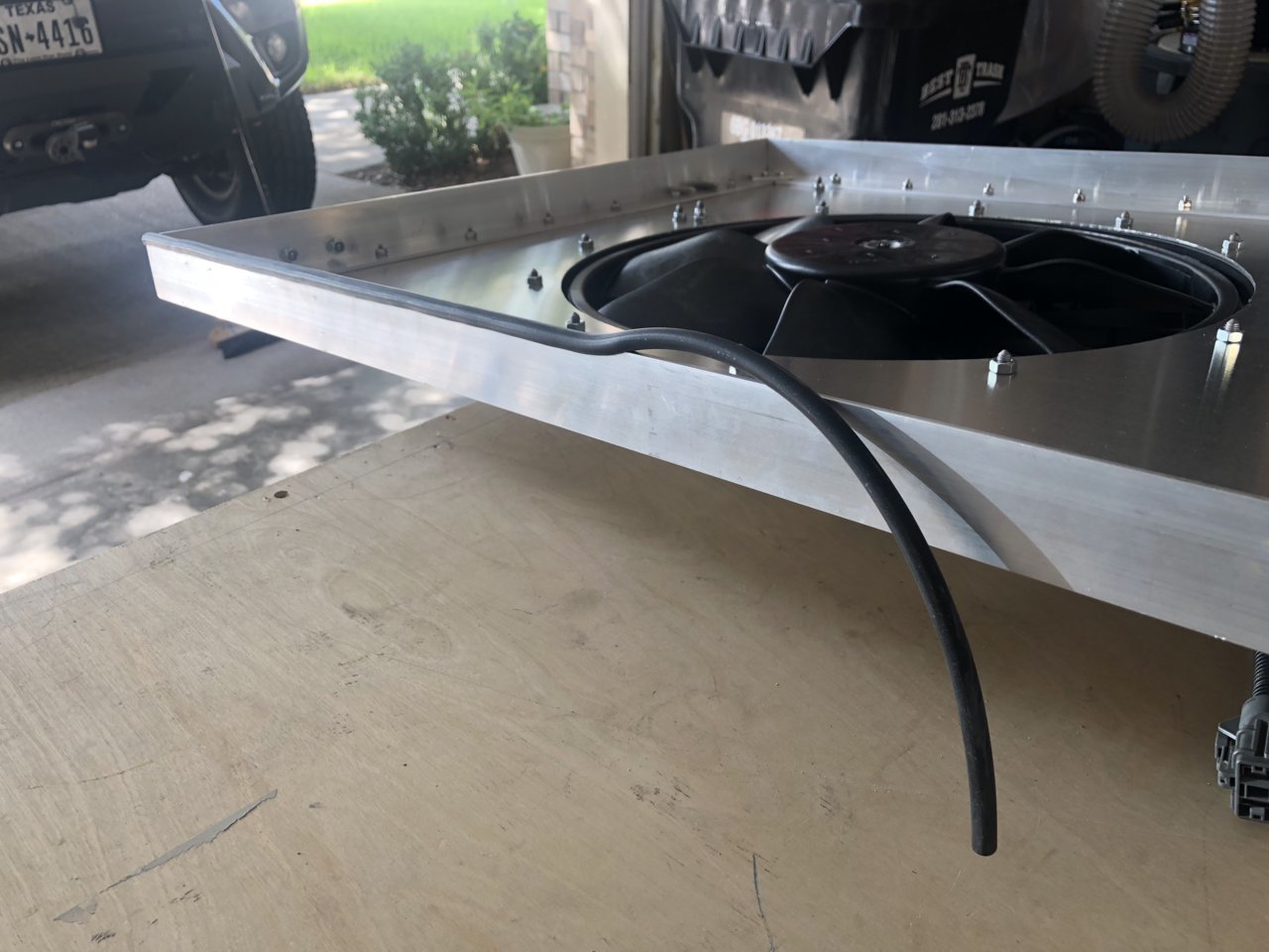

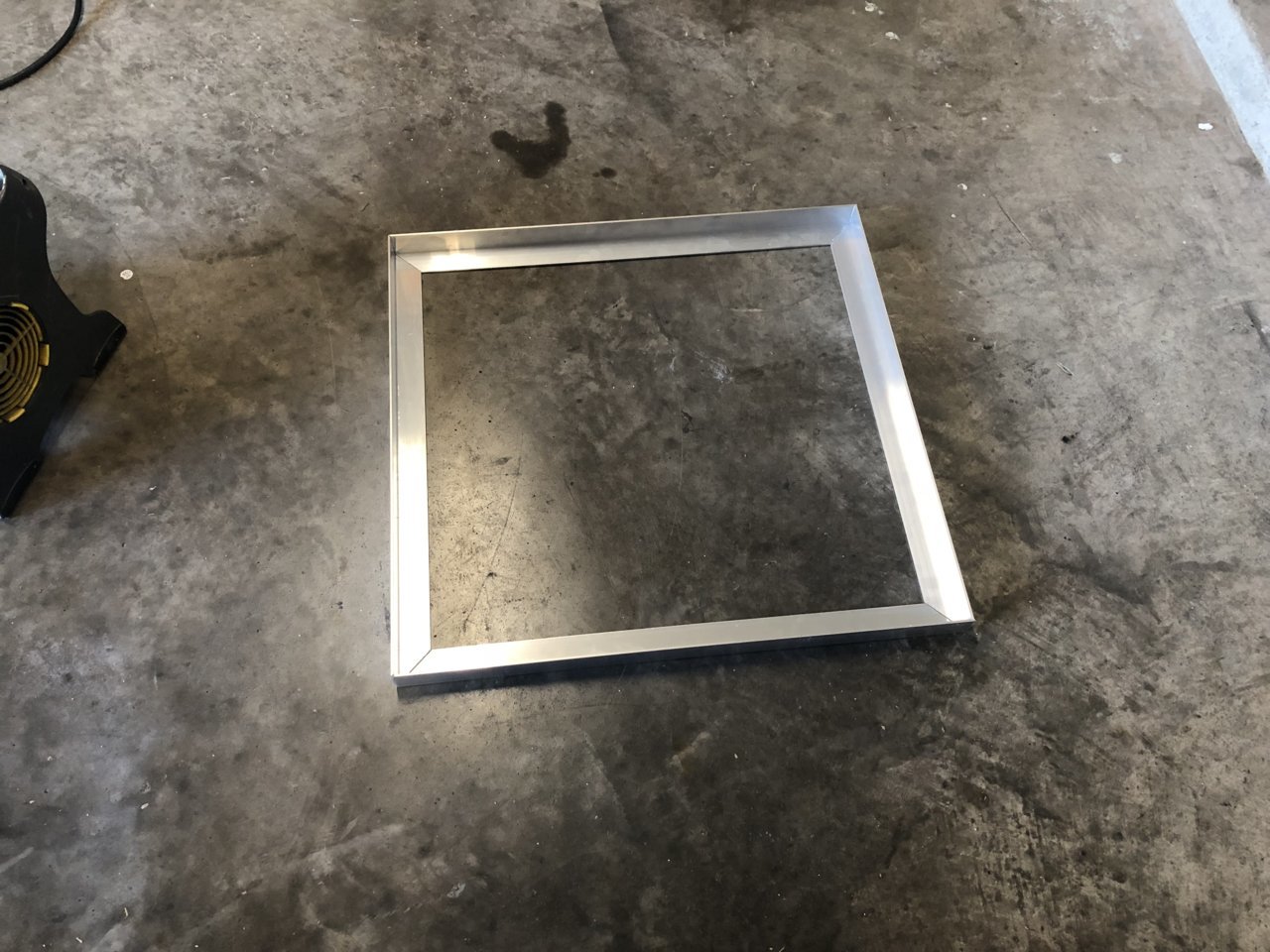

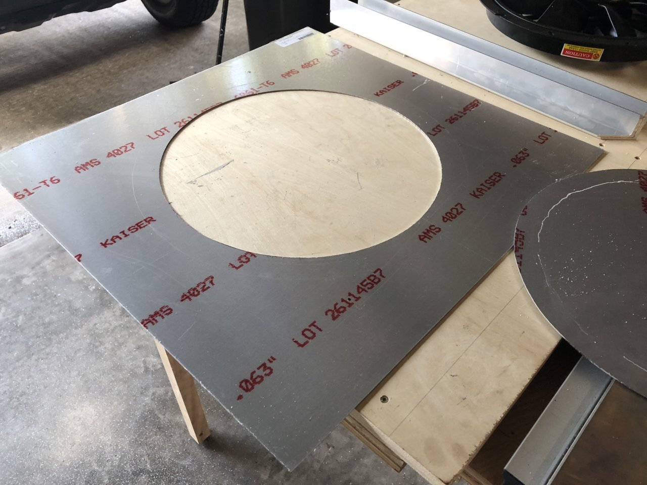

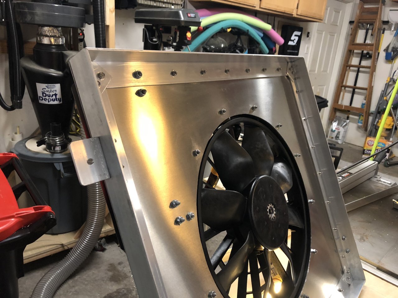

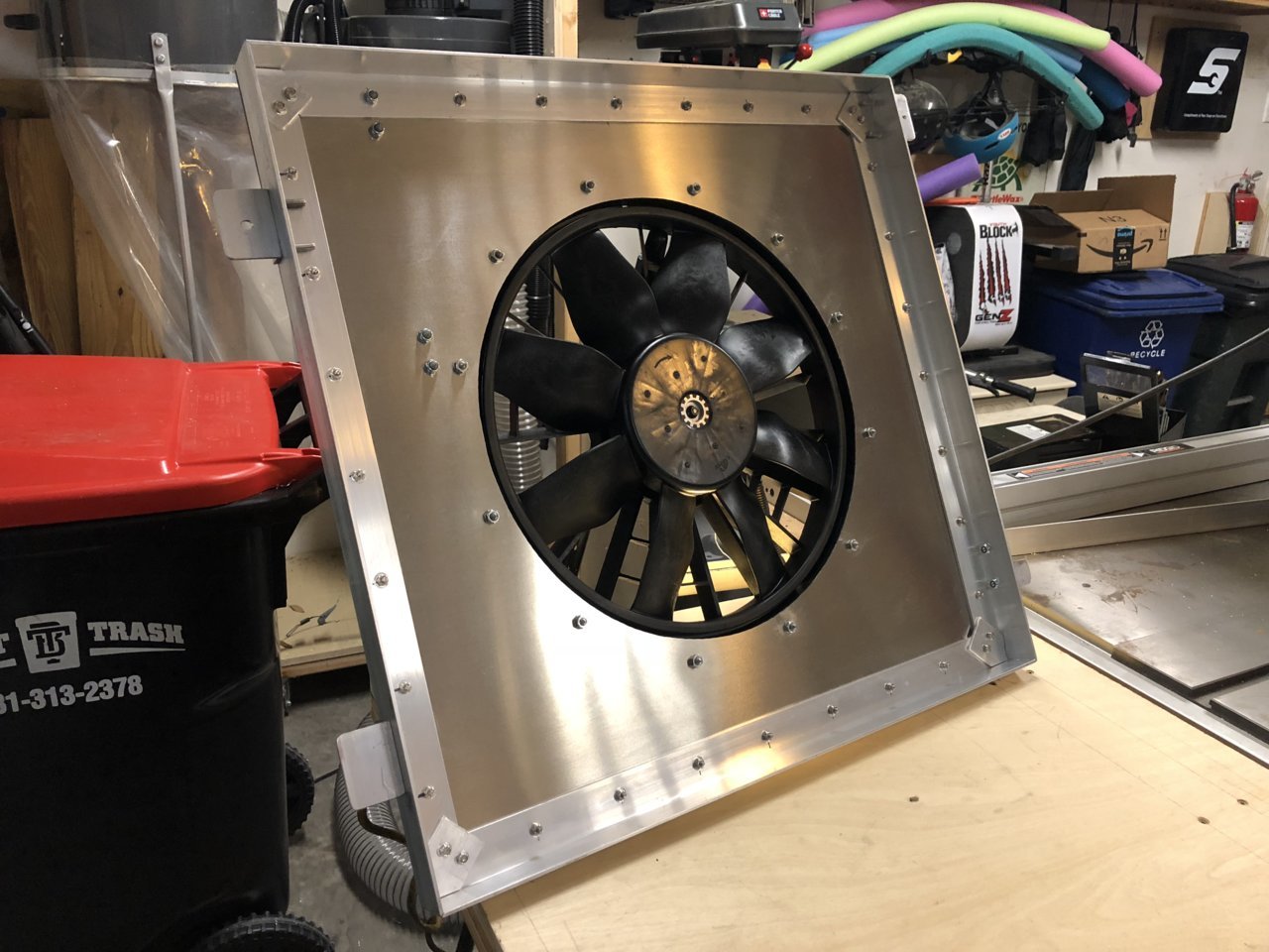

    So I spent most of the day in the garage working on the new shroud. First half of the day was screwing around with my TIG welder trying to learn to weld aluminum. I practiced quite a bit and made a few good beads. But the high frequency start isn't working AT ALL on this AHP TIG. Its a pain in the ass to scratch start so I finally gave up on welding the shroud and just used nuts and bolts.
    Despite there not being any pretty welds to drool over, I think the shroud came out looking super sharp. Pic dump incoming...
    Progress pics.
    Finished product.
    IMG_1137.jpg IMG_1145.jpg IMG_1138.jpg IMG_1143.jpg IMG_1146.jpg IMG_1144.jpg IMG_1148.jpg
    The shroud fits up to the 4Runner/FJ radiator perfectly. Two tabs at the top bolt to the top two mounting holes in the radiator. Two tabs at the bottom slip into the little holders at the bottom of the radiator. The dimensions are 25.50"w x 24.25"h x 1.50"d. I wanted to make it 2.00" deep, but the stores around here were out of stock, so I went with 1.50". All the bolts and nuts are stainless.
    One thing I forgot to order is bypass flaps to help cooling at highway speeds. Looks like I have room for a few of them. Not sure how many I should add. I've seen some shrouds with just a couple and some with 8 of them.
    Tomorrow I'll get it wired up.

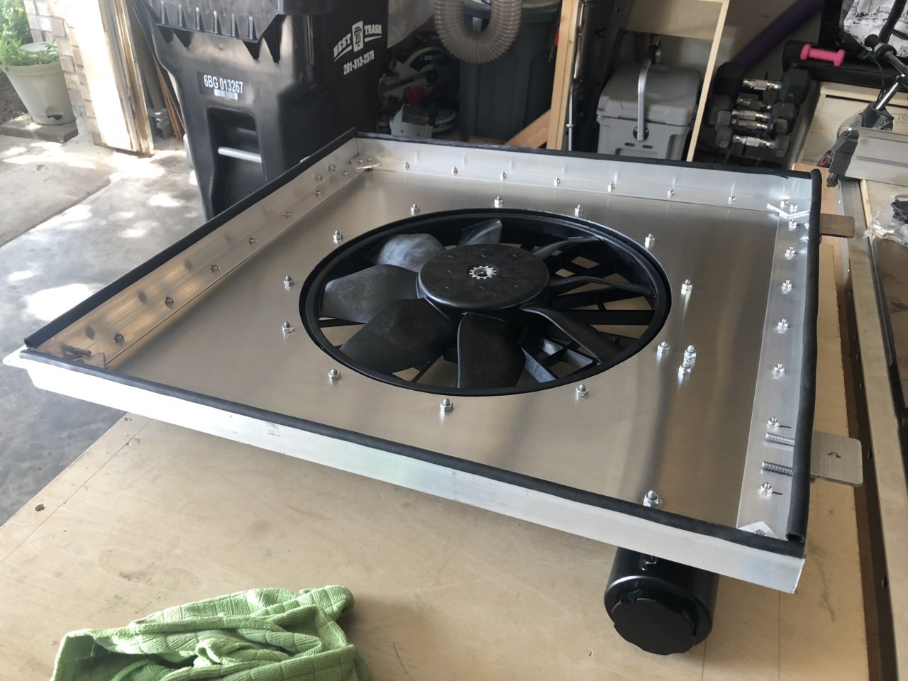

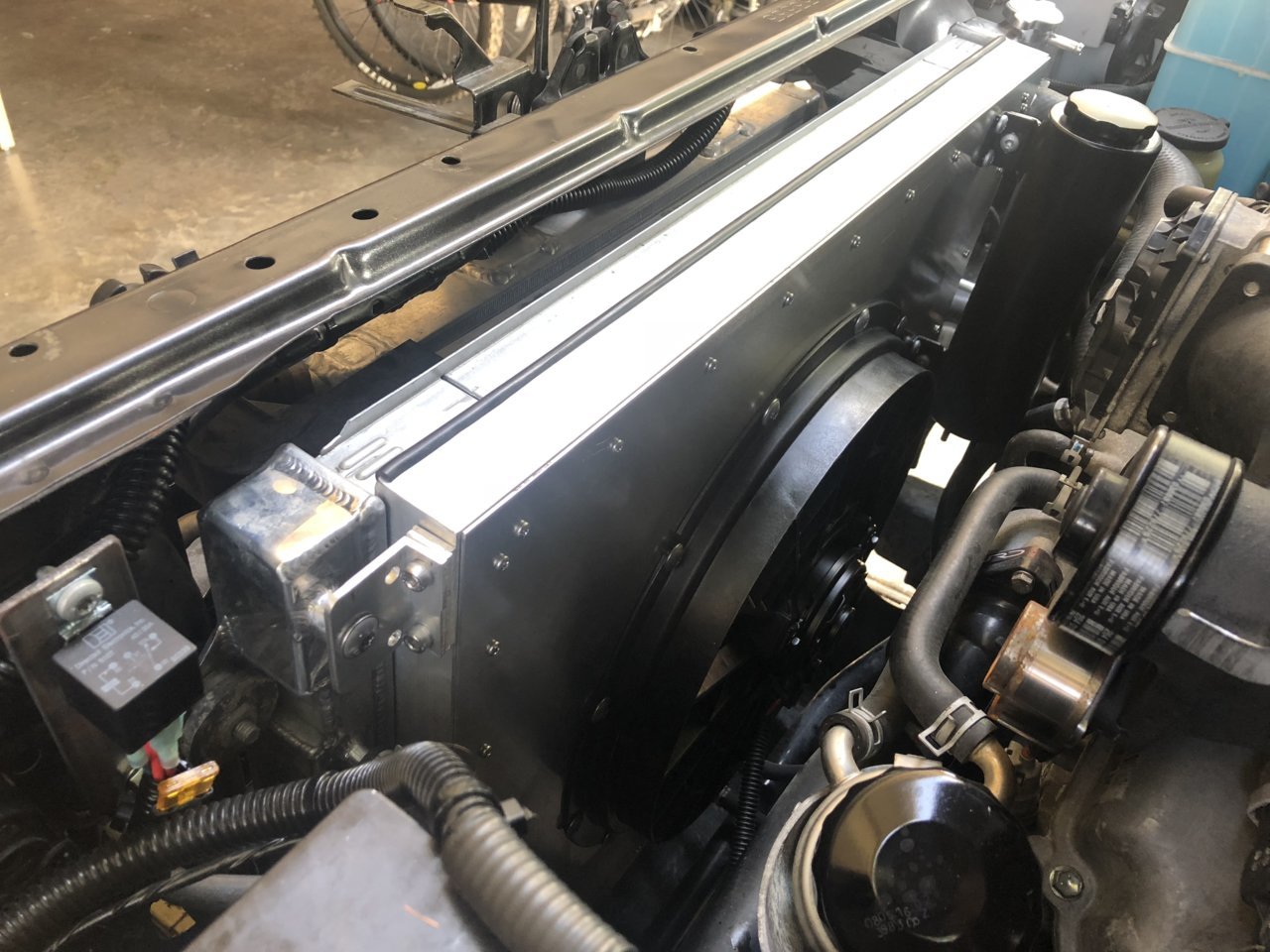

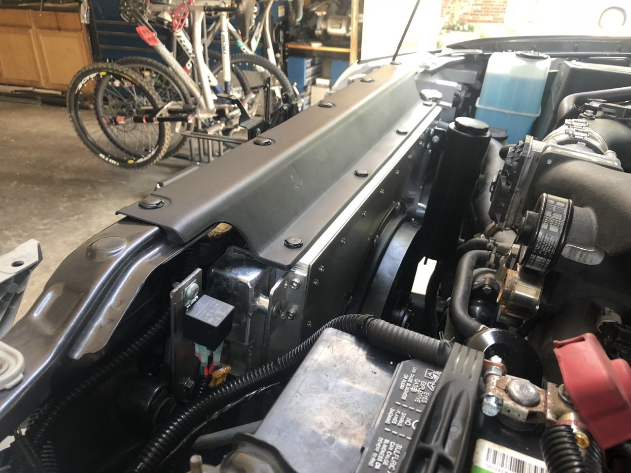

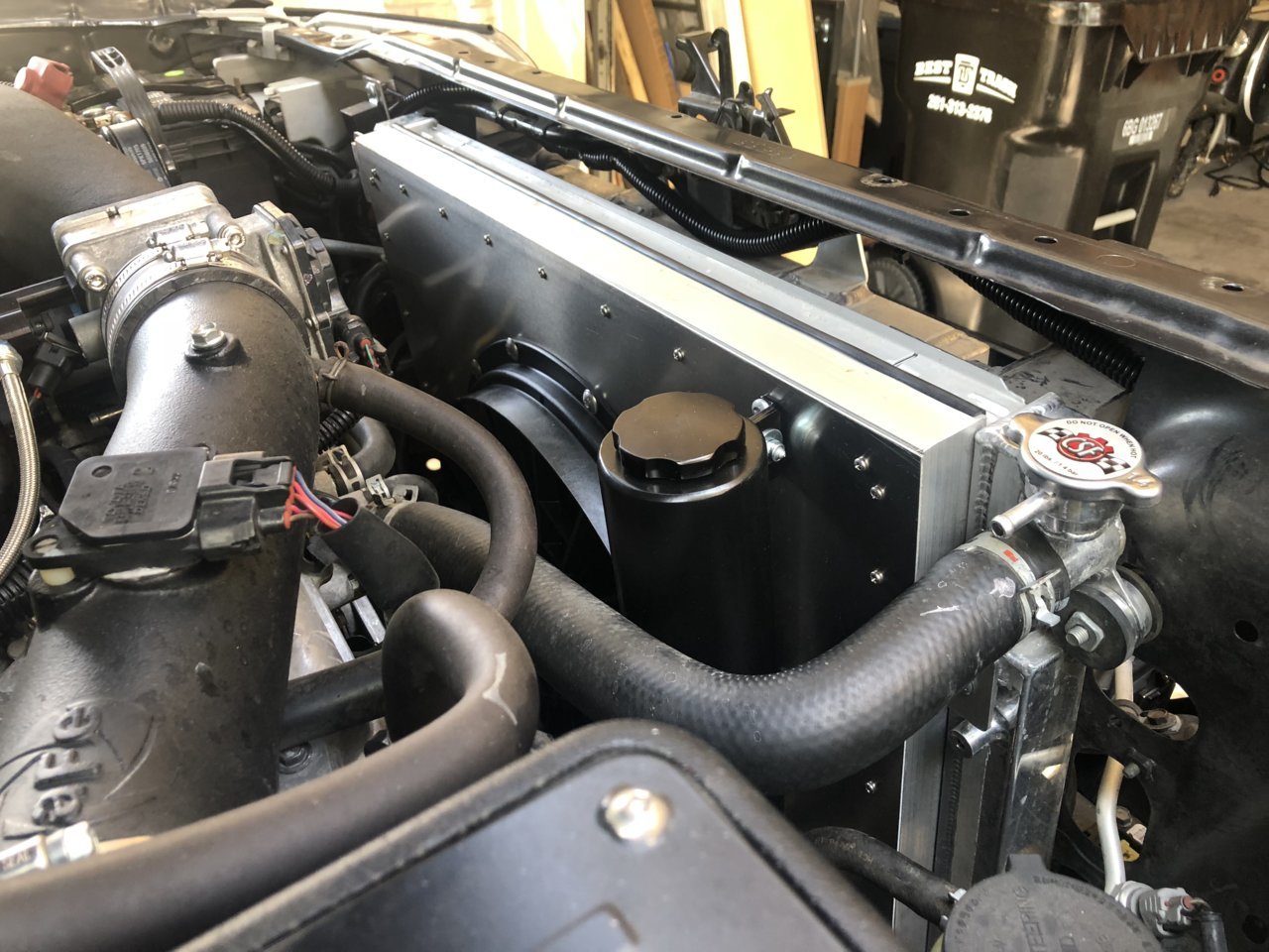

    Made a slit along some vacuum hose and made a gasket for the top and bottom.
    Experimented with a gasket on the sides too, but the shroud is such a close fit along the sides, that I couldn’t get it on with the rubber on the sides. Being that it’s such a flush fit in the sides, I don’t think a gasket would make a difference anyway. If I made the shroud again, I’d make it 0.25” slimmer in width to account for some vacuum hose in the sides too.
    Pics of it mounted up.
    2B07A682-F8BD-41A4-B256-8708A89C39F2.jpg E2935C4C-93C4-4141-AE1B-36FA924E9A30.jpg
    Still a couple of inches clearance.

    Gosh damn that's sexy!!! Dont forget to put a couple washers on the water pump studs or the bolts will bottom out without tightening the pulley.

    I did add a couple washers on each stud of the pump. That was the first thing I did.

    Drilled some more holes along the top to accommodate the factory plastic trim thingy.
