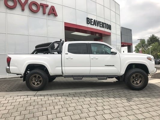

    Here is my trade in, now sitting in the "Look at me!" spot on the dealer lot, front and center.

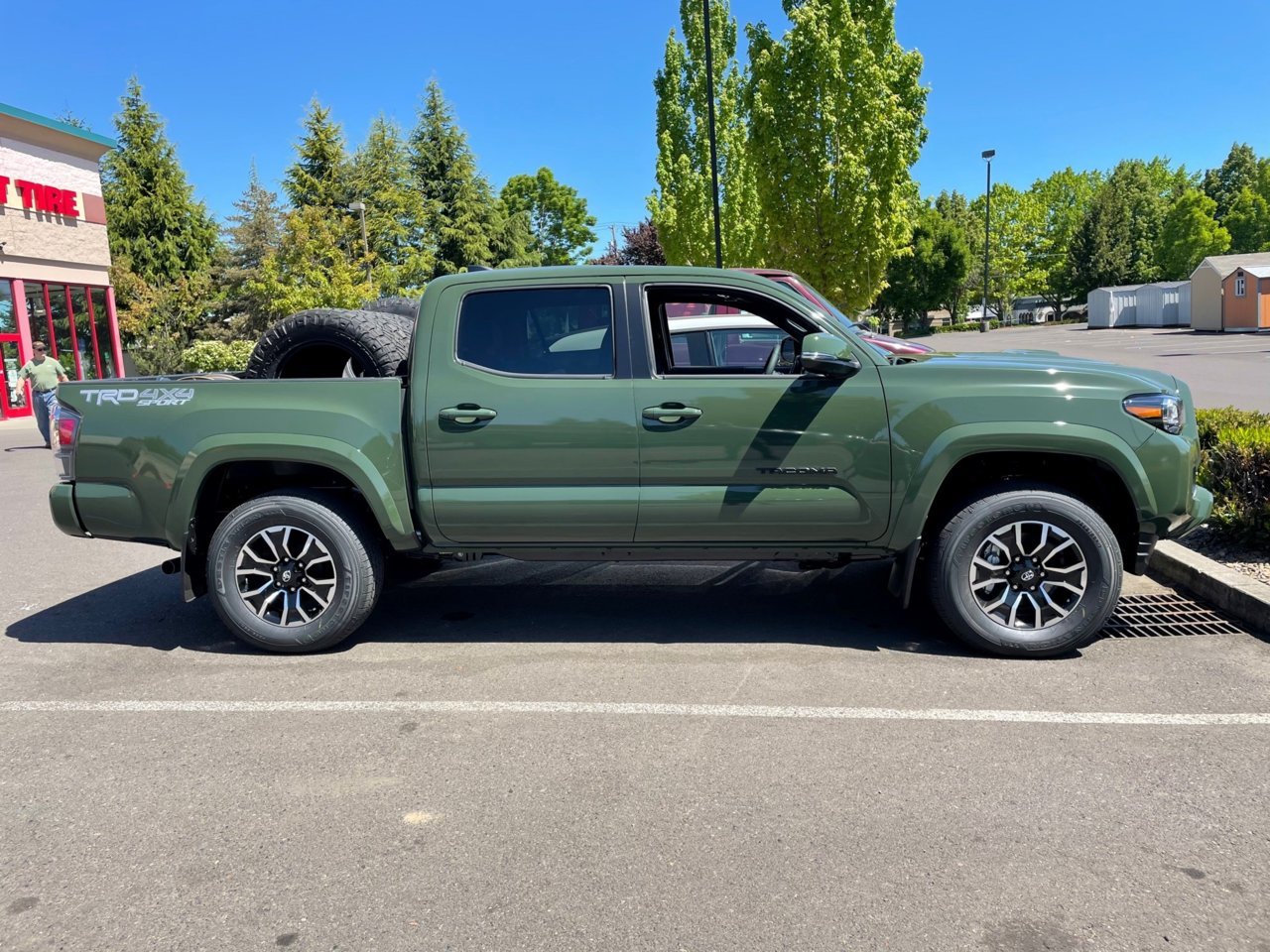

    And here's my new one. 2021 TRD Sport, with all of the add-ons except for the tonneau. Decided to save that money for something i'll actually use, like a shell or rolling cover. Still undecided on the name. It's a toss up between Loki and Master Chief.

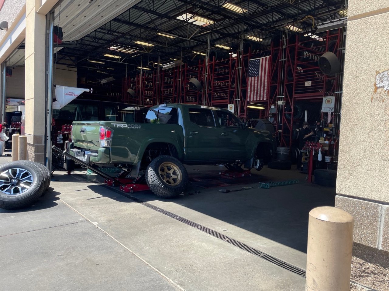

    Drove straight from the dealership to my house to grab my wheels and tires I bought during the 3 week wait, then over to Discount Tire. Total mileage on stock wheels and tires: 7 miles.

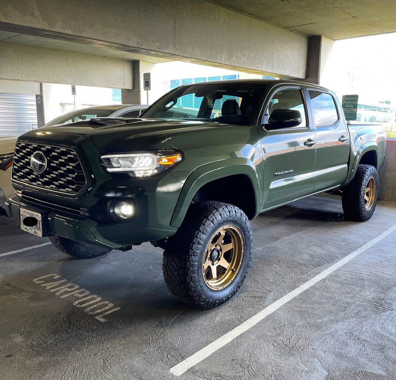

    Went with the same wheels I had on my trade-in. I thought this would be the perfect time to see whats out there and make a new selection, but I kept coming back to the Fuel Shok wheels. Only this time around I went with 18x9 -12, instead of the 17x9 +1. Wrapped in Nitto Ridge Grapplers 285/65/18. Quite a bit of rubbing on both sides when the wheel turned more than about 40%, all plastic. 5 minutes with a dremel and a saw blade attachment and no more rubbing. Now to wait while my lift parts are delivered from Amazon.

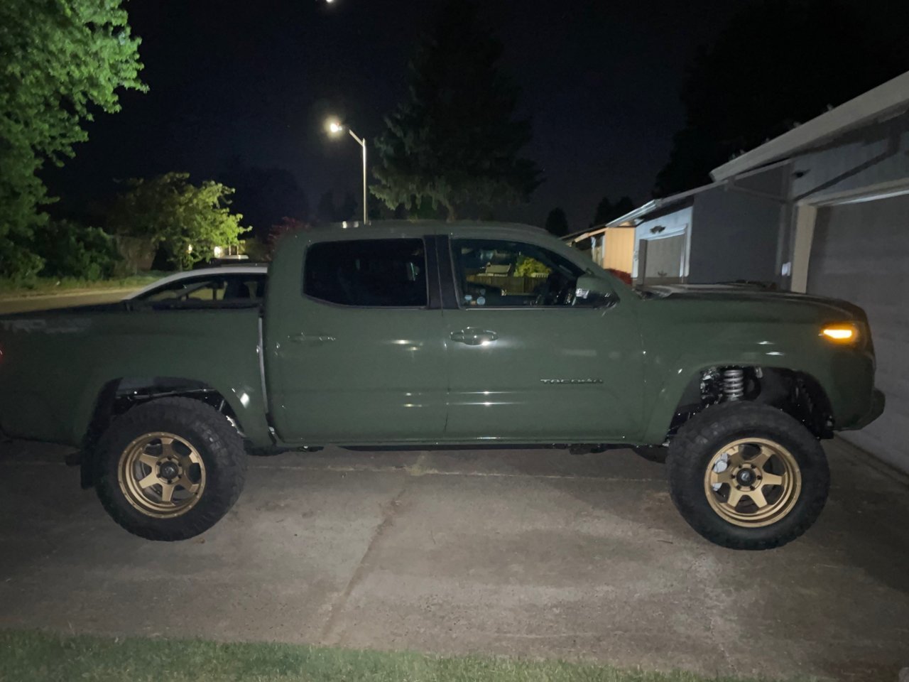

    Got the front end done right as I lost daylight. Sweet, should be able to drive it to work tomorrow morning like this......
    ....Maybe not lol. Got in and couldnt see over the hood. Gonna have to take the wife's Crosstrek for the day and knock out the rear that night.

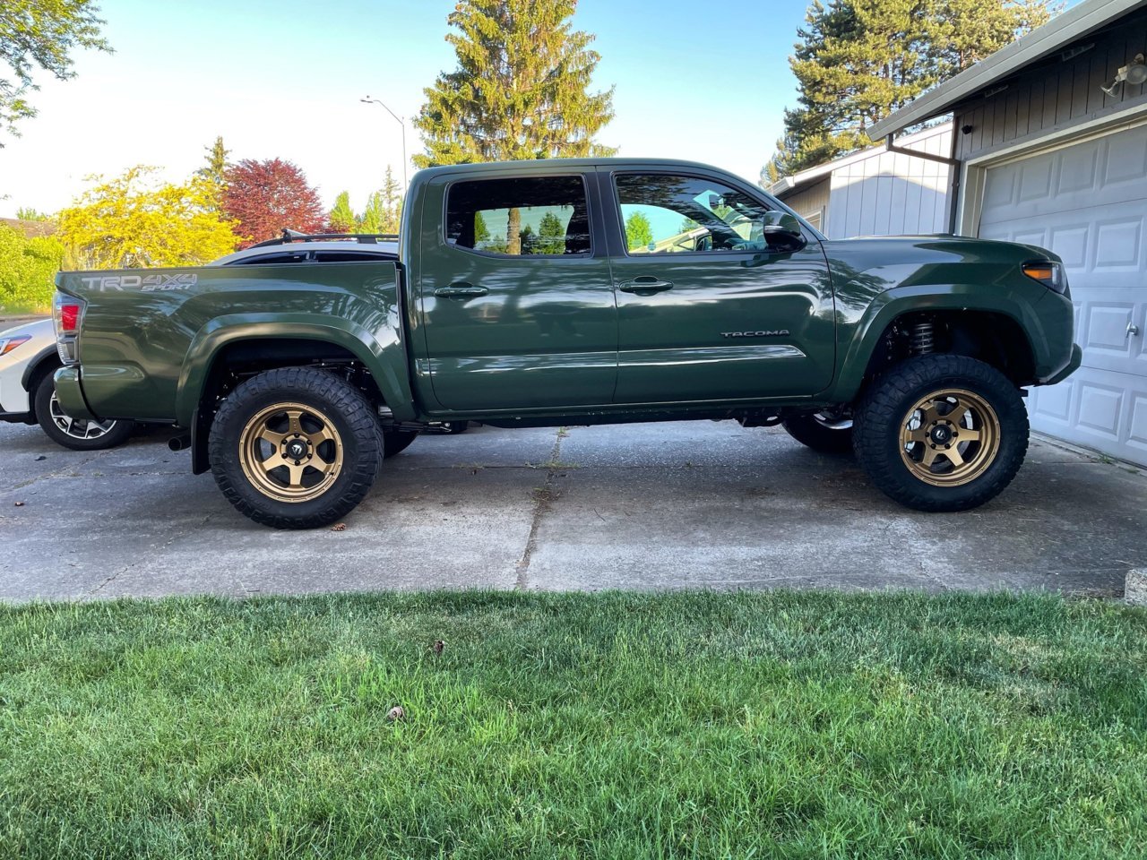

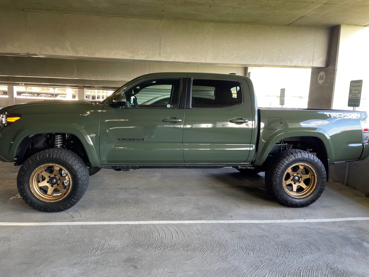

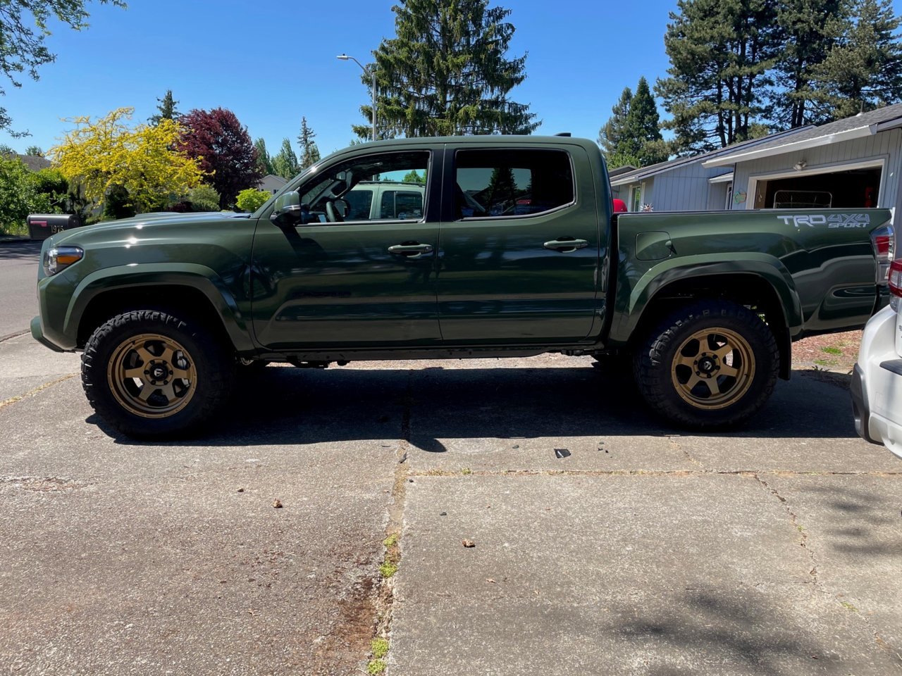

    Here it is in its full glory. On flat ground, the front end sits 1/4" higher than the rear at the fender. I may drop it down to the bottom notch from the current position at the second.

    I really like the look of 18’s. The gold looks well with the green too.
