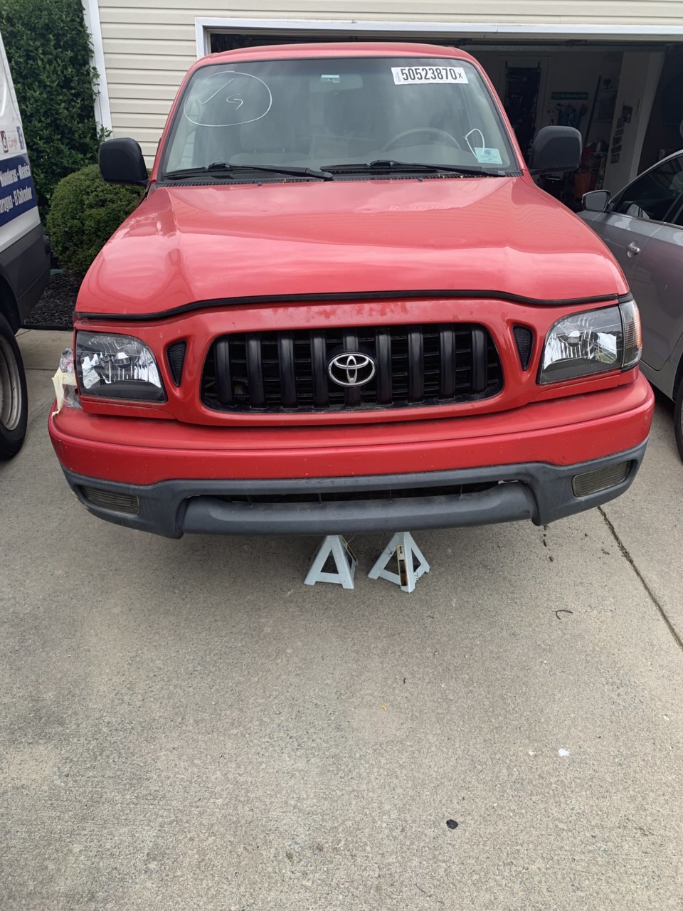

    What’s up everyone
    I purchased my tacoma a few months back from the auction after only seeing it in pictures. After I got it brought to my house I realized I made a BIG mistake I should have went to go see it in person. The frame was bent on the passenger side behind the suspension.
    Took it to a bunch of shops to see if it could be fixed everyone said no and that it needed a new frame. I picked a shop from the quotes I was given and dropped it off there for about two months. They gave me the run around as to why they hadn’t start yet blah blah blah. Finally I gave up on them and went to pick her up.

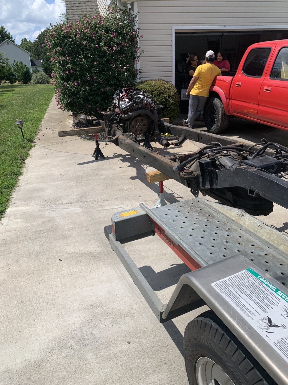

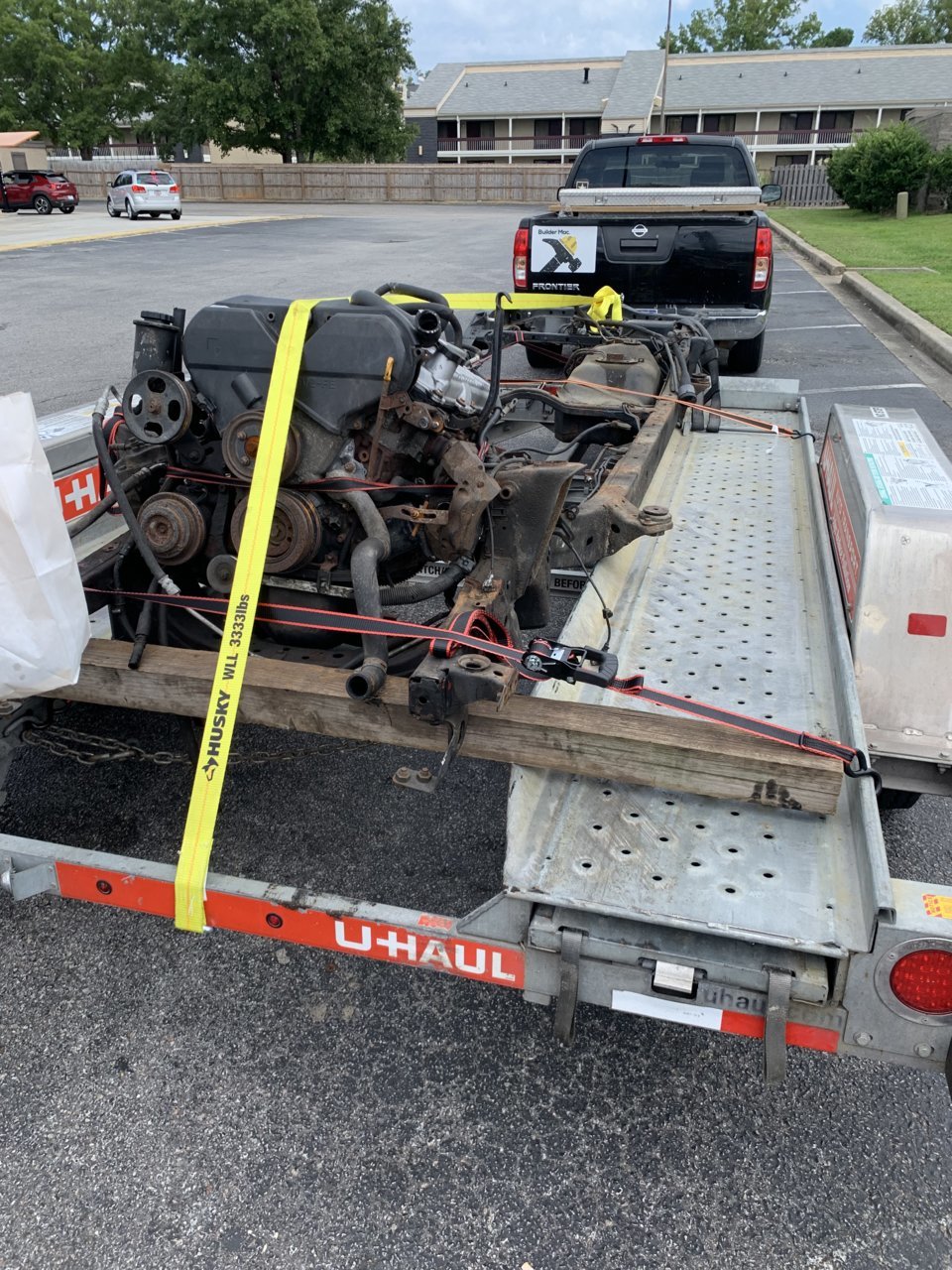

    Then about one and half month later and 20 plus hours of driving to see frames from Facebook and Craigslist.
    I was able to pick up a frame from someone in this forum. This is my first frame swap if you have any tips.Please feel free to comment below.
    The plan is to finish striping it down and prep it for coating this week.

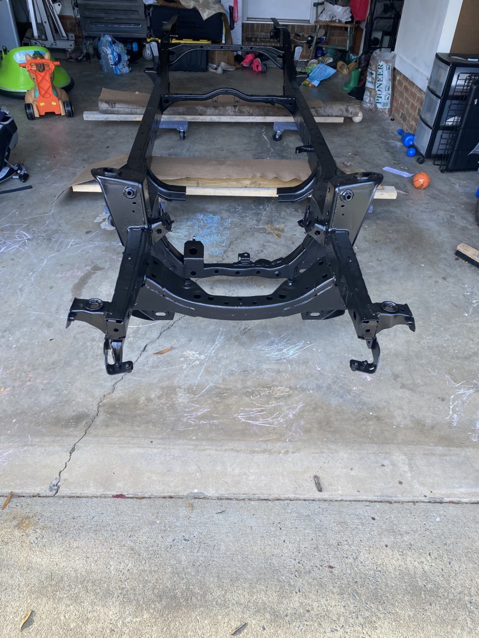

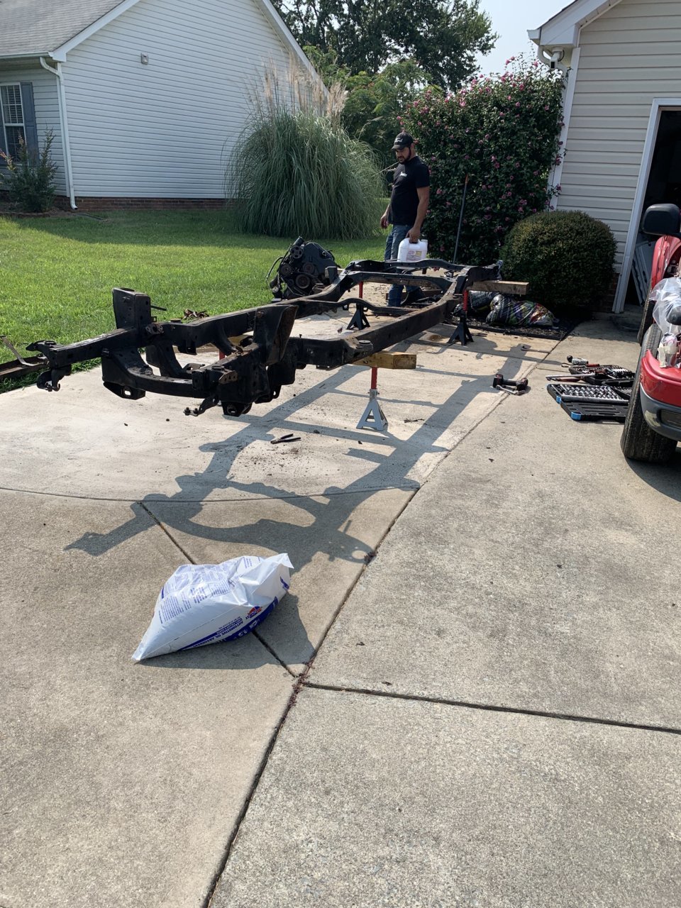

    I got the frame back from the powder coating shop.

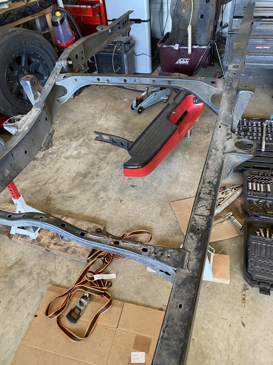

    Today I finally got around to disconnect everything I think lol. I will know for sure once I try to lift the cab.

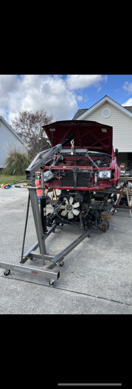

    Update:

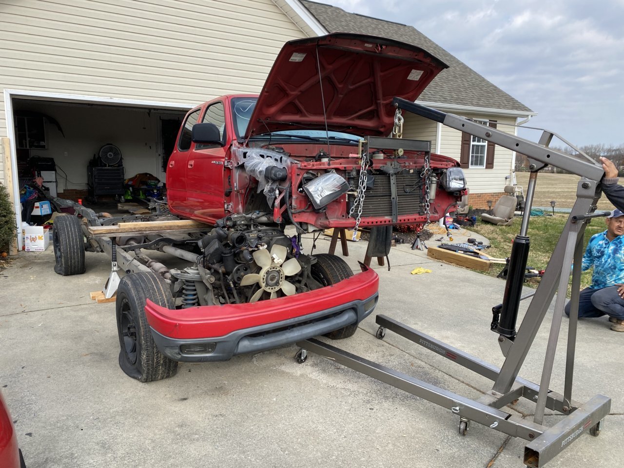

    got the cab off. Does anyone have suggestions for the complete front end suspension?
    From what I was reading ES master bushing kit doesn’t fit double cabs can anyone confirm? Specifically the cab Mount bushings.

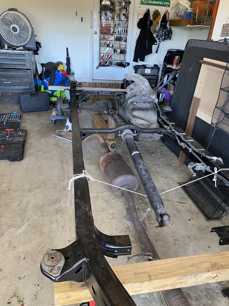

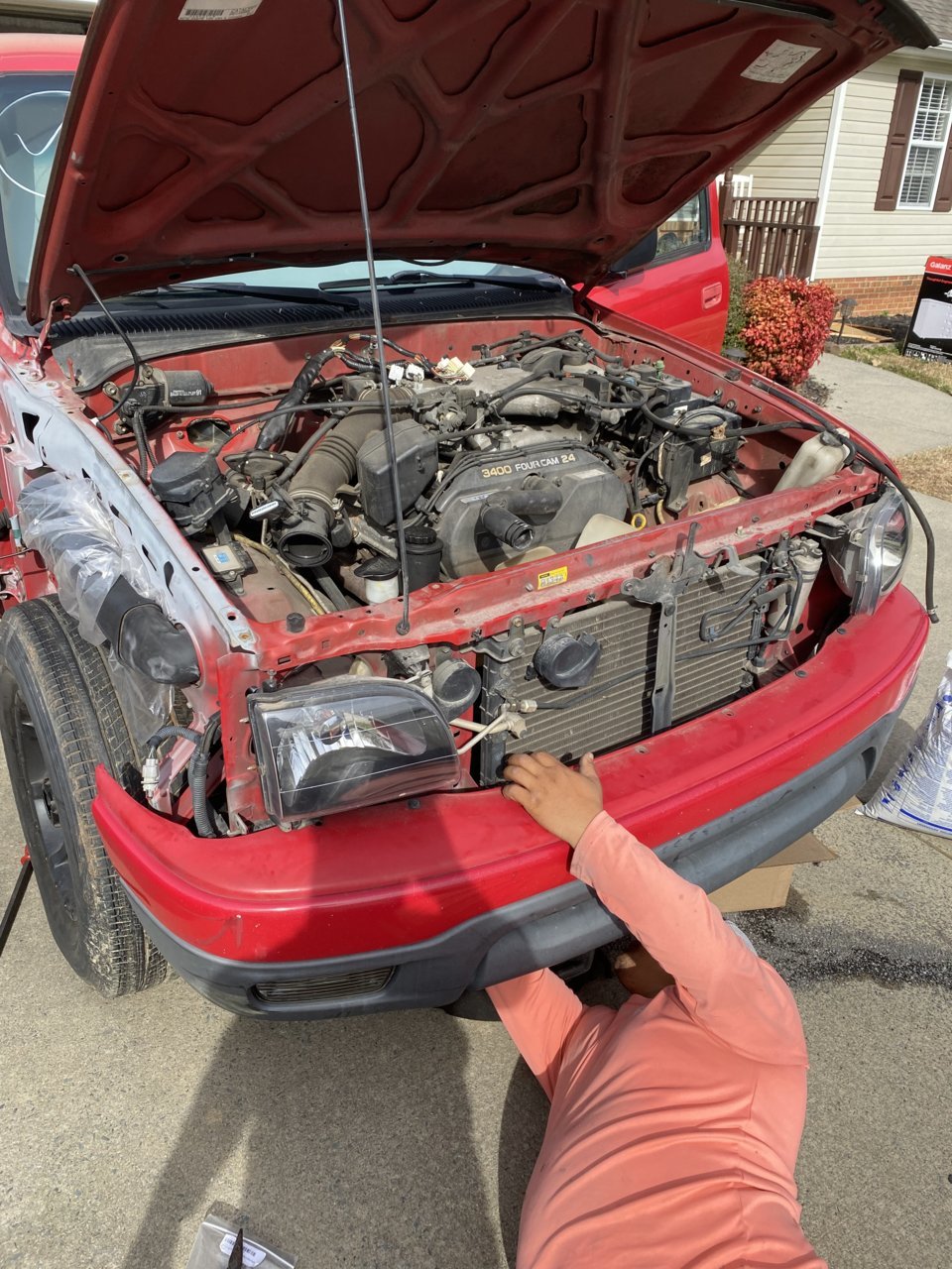

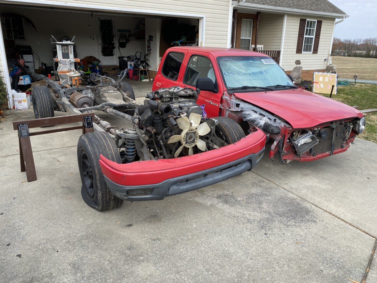

    Update
    It’s been a slow process between work and daddy duty but here is my progress. Don’t mind the mess.

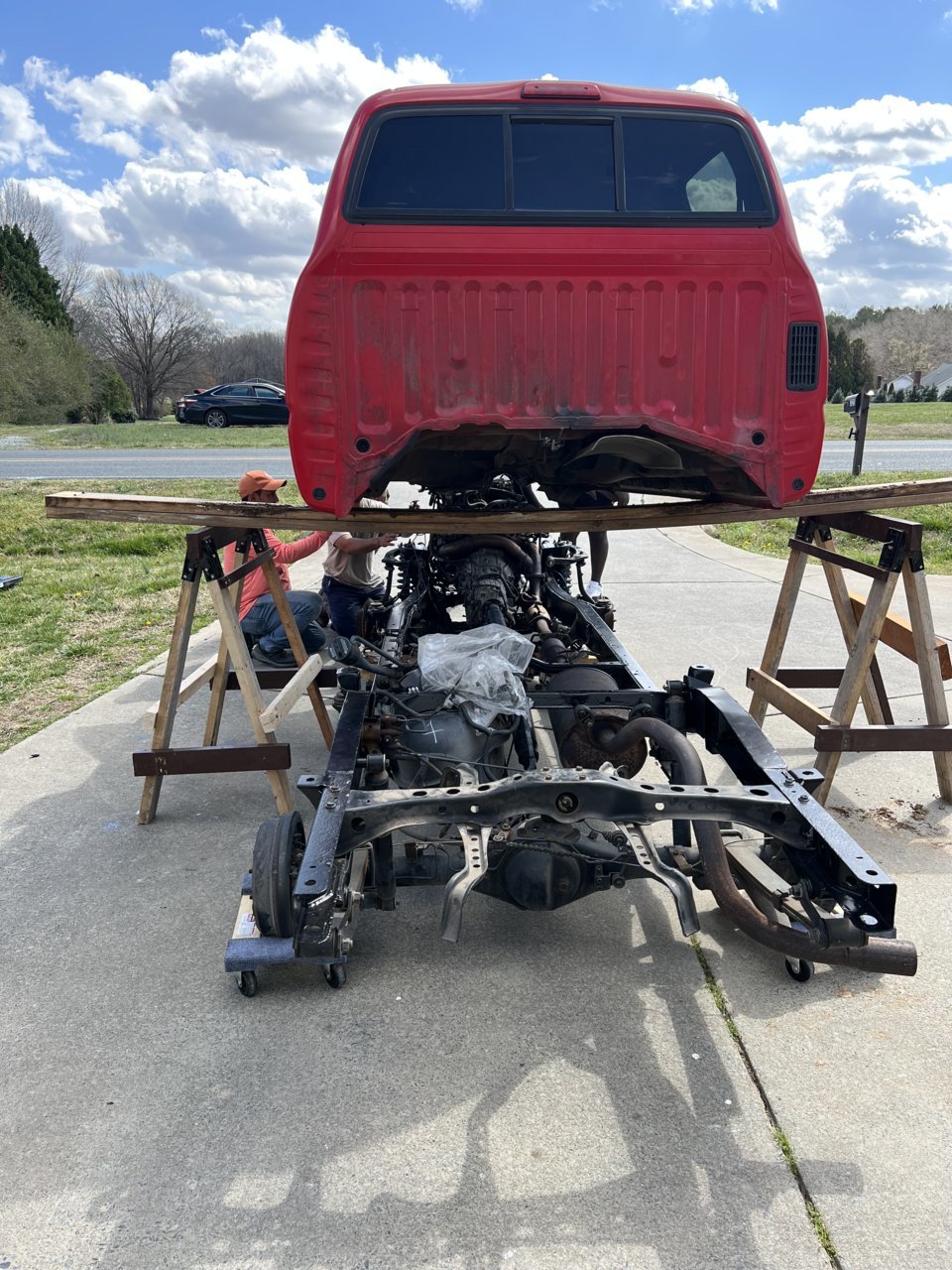

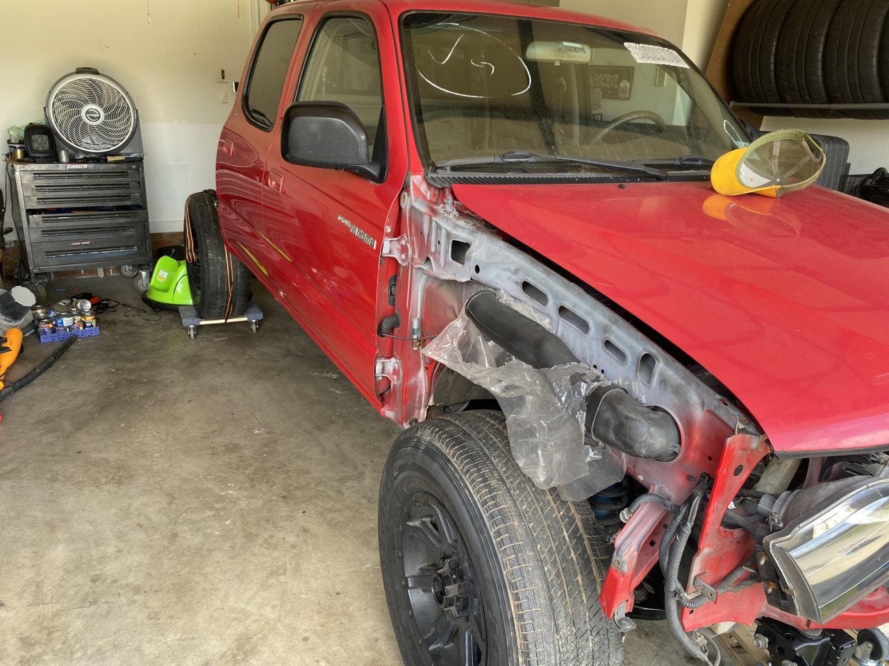

    Finally got the cab on.

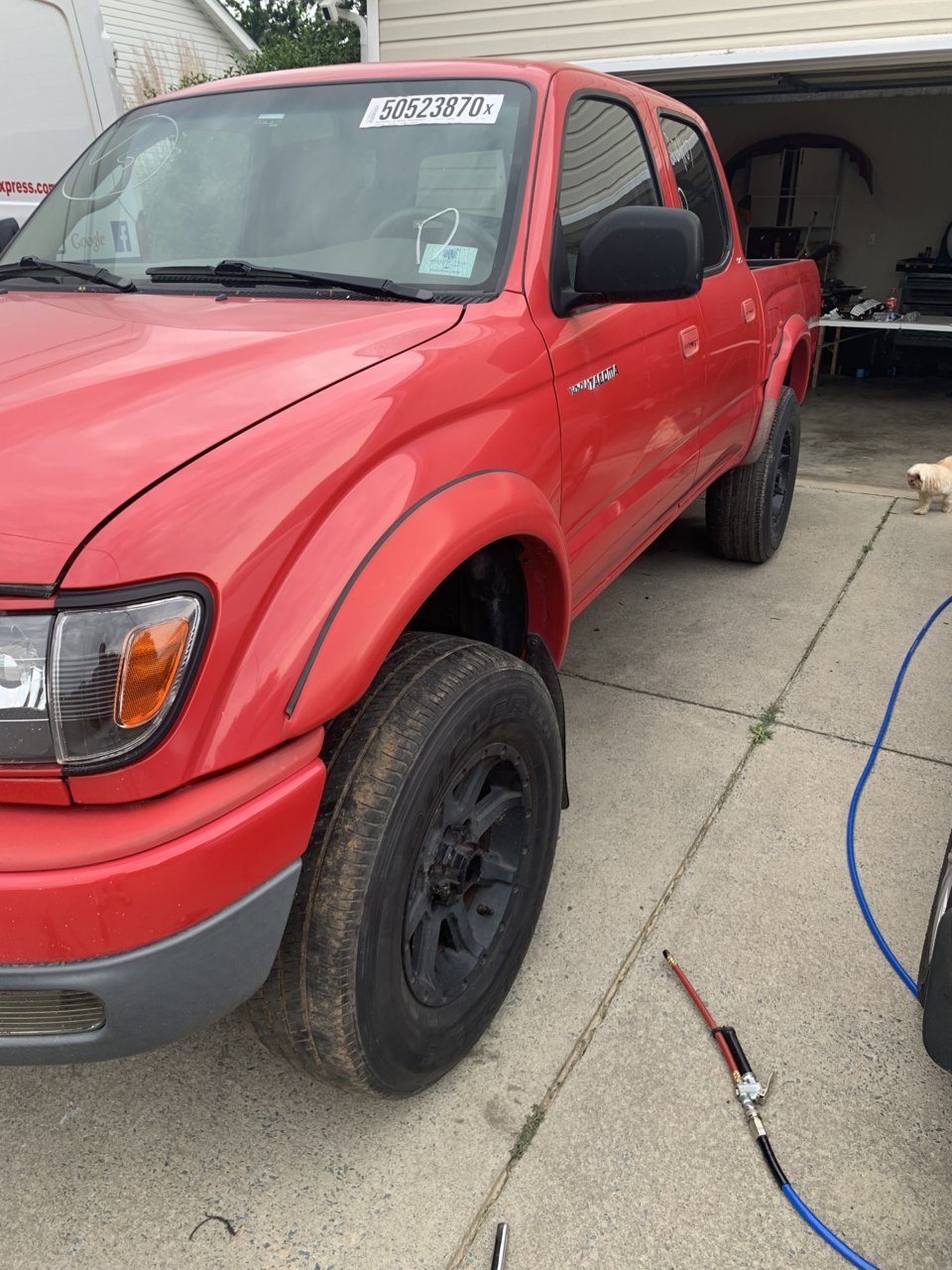

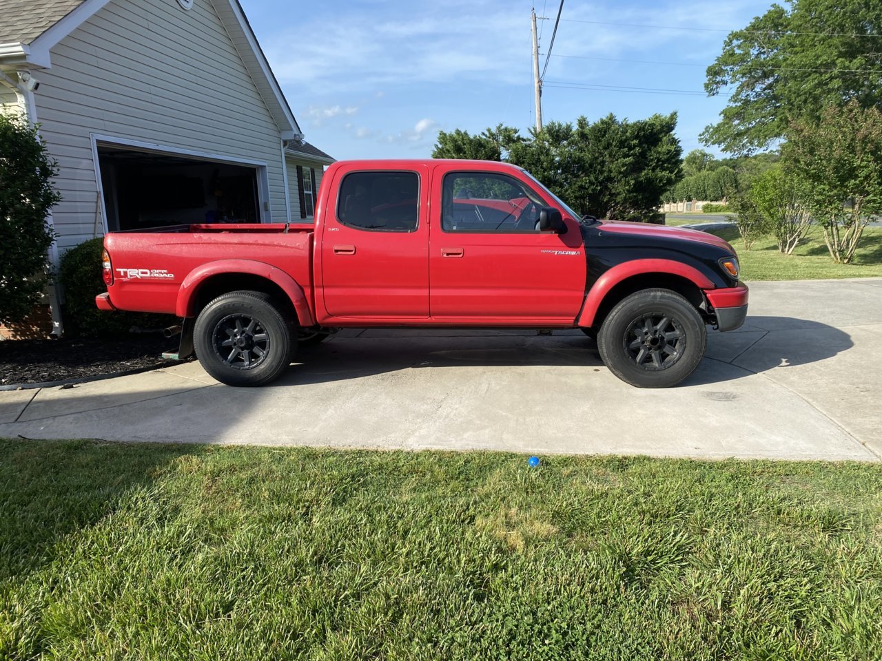

    She is almost ready. Just waiting on tires so I can take her through inspection.
