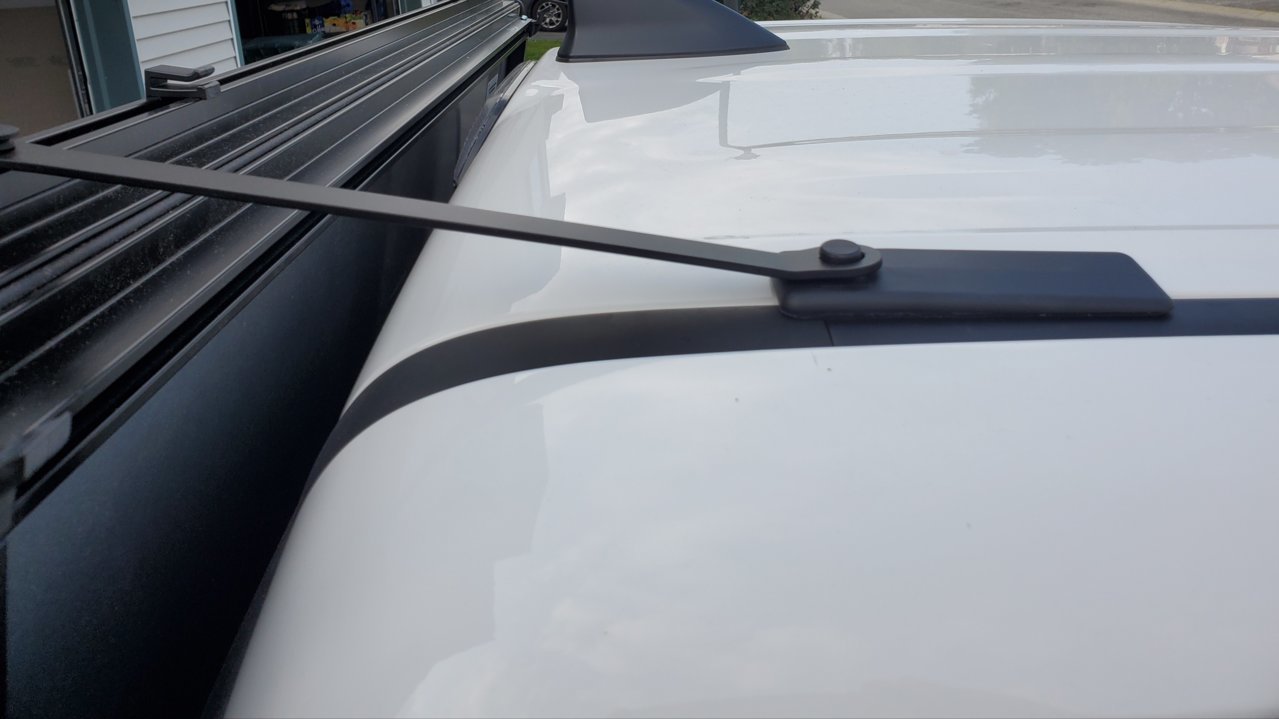

    I noticed that the piece on the top of your truck is part on the metal and part over the rubber strip covering the roof rack slot. Is that piece too wide to fit just on the metal in that section? If so, can it safely be placed inside that raised metal ridge instead of outside of it so that it's fully attached to the metal surface?

    You can place it inside the raised corrugation on the roof. The stabilizer bars will have a slight pigeon toe to them i.e. be angled in, but it shouldn't affect anything. Personally I just like this placement and I don't plan on getting a roof rack. I actually considered attaching directly to the black moulding only but wasn't sure how secure that is to the truck.

    Considering the black strip on mine likes to come loose near the back occasionally, I would recommend not attaching something load bearing directly to that strip. Between the adhesive and the magnets, where you have it should hold ok. At first glance it just looked like it was hanging there.
    I'd almost be tempted to try to spray that piece in Blazing Blue to match my truck before mounting it. That way it would blend in more.

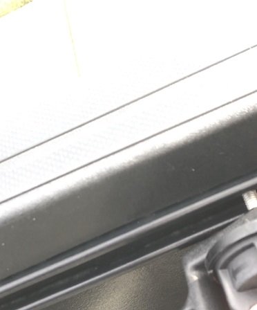

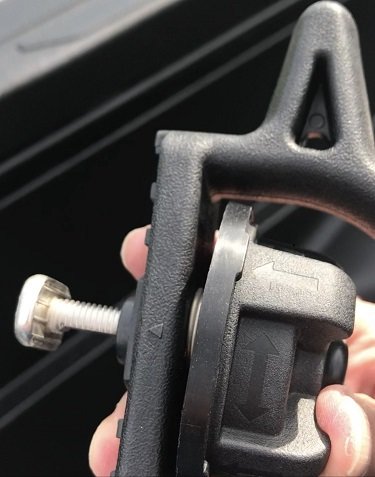

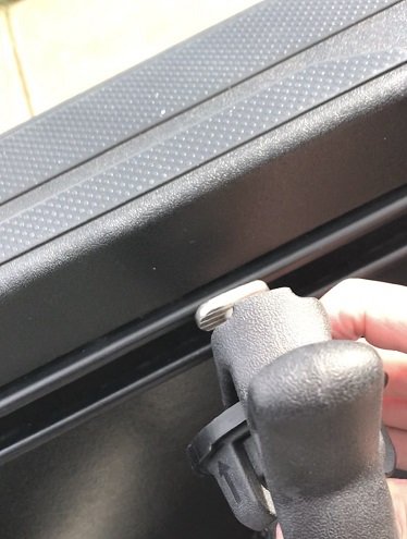

    Hey Mike,
    I did some testing to ensure I could install my cleats after I install a cover such as the Lomax that I'm considering getting (or other hard fold with rails). From my testing it's very possible, in fact easy in my opinion.
    First loosen the knob CCW as far as you can to allow you to push the knob and extend the screw/lock mechanism as far out as you can:
    Then angle the latch in longways into the slot:
    Then rotate the cleat hook sides horizontally thus rotating the latch in the rail vertically, as you normally would have them, and tighten the knob:
    Now one thing I don't like about the Lomax is the hard fold cover rails you install appear to be very wide (losing over 2 inches bed width at the rail elevation from what I've read). This leaves in question how much clearance you have with the cleat hook in the vertical orientation in the beginning. But it's still quite doable, worst case you simply take the screw/latch totally out of the knob, install as above, orient the latch vertically, then reinstall the knob mechanism. I did that test as well, all very easy.

    I found that you could use the cleat in horizontal orientation one the bed rails are on. There doesn't seem like there's enough room to use them vertical. The rail does make the top of the bed more narrow. I think that is something you might likely see with all the low profile covers. Still it's cool that you experiment with ways to get the cleats in. I didn't do that and frankly didn't think about it. It's my first truck so I'm still figuring out how I'm going to use the bed and secure stuff.
