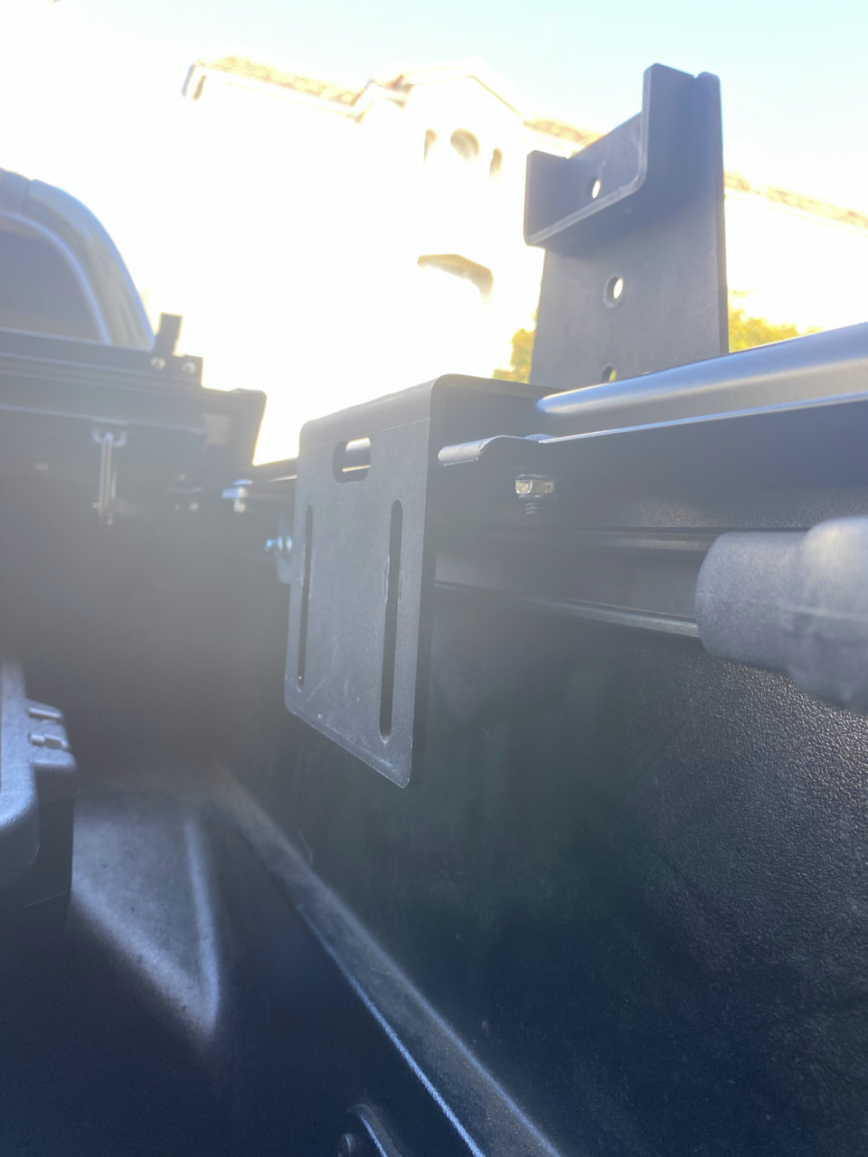

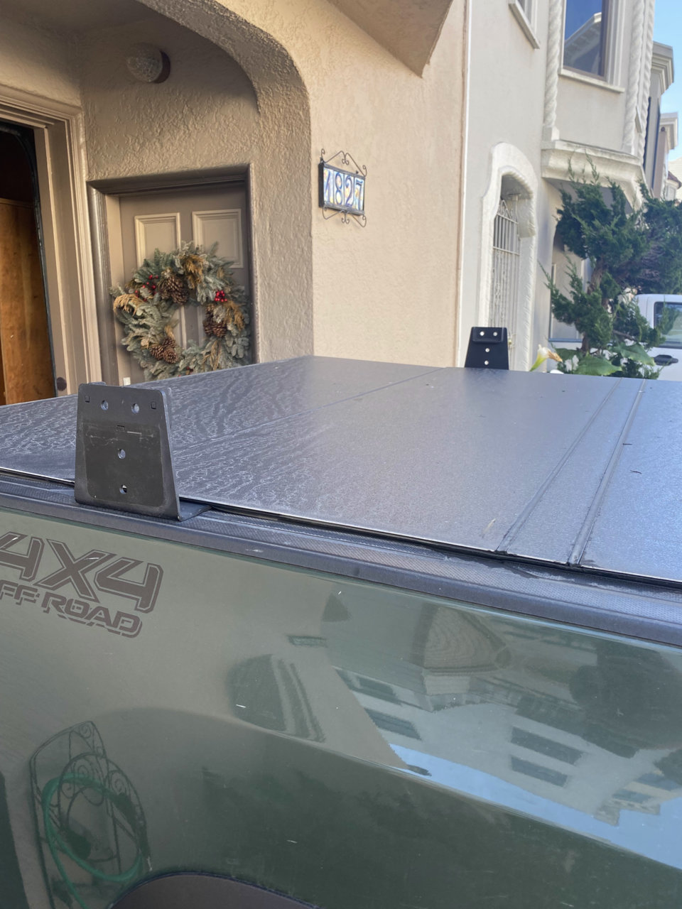

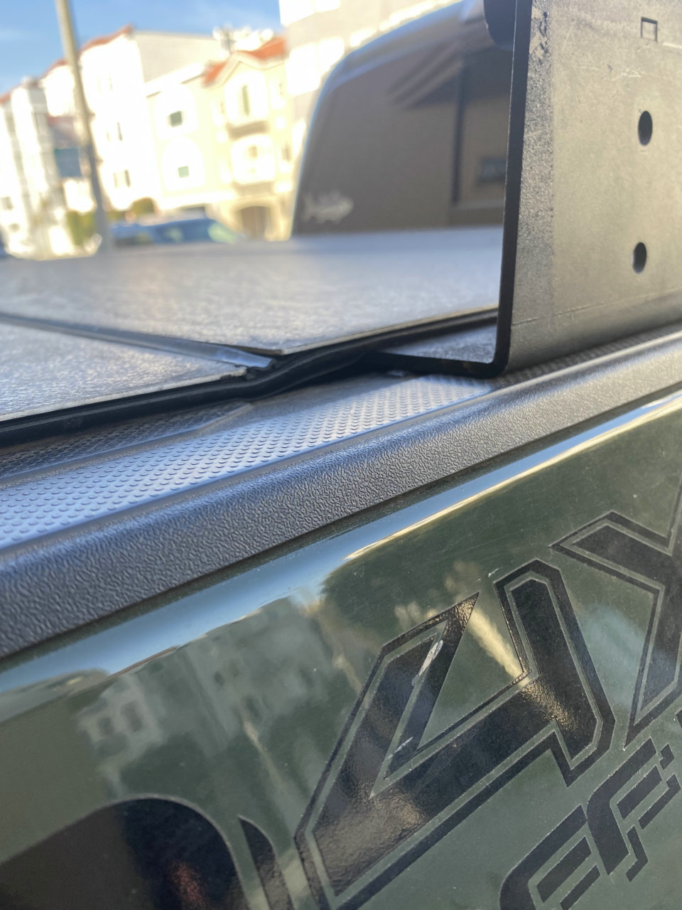

    So I bought the lomax a while ago and have been trying to find a set of bed rails that can sit on top of the lomax without cutting anything. I got a set of brackets from @BillieBars and tested to see if they will sit over top of the lomax rails and on the side of the bed. As you can see from the pictures, it sits fine and the lomax closes fine on top of it. Maybe just a small gap in the weather stripping.
    The only other modification you will need is youll have to get a spacer that fits between the bottom of the bracket, and the bedside rails (see last picture).
    The length of the actual billie bar will need to be cut (i think if you tell them they will cut it) to 61.5 inches. I didnt go through with it because I am undecided if i want to do this or an RSI. Post pictures if anyone ever does this!

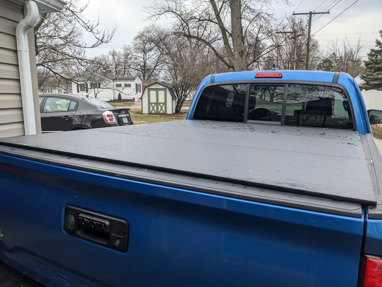

    I was able to install the tonneau cover a couple days ago and I'm very pleased with it!
