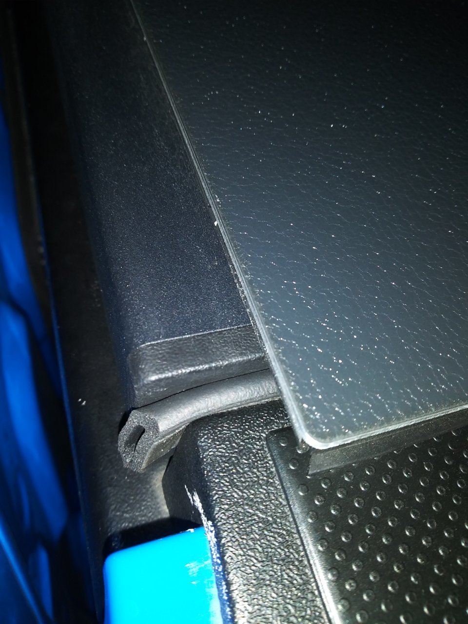

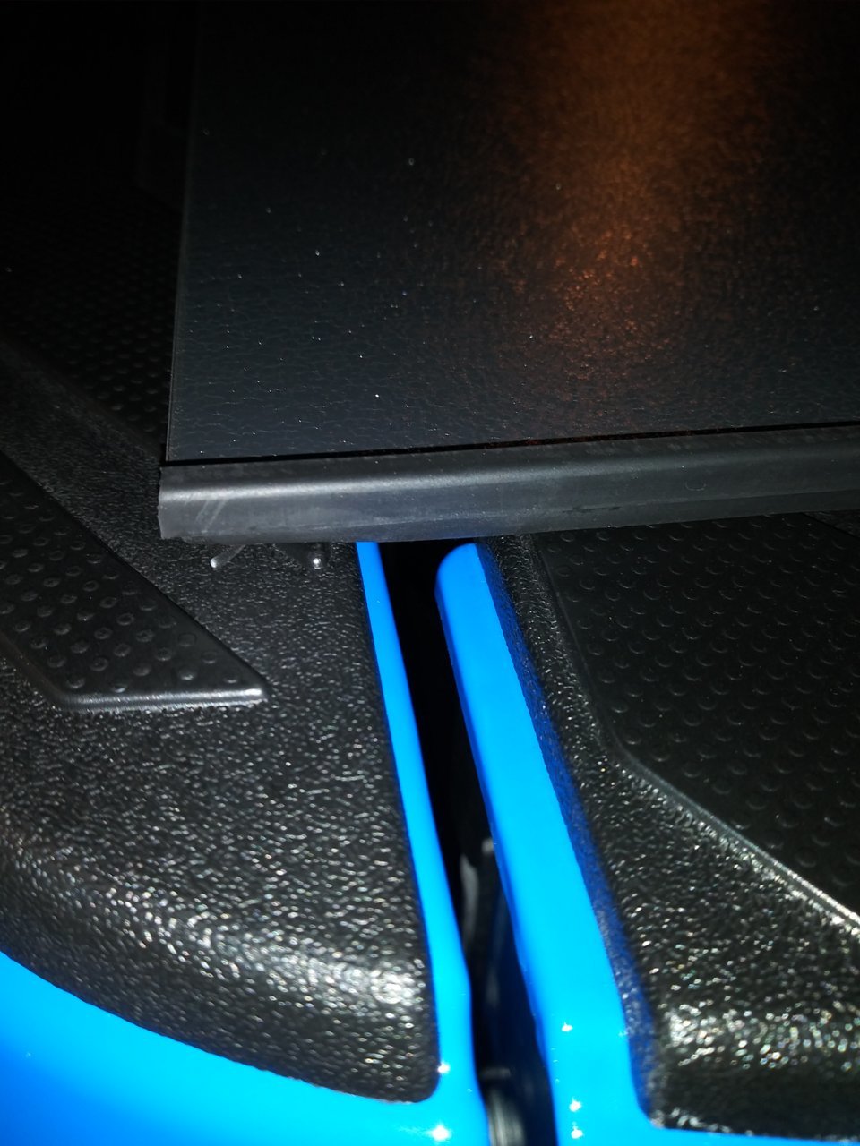

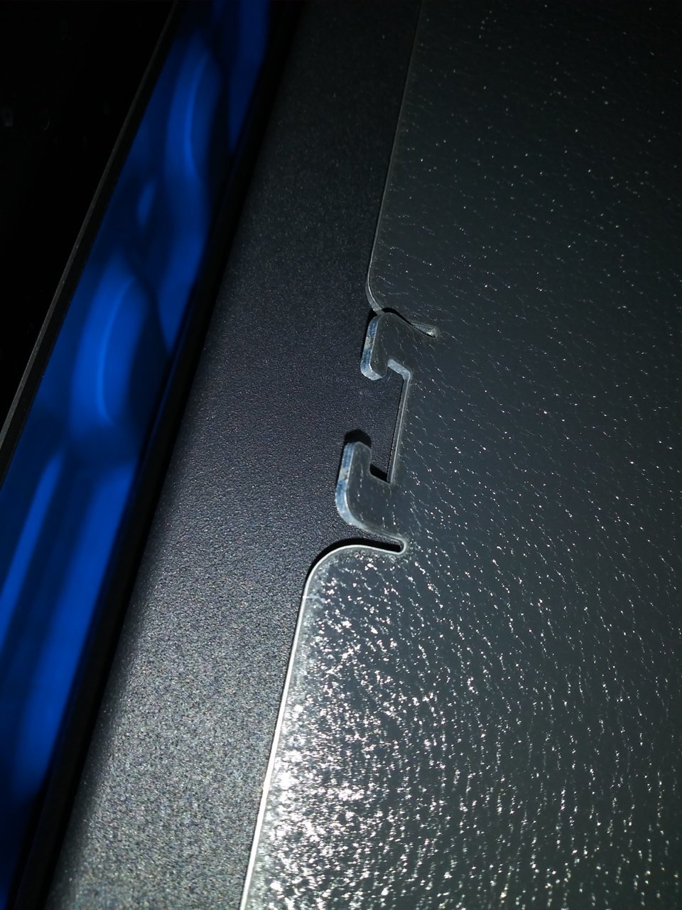

    Since installing the cover two weeks ago, I ecperienced 20 minutes in a heavy rainstorm at 45 mph, and washed the truck today to report that I had some water in the bed. It was fairly minimal. I believe that I narrowed down the entry points. While the cover is sealed tight along rails, bulk-head, and tailgate, there are gaps that aren't sealed. I can't say that the cover is to blame. I am planning to seal these compromised areas with some of the leftover seal strip and a gate seal. Here are the gaps that I see.
    TAILGATE, BULK-HEAD at tiedown notches, BULK-HEAD at side rails.

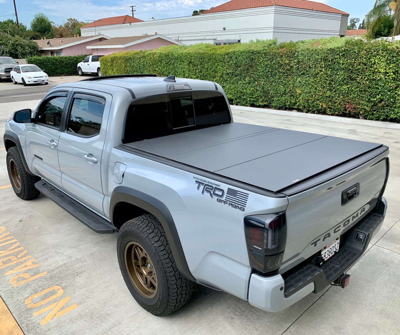

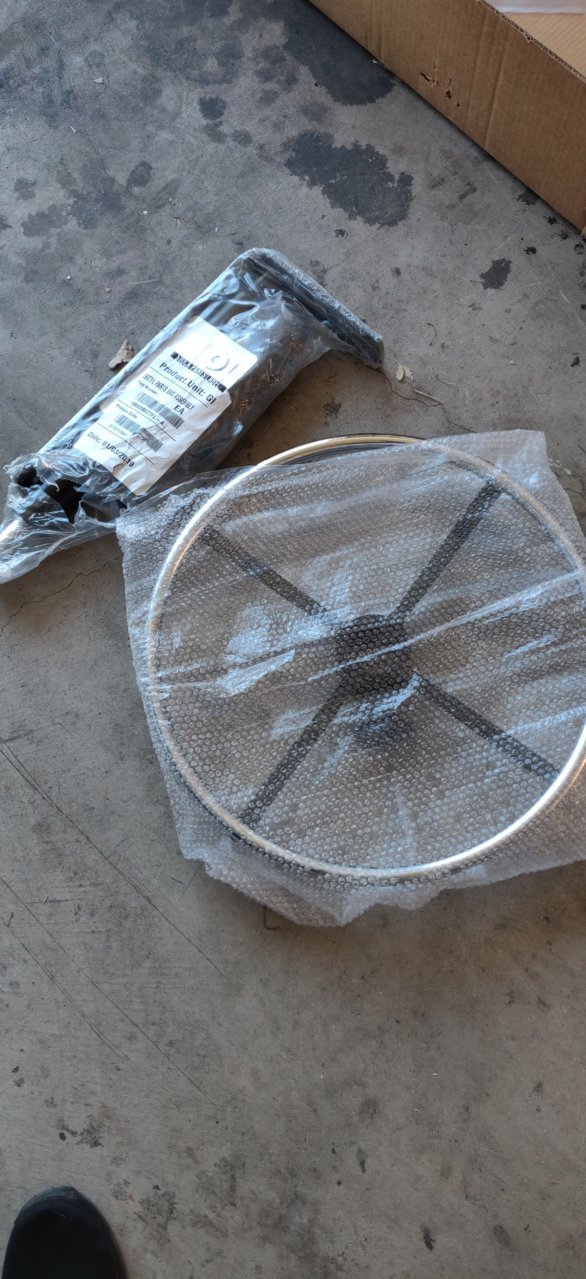

    Anybody else get a "drafting stool" inside the box of their cover. So random lol
