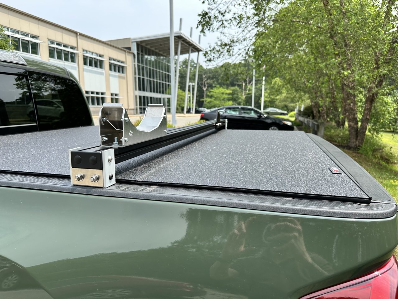

    Did you get this mounted up? Would love to see a finished pic with he cover down. Is that bracket going over the Lomax rail when you install or under? I am trying figure out which tonneau I want to go with my Voodoo rack.

    This is the “finished” product, still a few tweaks I want to do but the basic design is there, I used .063 Aluminum to bend the bracket but would probably go with .090 if I did it again there is a little flex in it at the moment, will be fine with the Gazelle tent strapped down though.
    The bracket goes over the Lomax rail, to go under I would have to trim the rail and I wasn’t keen on “modifying” a brand new cover like that!

    Nice! Looks really good. I think my rack is 3/16 steel probably wouldn't work the same. Is your first pic of the bracket before the cover was on how the bracket sits with the cover on or did you bend it more?

    that’s how the bracket sits, just an easy 2 90 degree bends, then some spacers between the bed rail and bracket to fill the space
