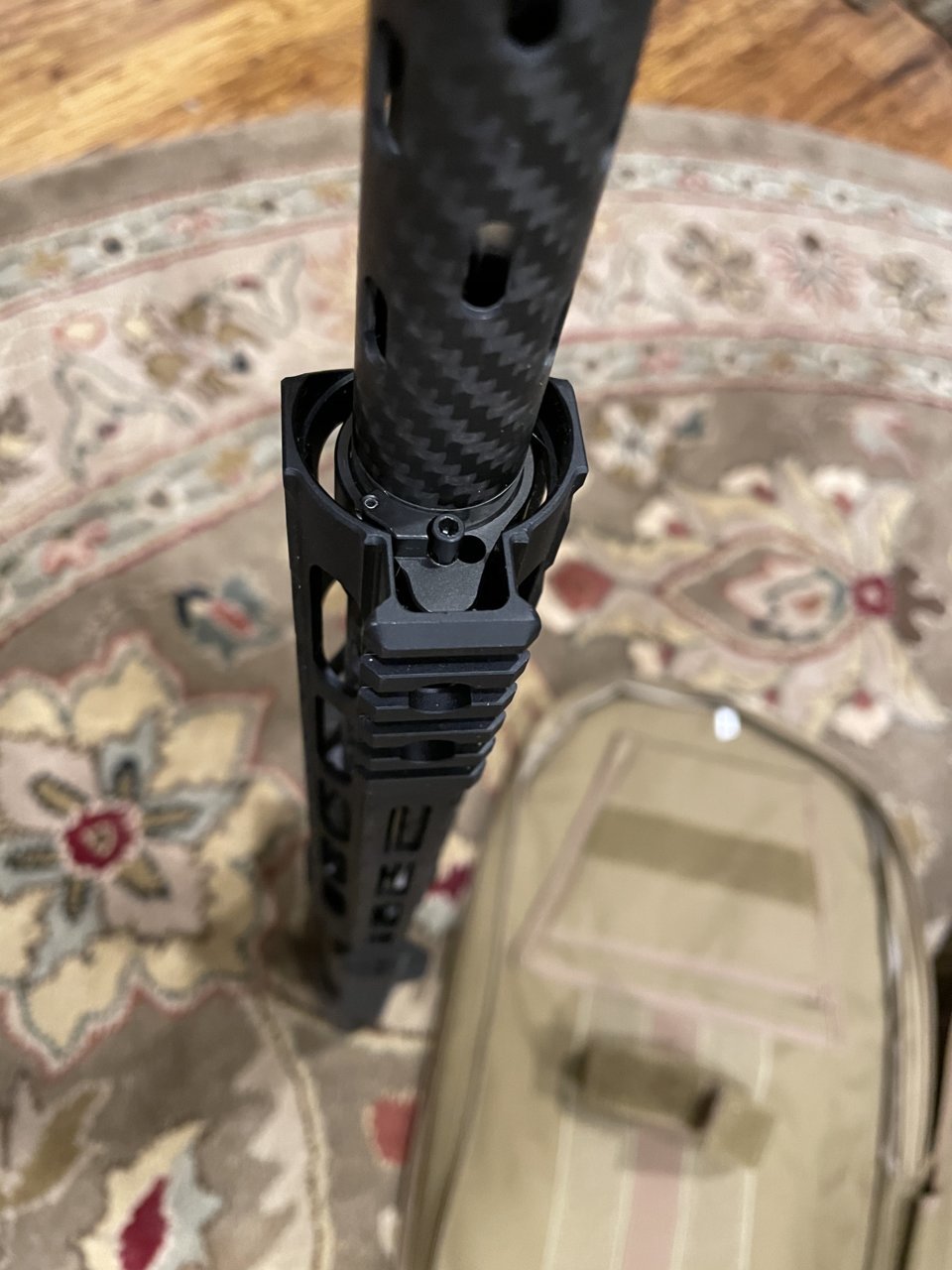

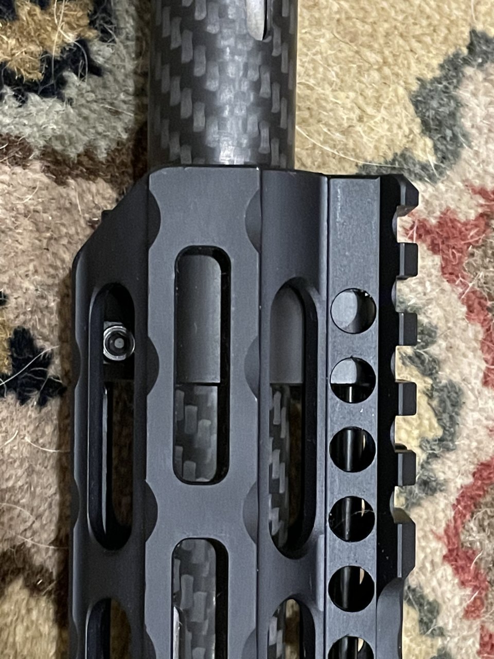

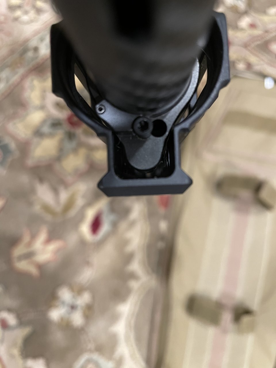

    I shouldn’t have to worry about the dimple; the SA gas block is a compression fit. I was just using it as a reference for the gas port (which I assumed was 180 opposite.... but I need to disassemble and measure as you suggest.
    Here are a few closeups of the clearance. As for whip... I have no reference, though quality cf barrels are supposed to be stiffer than their all steel counterparts.

    That's closer than I would be comfortable with but it may be worth sending the barrel manufacturer an email.

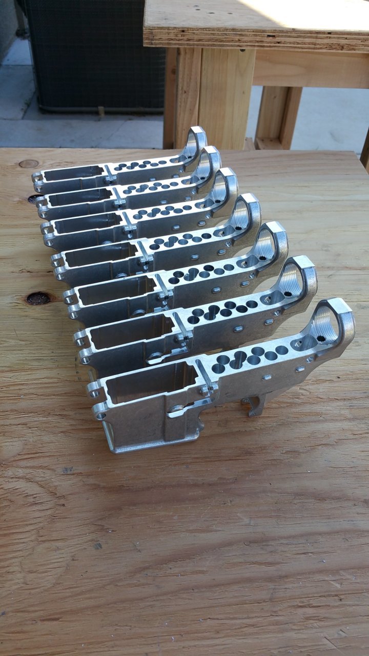

  11. Jan 30, 2021 at 11:20 AM
    #31
    mistrchow
    mistrchow Well-Known Member
    Apr 13, 2015
    #153083
    200
    Somewhere in Nature.
    11 SWB Tacoma TRD OD
    Bone Stock
    Once you get the hang of drilling and using the router its pretty easy but takes a good of amount of time and practice so you don't fucked it up, lol.
    From Nothing to Something. Took them to get Type III Anodize.
