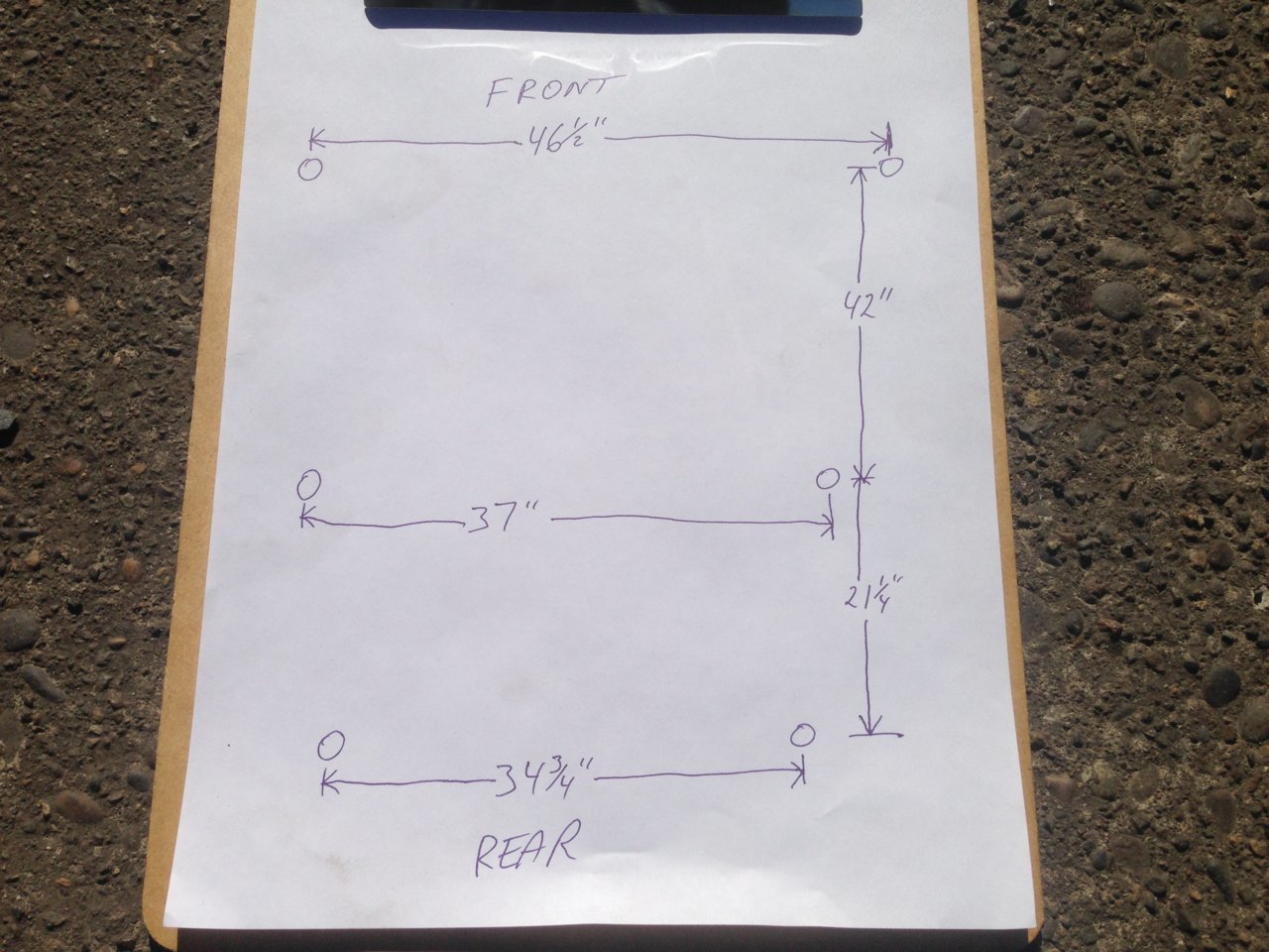

    Any chance one of you long bed owners could give me some dimensions of the bolts mounting the bed to the frame? Just looking for the dimensions from bolt to bolt from left to right and front to back.
    I want to compare them to my short bed. I believe the 4 rear most bolts are in the same location. The front two might be spaced wider side to side and are certainly a greater distance from them to the middle bolts.

    Muddinfun
    Muddinfun Well-Known Member
    Apr 17, 2017
    #216500
    7,489

    Perfect! Thank you very much!
